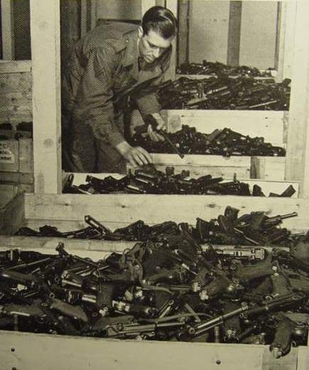

A returning GI would rather say he took his Luger off a prisoner or dead soldier, than picked it out a pile like this.

to George A
Is this a early picture of you when you where just starting out collecting lugers? I hope you have a better storage area now!

Originally Posted by Alx View Post
Alx -- Was this picture taken in Norway?
Unread 01-03-2010, 02:04 PM   #11
Alx
Alx's Avatar
Location: Nashville, Tennessee area
Posts: 263
Thanked 3 Times in 3 Posts
not by me .... no, really I can't remember where I copied it from ....
About 4 or 5 years ago, I posted this on Jan Still's Luger forum, and it gathered some discussion, ... if I remember correctly, another member knew of the photo, its source and story. Maybe a search there could find it, I use the same name both forums (fora, forae ?)
Some of the replies were funny, and one person thought he recognized Ralph Shattuck in the photo, getting his start as a Luger collector.
I think I see one of my shooter Lugers in that million-dollar pile, the one near the back with the little scratch next to the toggle ...... I bet the original magazine is somewhere in there too.

I do not know if this photo was taken in Norway, but I remember such boxes in Ackerhus in Oslo.
this photo is in Johnson's "booty" book, and I am sure in others, I have this photo and about 5 or 10 others like it saved from the internet.
The photo above says PFC Herman Stanley on the copy I have on my hard drive....
this picture was taken last week in my grandfathers potato cellar !
(Wishful thinking...)

Many pistols were also simply purchased in the 1950s and 1960s to replace the 'war booty' that either never was, or was lost, sold or gambled away somehow. Companies like Interarms imported literally thousands of them in those days. The European countries were glad to get rid of them and there was a US market for these souvenir guns.
Unread 01-04-2010, 12:17 PM   #16
The guy in the picture is probably looking for a chromed one, lol.
(taken from Herr Oberleutnant Transportkisten. )
