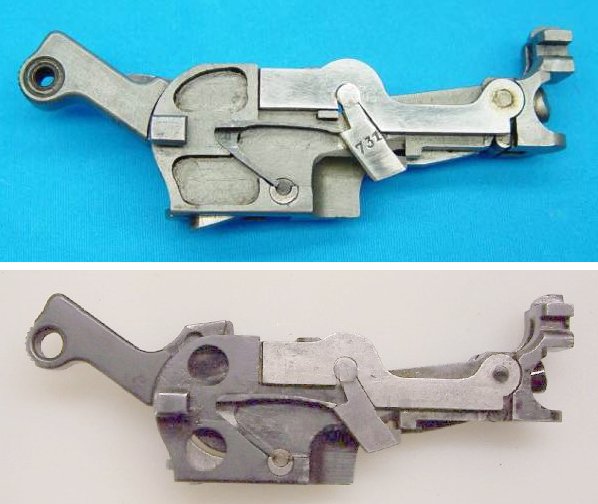

The frame lock latch and spring were in same shape across board. No 1930 available, but pix 30 & 31 of this 1914 gun should help:
http://www.gunbroker.com/Auction/Vie...Item=127896136
On yours, most likely the latch and/or the spring was replaced in the past. Both parts were unnumbered on 1930, but inter-exchangability of parts on Mauser is poor, even for unnumbered ones.

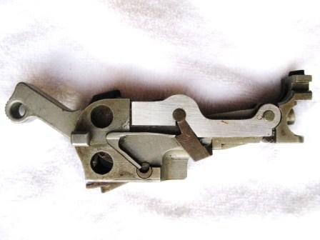

alvin -
Thanks for the link! Mine is shown below, on bottom, with pic from your link on top. I guess mine is OK then. I was concerned that it might have broken the tip of the spring off, but it appears unbroken.
Maybe just fatigued, after all these years...(I know that feeling!)...

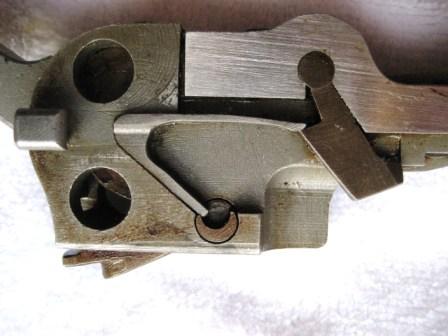

hswee is offline   Reply With Quote
Unread 04-30-2009, 07:34 AM   #6
Originally Posted by hswee View Post
Rich, photos of M1930 lock for reference.
Hal
Thanks hswee!
Does the sear spring on yours keep spring pressure on the lock frame stop when the hammer is cocked??? Mine does not...In your pic, the lower tang is pressing the frame lock down...but mine has a slight bow in it, and is not pressing against the frame lock...it's flopped upward...
I'll have to take the lock assembly apart and check the hammer cavity...In one of Jack Mitchell's books he mentions burrs in the hammer cavity from improper safety operation...I take this to mean dry firing with & without safety on...or playing with the safety operation while dry firing...
I'll see if I can find another sear spring, too...Just as a precaution...

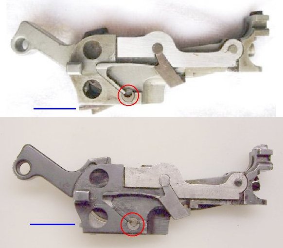

Here's a comparison of hswee's lockwork and mine...red circles are where the lower spring tang presses against the frame lock...blue line shows where the tab you press to unlock it is when the hammer is cocked...Mine is up in the unlocked position; hswee's is still locked...
My spring (or at least the lower tang) has lost its tension...
