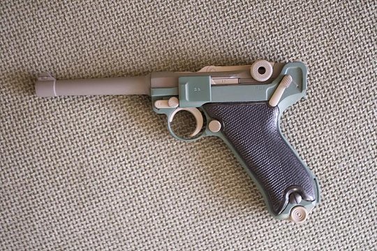

Btw. I thought all Lugers where painted like this

"Btw. I thought all Lugers where painted like this..."
I just threw up in my mouth a little. I will never, ever, make fun of my "Krome Kannon" again!
