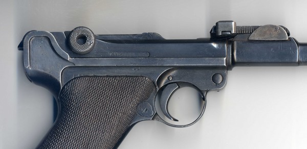

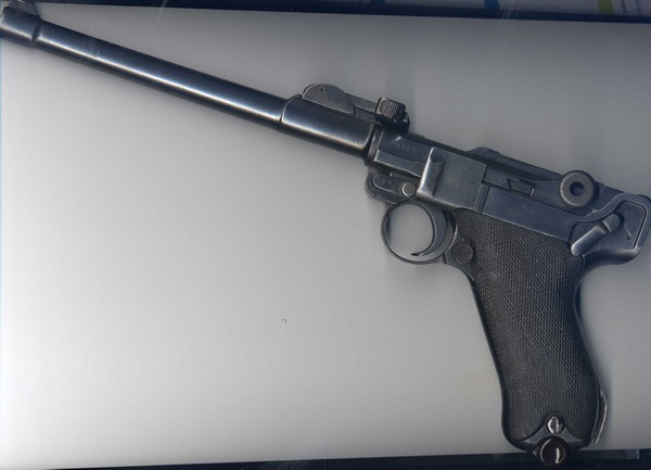

it's not the same quality of my auther Luger but that do you think about this one
1915 and Serial number 4968
thanks

Looks like it has a front sight off a rifle...Jerry Burney

It looks like the front sight has been modified. It shouldn't cover the chamber date.

do you mean rear sight?

The rear sight is off of a Mauser 98 Carbine. They did a good job of marrying it to the base.

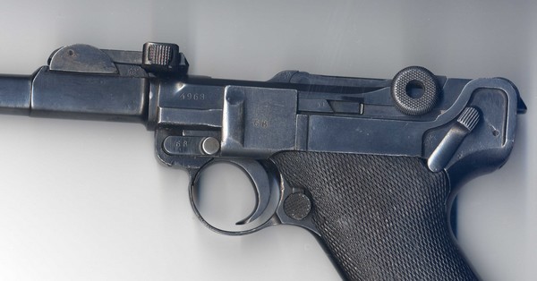

The front sight isn't right either. It was standard to have a adjustible front sight on a 1915 and this one does not appear to be adjustible. (hard to tell from the pictures though) Even considering that, it just does not look right. There should be a base that elevates the sight. Frankly, this gun looks to be rebarreled. The parts that should be strawed look like they were blued. Bad buffing job on the rebluing of the gun. The locking bolt lever isn't right either. The checkered knob has been badly messed with. I think that that is enough on this gun. I pass on it.
If I had any interest in this gun, I would look at the rear toggle to see in an old P-08 sight was filed off. I would have to, physically, see the gun and take a close look to really tell. I think that it is a 'put-together' by someone trying to make more money off of an artillery.

it's an old rework made by an arsenal gunsmith for itself
it' was found in a stock of old firearms and was rusty
it was file-down and reblue without any knowledge in 1955
this explain that

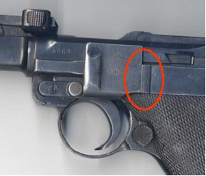

A pretty clever adaptation of a rifle sight. The step behind the side plate is odd...does it have any function?

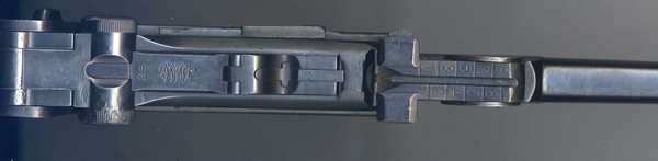

The TDL appears to be from either a M29 Swiss or a Swiss model Parabellum. TH

Rear sight looks to be from broom mauser to me..but modified ..another example of rework lugers

For me it looks like a k98 sight, put into German 1915 DWM, without receiver markings on right side but with a matching swiss TDL and magazine. And it doesn't end there.. some strange piece is placed behind the side plate (to improve mag release spring?) and the front of the barrel looks somewhat home made, making me lean towards a Schmeizer barrel made to fit the Luger. All probably done in a time where there was a lot more Lugers that people drawling over them..
..in short.. buy it! (as a LP08 looking shooter)
Not all modifications is made to enhance the value. I'm guessing a similar situation in France as we have here in norway.. It's often hard to sell a rare Krieghoff for more than a S/42 in same condition. So putting that much work into 'faking' a Luger would be rather silly. Looks like this Luger has it's own special history to tell, and if you're lucky, it's pleasant to shoot with as well. Just my two pfennig
btw. does the receiver have the notch for the rear sight? ..over the chamber, towards the barrel.
