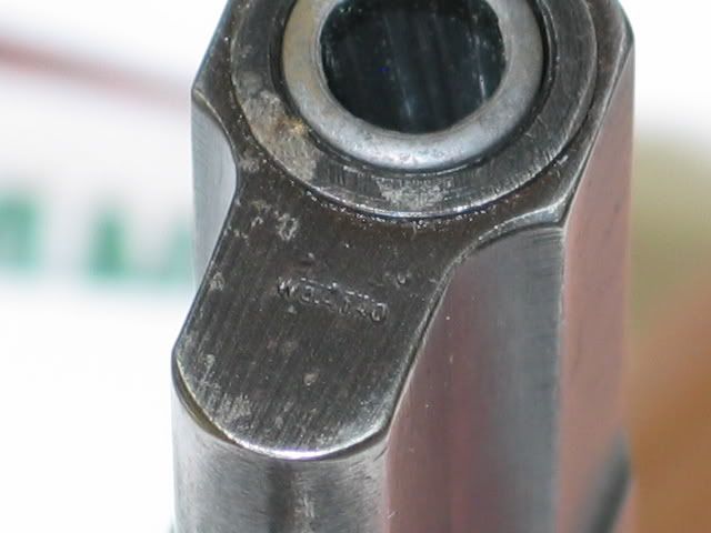

Thanks for the comments guys. Now I'm confused; I've owned a couple modern HP's and never seen anything like this bushing myself !
Do I have some weird mod ? The 'bushing' I'm referring to is just like that of a 1911, but is held in place by the front sight which is staked through a hole in the bushing. The muzzle of the barrel rides through this bushing which is maybe 1/2" long.
I believe this is a mid 42 production gun which look righteous in all other aspects, has it been messed with ? I assumed it was just a production step streamlined out at a later date.
I just came across this auction and if you look at the muzzle picture and look at the tooling marks on the 'bushing' it does seem to be a seperate piece ?

Its not a seperate piece, it is a machined in place/part of the slide, band.

Still confused; the piece I have is definitely a seperate part, it can be moved within the front of the slide. The profile seem a match for later guns.
Can anyone help clarify this ? Possibly this is a repair ? Maybe the front of the slide was damaged and someone made a bushing to fit and staked it in place with the front sight.
I'll try to get pictures to post as I'm now much distressed !

From the photo, it looks like a separate part. I'm no expert, but I've handled more than a few Hi-Powers, and I've never seen anything like this. I'd really like to see more photos when you get the gun. Thanks for pointing this out!
Also, I wouldn't be in a hurry to change anything about this without more information.
