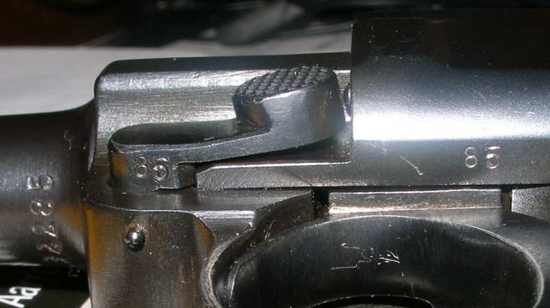

Mostly to satisfy my curiosity than anything, is a bent takedown lever at all common?
This Luger shoots fine and has all matching parts. I can't see why someone would intentionally bend this part. I've seen this on one other Luger, but you normally can't tell from photos since they aren't taken at this angle.
I'm not about to try to bend it back!
-- Dan

I've got one like that...and that's how it's gonna stay!

An unknowledgeable person attempted to disassemble the gun with a pry tool because they didn't realize that the upper receiver had to be in the rear position to move the takedown lever...
This can be bent back, but I wouldn't do it cold, I would heat the lever part to soften the bent location while protecting the part that enters the frame from getting too hot... If the part is original to the gun and you are afraid of breaking it, send it to policeluger to fix it, or just buy a mismatched part to install for shooting...

Thank you John, heat must be very well controlled, used sparingly, remember the "button" is silver soldered on......you can reach me a policeluger@mchsi.com......thanks again

I said I wouldn't touch it, but when I decided to straw it, I decided I had to fix it.
Basically, I put it in a vice at an angle so when I compressed the vice it would bend it back. I put it between plywood to prevent any marking. I dod NOT use heat - it appears bendable enough without heat.
Then I put it back in the frame and had to tweak it a bit with a brass hammer and a large punch so that it held the side plate tight.
I don't recommend anyone try this at home - it would be easy to over bend and ruin it. but it can be done.
