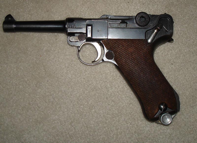

Hi, I am trying to identify a marking on a P08 that has been described to me as all matching including both mags. I don't have the year/code yet. Can anyone identify this marking? I have never seen it before, does it look Imperial? Thanks very mcuh,

very grainy on my screen, looks to be a crown Nitro, sometimes refereed to as C/N...has a police sear safety, that spring steel band sitting atop the side plate....it would ID the gun as serving with the German police sometime prior to end of WW2....please let me know if I can help.

Sorry for the poor pics, will psot better pics shortly, thanks very much,

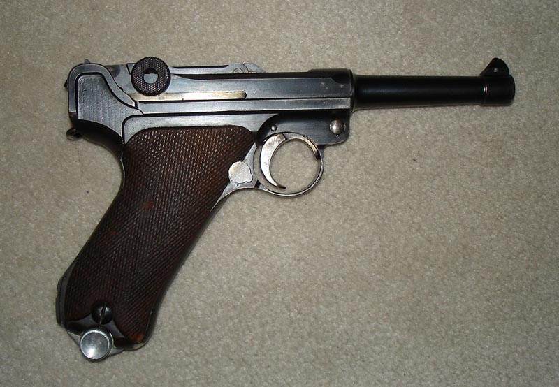

Here are the pics I have at the moment, any help would be appreciated, I se no WaA on closeup on the right side. Will try and get more details soon ,thanks!

next

So Joseph, are you buying this as a matching or "rig" that is police? The holster is police, the magazine looks like it could be?
Are there unit markings on it, and if so?
If it is crown N on the left, it won't have markings on the right, the crown N is the commercial acceptance, which can be seen on weimar alphabet police and others.

this is DEFINITELY a police luger... notice the spring clip that acts as a sear safety just above the sear bar... This was a police modification.
