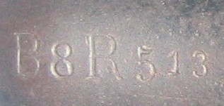

Default Markings on a 1911 DWM
Gentlemen,
I came across this 1911 DWM the other day - can anybody help identify the markings? Thanks!

Bavarian 8th Regiment, 5th Company.

Thanks George, a nice piece of information. I'm still curious about the markings on the frame, I cannot find them in Davis' "The Luger Handbook" which, unfortunately, is the only Luger reference book I have right now.
Claven2, my gun does not have a hold-open function, there's not even a cut-out in the frame for one.
Is this a regular P-08 made in 1911? If not, what is it?

Looks like a regular P-08 made in 1911 to me. The receiver marks are known examples of inspectors marks and Army acceptance.

Balder,
I have done a little photo analysis on your markings on the gunborards thread that you have linked.
