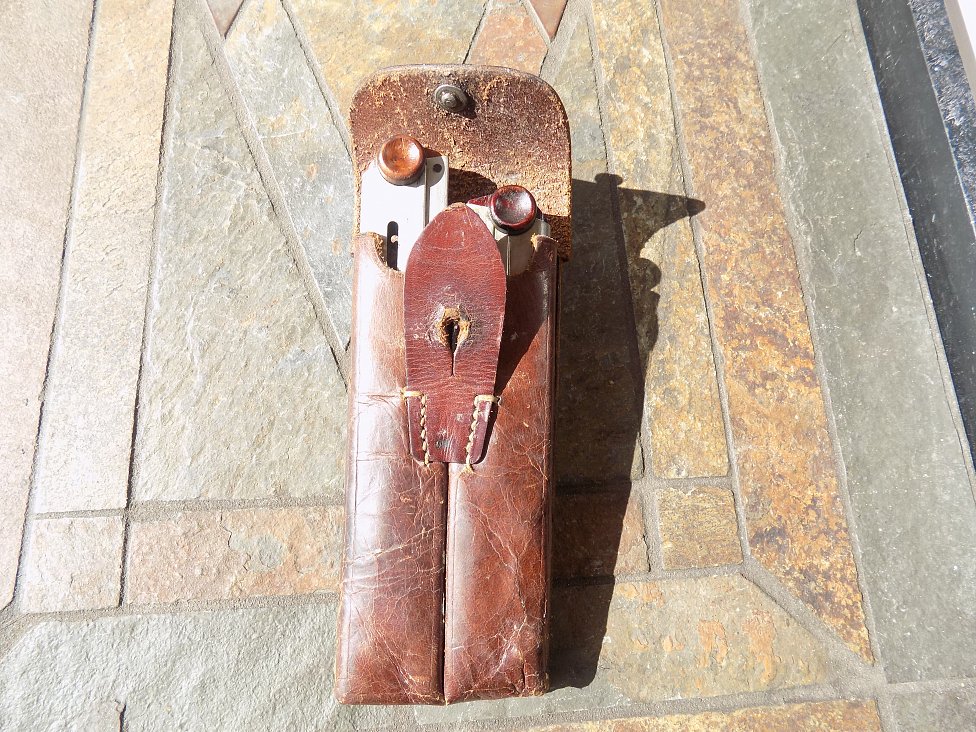

The Mortal Sin is storing a magazine in a collection luger or holster or duel mag! Years ago I forgot I had 2 mags that turned green and nearly impossible to remove!
