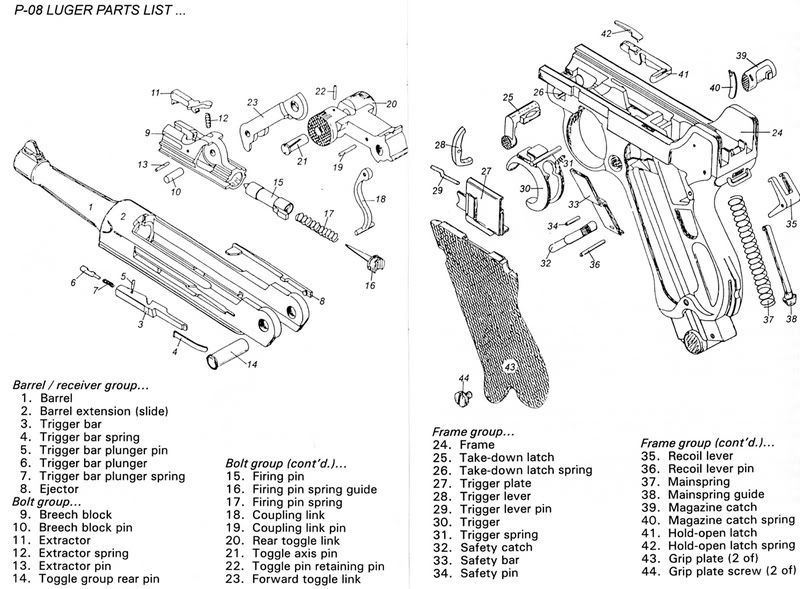

Alx 11-29-2007 12:09 AM
This video guy is doing the de-**** procedure right, but his explanation is pretty lame. He seems to be calling a part of the trigger bar a "striker" and causing some confusion about what is actually happening inside the gun.
The firing pin itself, the "striker" if you will, in a Luger is not visible from the outside of an assembled gun.
It would be more to the point to say something like...
"Partially open the toggle, pull and keep the trigger back, then slowly lower the toggle to allow the firing pin inside to pass the sear on the trigger bar without cocking it."
It may be that your trigger bar has broken or come apart from its pinned place in the slide.
If the slide is moving back and forth with no resistance, then your coupling link may not have engaged the recoil lever when you last assembled the top to the frame, which easily happens if not looked after carefully.
From your description, I cannot exactly visualize the problem your gun is having.
That may be why no-one else has answered your question.
Could you check the diagram and use the words there, ? as everyone will understand better.
http://i5.photobucket.com/albums/y16...rSchematic.jpg

Thanks guys for the help. I got it all figured out now and everything is working fine.
My assumption was that the trigger bar came all the way back against the safety bar when the toggle was lowered. After checking pictures, I see that this is not the case.
Also, when I reassembled the gun, I allowed the coupling link to go behind the recoil lever, rather than in front of it. This prevented me from raising the toggle.

Ron, your gun has a "relieved" trigger bar, which indeed does not come all the way back to the safety bar when the toggle is lowered, but do not assume that all Lugers are this way. Up to some time in 1915, the trigger bar extended all the way back to the safety bar, but German army regulations then determined the the trigger bar should be thereafter milled "relieved" as your is, to allow the gun to be unchambered when on safe. Most of these earlier guns in the German army's possession were sent back to the factories to be modified, but many were left as originally unrelieved.
Notice, that although the chambered round (gun cocked) can be unloaded with the safety on, provided the trigger bar is milled for relief, that the toggle cannot be cycled if the Luger is on safe if the gun is not cocked already.
The relieved trigger bar is only effective in allowing the gun to be cycled on safe, if it is cocked.
