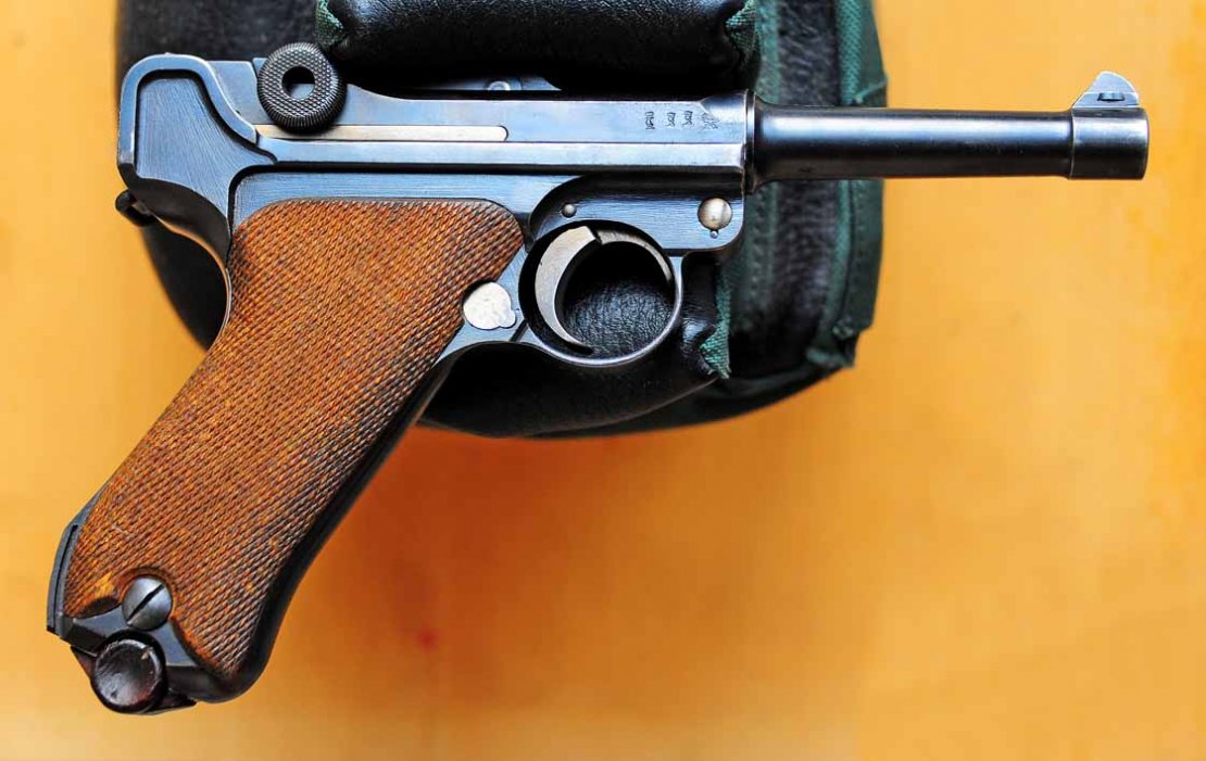

Could some of you estimate the collector value? I would like to use the gun as a shooter, but I can understand the 2 big options out there for special firearms 1- keeping as a safe queen, and 2. taking it out and shooting it, but taking very good care of it. I would really appreciate your feedback here.
Thanks in advance for your responses! I couldn't pass this up... it's beautiful really... and I've always wanted to shoot one of these...

Many of us would consider a matching 1917 DWM with matching magazine too valuable to shoot- for if one breaks a numbered part, he would take a hit of about 1/3 the value of the piece.

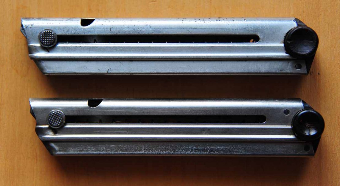

The spare mag is made in Switzerland, and the base is dark plastic- The original matching magazine base is walnut, not ebony. The Swiss mags are excellent shooting magazines; the P on the back is the mfg.
I'd find another one to shoot! In the US your luger would go from $1500 to $2500 depending on where, when, and how sold. It is a keeper for sure.

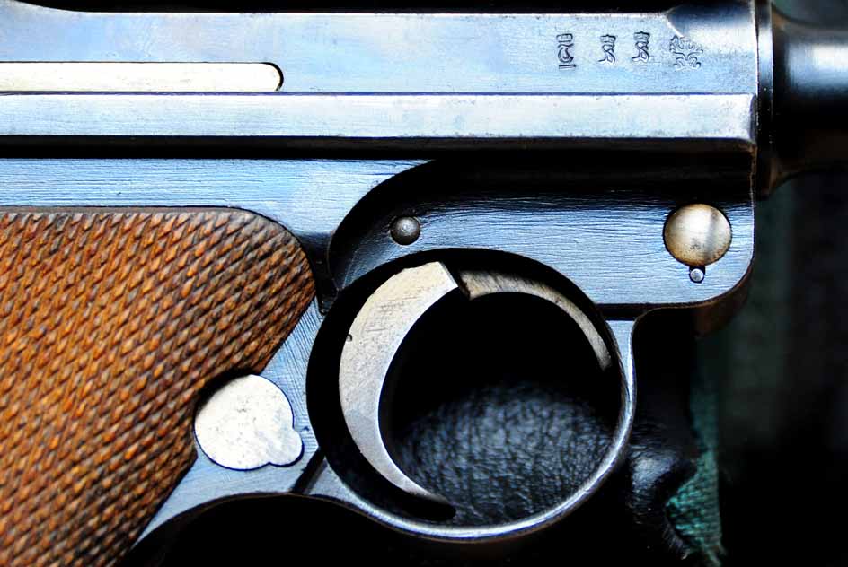

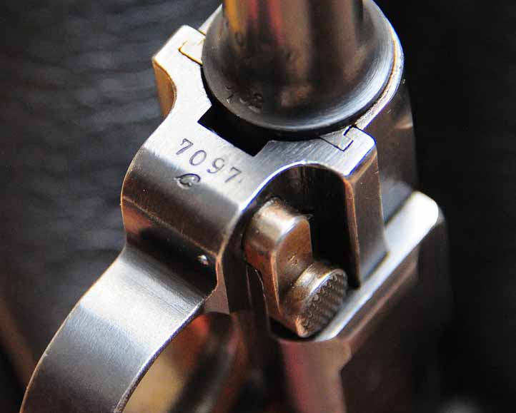

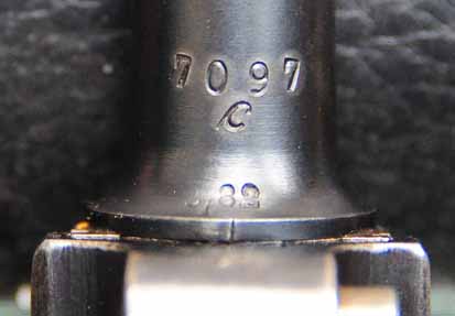

Many thanks for your instant answers! Any comments on the markings shown would be greatly appreciated.... Please see some additional photos below:

you will see the last two of the four digit serial number (or 3 digit or 2 digit) on all the small parts
the markings on the right side are acceptance and proof marks
the marking on the left side of the breechblock is a proof marking

Absolutely do NOT use the original numbered magazine IF you choose to shoot it. Those old wooden bases are fragile and may not take the spring pressure.
