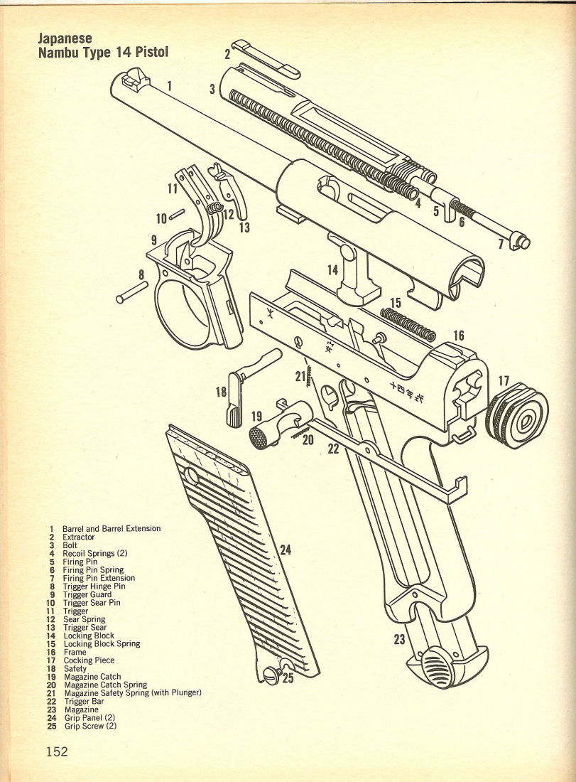

Default Nambu Type 14 Pistol
I think this is the third most interesting pistol on this forum, behind the Luger and the Mauser...And I had some information on them, so without further ado, here it is...

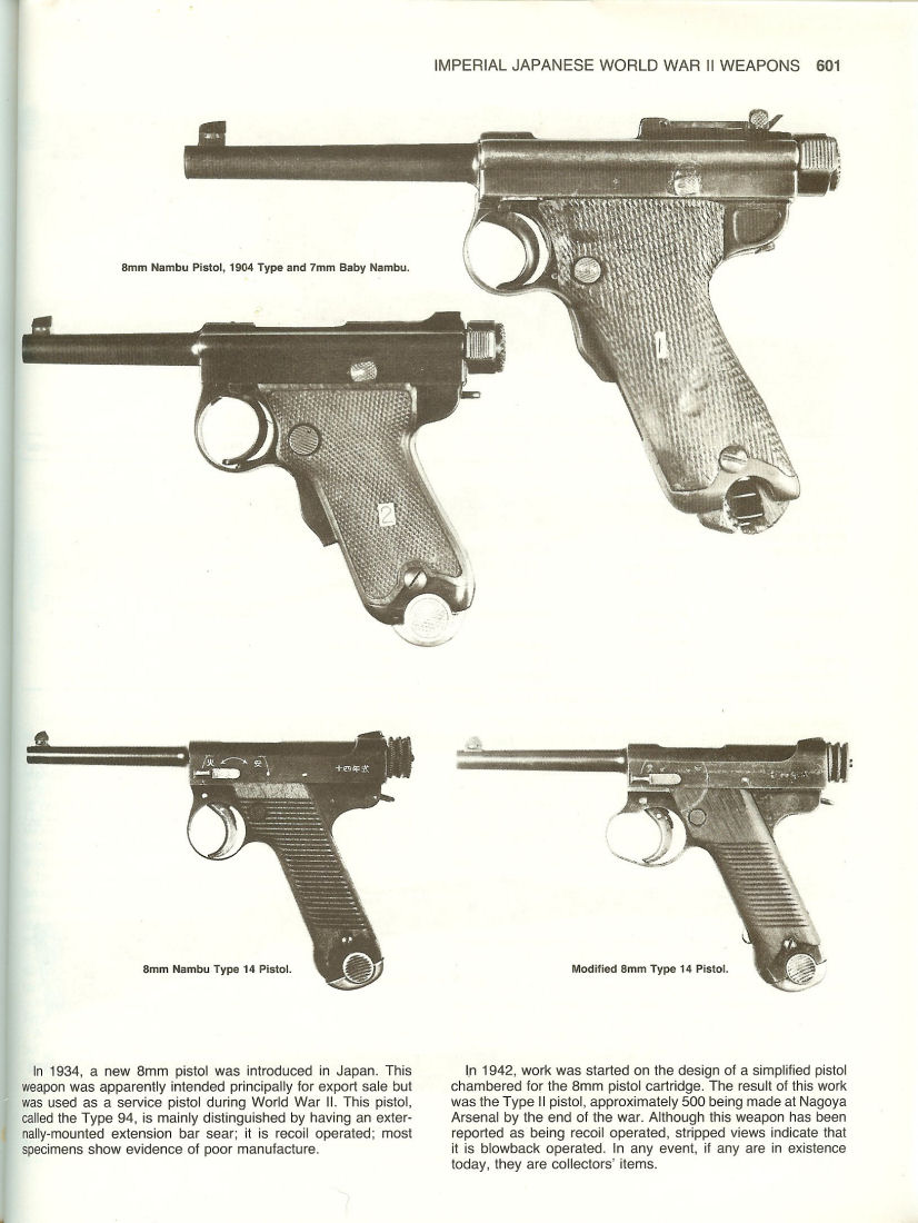

Articles...
