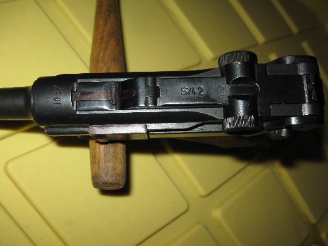

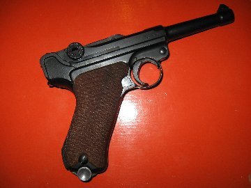

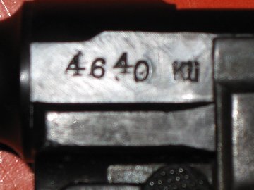

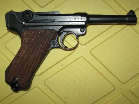

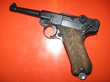

picked up a 1937 s/42 Ku marked luger off a vet for $500, the gun has the letters KU stamped on the receiver, waffen stamps 63 and same on barrel and what appears to me the mauser eagle stamped on the receiver and barrel( not matching serial number?) barrel has zeroed out serial number with another serial number under it, that does not match the frame. what puzzles me is suposedly all Ku lugers were thrown together for the luftwaffe out of substandard parts and should have a 1941 chamber date. here are a few pics of the gun

Ku'S are interesting, and Gibson said in krieghoff Lugers that "some" Luger were mismatched, and or that it is not uncommon to find them this way, I have sold two or three of them and one was mismatched and the others were matched, if I remember right.
I don't remember it saying only 1941, but a 1937 and the barrel being replaced sounds odd to me.

Hi Harry,
There are several members studying the Ku marked Lugers.
A range of chamber dates has been observed on these pistols, including your receiver's year. While 1941 was the last year observed, it's not the first.
It's unlikely that these were made from sub-standard parts in any way.
Its very possible that these pistols were made at a depot level armory out of a range of available parts, particularly as the German armed forces switched to the P.38 pistol and Luger parts stocks could have been considered or declared surplus. So far, no factual documentation confirming this has been found.

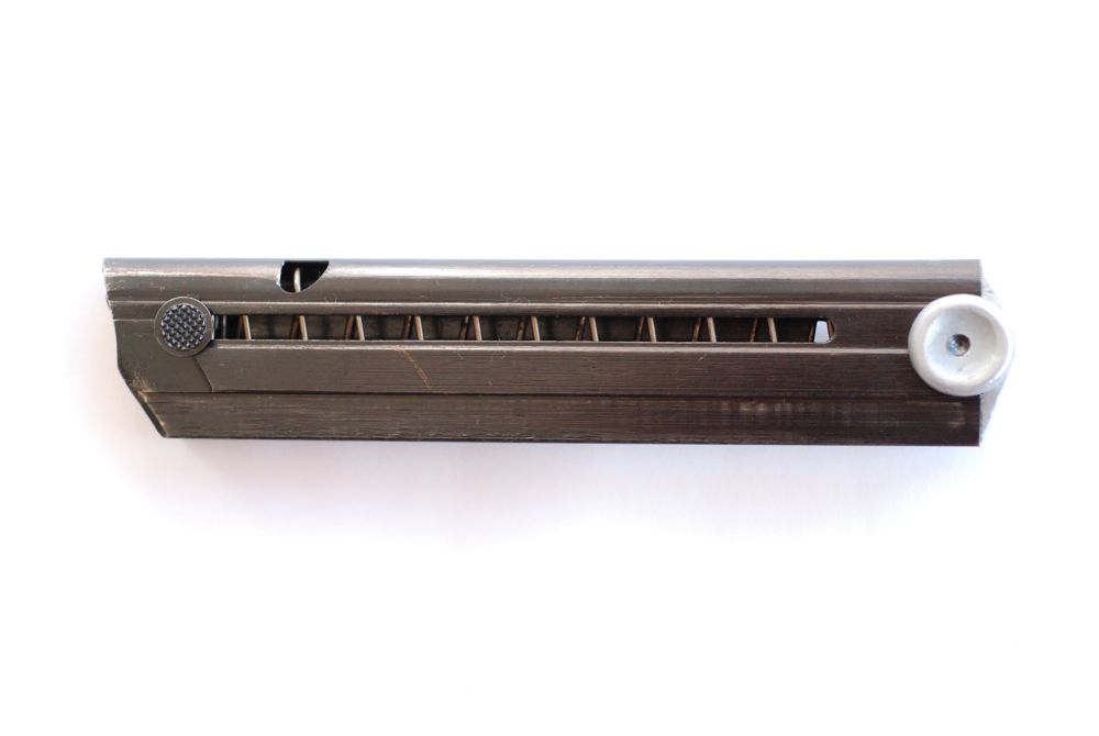

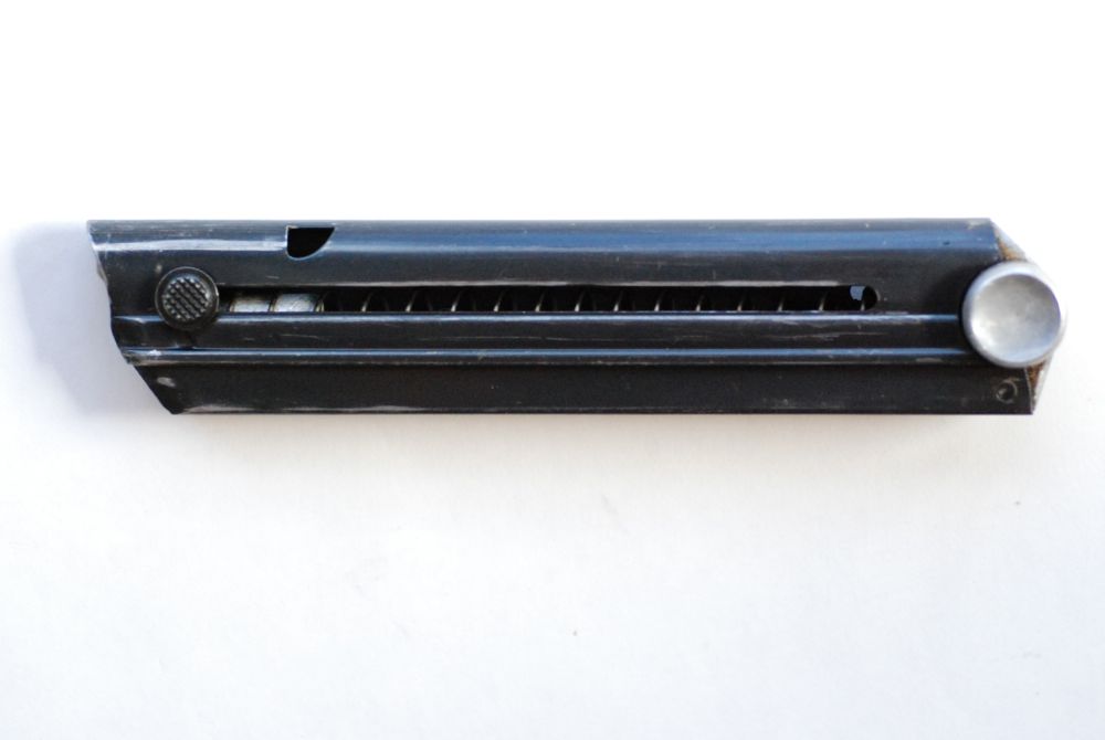

will every book i have on the 1937 s/42 mauser states they should have a FXO mag with a waffen inspectors stamp of 37 and many have unnumbered bases, with pin in the round mag area, should also be marked P08 on it, this includes Jan stills book on lugers

Hi Harry, William is correct. 1937 S/42 P08's came with Type 2 Army mags, as in the first two photos. The fxo Type 3's came later, about 1940. Regards, Norm

Pictures of the Ku Luger from original poster. I let him know we can post higher resolution if they become available.

Marc, THanks for photos. IMHO, a not so well done forgery of a KC. TH

luger doc, you seem to speak allfull quick that something is a forgery? i have had 5 gun shops in philadelphia look at it and we even conpared the markings on another Ku marked luger, they are the same, so what you are basicly telling me all KU lugers are forgerys

What LugerDoc is trying to tell you is that even with the poor quality focus photographs you have provided, it is obvious that the serial number on the side of the upper receiver has been re-stamped, changing the number.
The machine marks on the side of the receiver where the original number was mostly removed before the re-stamping are obvious even in the poor quality focus of the photo.
The number of gunshops in the Philadelphia area that you have been to, has no bearing on what level of expertise they have in Luger identification. Having "similar" markings isn't the same as having identical markings.
This forum has been in existence for almost 15 years and the internationally recognized Luger historians and advanced collectors who are members of this forum (which include Jan C. Still just to name one you are familiar with) are more that willing to assist you, but if you are not willing to be open to their opinions and expertise, then you are wasting your time asking questions.
