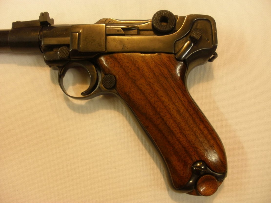

Hi, I am new to the forum. WOW a lot of info and history on this site. I like to find unusual guns (not much value sometimes but they have unique properties)
Let me start off here.

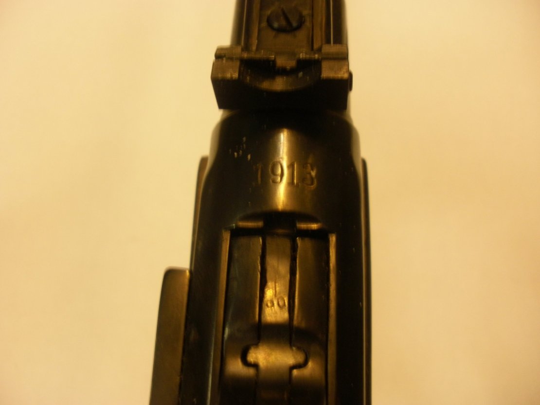

I acquired what looks like a DWM 1913 .45 conversion.
SN 2260 - not all numbers match - It looks like someone has tried to remove the markings on the right side of the receiver
It has an 8.5 inch barrel. The rear sight ring covers where the numbers should be on the barrel opposite the frame number.
Adjustable sights mounted on the barrel by means of a one piece ring set up. It almost looks like they removed the front blade and slid the sights up as far as they could and sweated them in place. Instead of meters it says Micro on the top of the sights
The grips are smooth wood with the magazine butt matching.
I tried putting two rounds in the mag and cycled the action. It fed the .45 and ejected it without a problem.
I am having a hard time finding any info about this gun except (A) it doesn't exist or (B) it was cobbled together using Luger parts. I vote for (B)

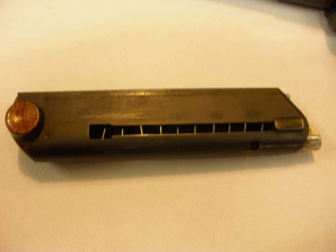

I have not torn it down yet. I did take the grips off and it looks like they cut/ground some of the front magazine well away to accommodate the .45 magazine. As I have been studying some of the topics on this site I do see they made their own magazine release spring or modified the original.
Any help would be appreciated on parts and things to watch for on these conversions.
Sorry if I loaded this topic in the wrong place. I wasn’t sure if I should put it up on this site. Ya’ll have some awesome purebred Lugers on this site and this one is a mongrel pup at best.
I uploaded some pictures in case anybody has any ideas. Constructive that is. lol
Thanks
Tom

I would vote for B also and if it were me I wouldn't even attempt to fire it.

Yes, B. I highly recommend caution if shooting it.

Looks like a reasonably good job by a gunsmith that knew what he was doing and not just a bubba hack job. The mass of the barrel should help tame the recoil. More photos would be appreciated to see the frame modification, how the bolt face was opened up, heavier springs, etc. I have seen a photos of a couple of .45 conversions that were made with standard Luger frames (not enlarged as John Martz does by splicing two frames together). I would imagine they might have feeding problems because of the different overall length of the 9mm vs .45 cartridges. Perhaps the custom made magazine and frame modification accommodates this.
I suspect it is probably functional and could be fired (but I assume no liability if you do!). Is there any evidence that it has been fired?
Neat gun. Looking forward to some more photos.

Note that the toggle ramps have been built-up and reconfigured to open the toggle earlier.
Does anyone recognize what magazine might have been the donor for the modification to work in this gun?
Unread 12-15-2009, 03:33 PM   #9
The magazine body may be from a Colt .45 1911, but actually looks more scratch built than anything. I've never seen one like it.

The gun has seen many modifications.
I do not like the short cycle of the action, it worries me that there is not enough delay to allow high pressure gases to reduce in pressure before the action opens.
Please be very very careful if you decide to shoot it!

It would be interesting to see pictures of all angles of the magazine and details of its construction. John Martz has mentioned that the most difficult part of creating his .45 Luger conversion was to create a reliable magazine, which the rest of the gun was then designed around.

seems like the innovation on this one is the modified profile of the feed ramps , I dont think this has been published or referenced anywhere
would be important to see how that much magazine length can be accepted into the frame front and rear guide channels for the magazine

It would appear that your mag is modeled after the T94 Nambu mag. John Martz used modified .45 Sig 220 mags that he got from GT. TH
