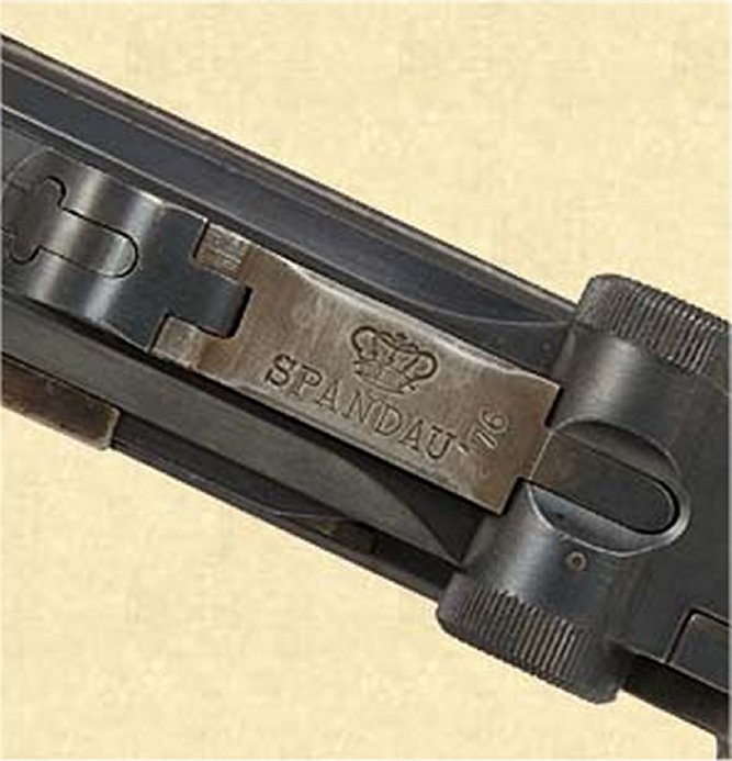

http://www.simpsonltd.com/product_in...oducts_id=5104
I know these are controversial..why would a well known dealer put one of these on their website without a "Buyer Beware" notice?

Because they are in the business of selling guns--sometimes, particularly, uncommon or rare ones. Caveat emptor is implied in any transaction involving a Luger--they are under no obligation to do your homework.
A casual glance at Still's Imperial Lugers pp.62-63, 79-80 will reveal just how wrong this gun really is. This, along with the absurdly low asking price, should be enough to warn off any reasonably alert buyer.

By all indications--the receiver power proof and the lack of inspector stamps on the gun--this is originally a DWM.
The Spandau Lugers I have seen pictured are Erfurt origin, and have two extra receiver inspector stamps, as well as some distinctive numbering which this gun lacks. In addition to the questionable toggle stamp.

Isn't the toggle (not the center piece) a little too good compared to the rest? ..or can that be right?

For those new folks who do not see the issues with this Luger... notice in this cropped photo and compared with the rest of the Luger that this toggle link's finish is UGLY compared to the rest of the gun.
Even if this is a GENUINE SPANDAU toggle link... I doubt it could pass as a SPANDAU Luger... See Dwight Grubers comments about the inconsistency of proof marks... I think this is a DWM gun that has had the link replaced with either a REAL SPANDAU link that is number matched or just a out-and-out fake...
I agree with George Anderson that Simpson's should have made more comment than they have... if it is a consignment piece, it should be so stated... along with some explanation about why this type of gun is "controversial"... Just my $0.02

They have added it may be fake!!!

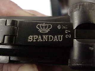

I own the Spandau (#27) that Ralph Shattuck showed/owned, with the six known (+1 owner unknown at that time) in the mid 90's.
NAPCA had a show in Odessa Texas. Six of the known 7 were displayed together.
See thread: http://forum.lugerforum.com/showthre...hlight=spandau

I have found out that Steve Fox in Philly has one with bring back papers.
Here is what a real toggle should look like:
All the best to everyone,
Fred Pack
