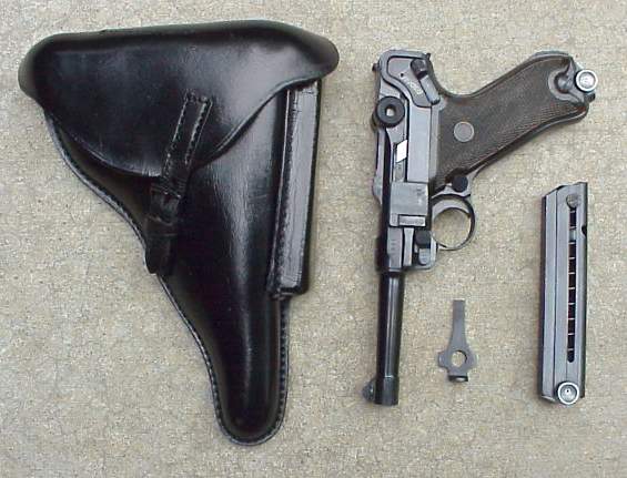

Here is a photo of an East German "VOPO" P.08 rework in my collection. This particular luger has the quickly identifiable plastic bullseye grips and DDR police proofs that identify it as an official Volkspolizei rework.

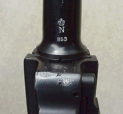

Interestingly, I see the same armorer rework instructions/techniques carried out on the VP lugers as on the Weimar period reworks. For instance, VP armorers did not usually scrub serial numbers but cancelled them out and then stamped, or electropenciled, new ones to force-match new refit parts. Earlier armorers did the same thing following then current marking instructions. Of course, the DDR crown/N proof and the VP star proof certainly indicate a VOPO luger. This particular pistol has one of the new DDR production barrels you spoke of with the roughly crowned barrel. This one was reworked in August of 1953 according to the barrel markings. This coincides with the 1953 date mentioned by Marschall for the time new luger production (as the P.1001-2) took place at the VEB Ernst Th�¤lmann facility in Suhl.

Thanks for the reply. Is the "X" generally above the serial number on the Russian capture receivers? I was not certain there was a usual place for this marking. If you look at the VP stamp on my Luger you will notice that there is a previous stamp to the left that has been cancelled. I take that to mean that this pistol was probably reworked twice, or at least it was certainly inspected twice.

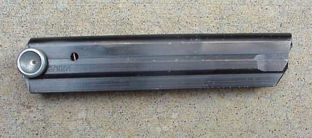

Here is a view of one of the VEB Th�¤lmann P.08 magazines with the "2/2001" Lieferer- Nr. stamped on the body.
