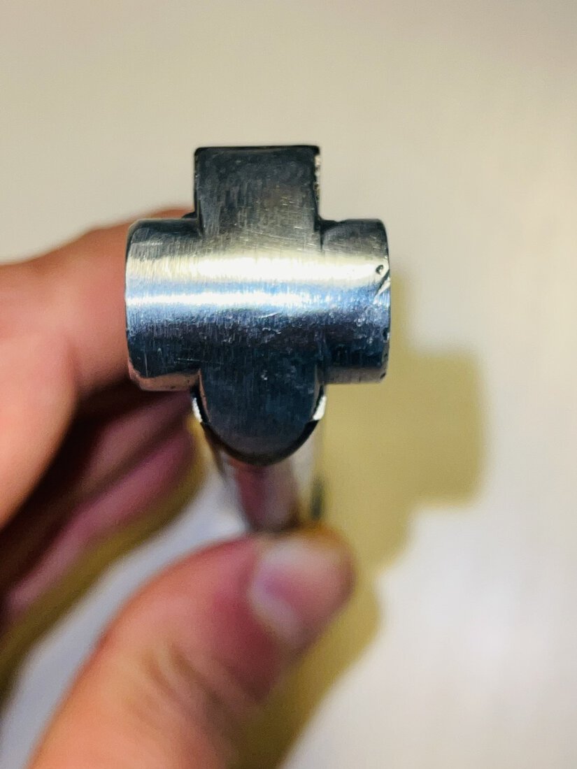

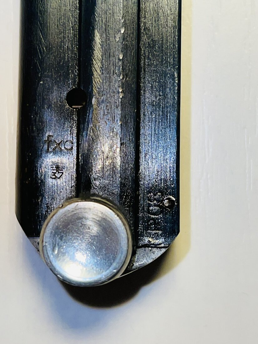

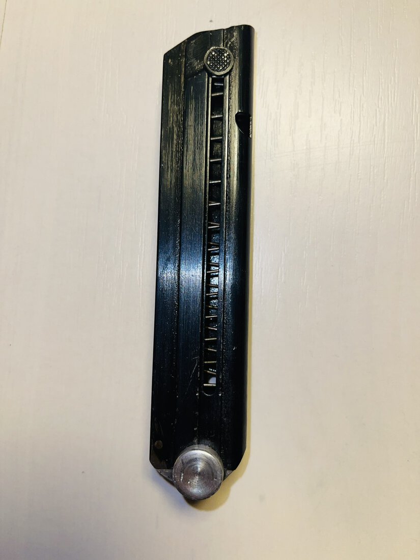

Hello,
the magazine inside the P08 I bought doesn’t match with the serial number of my gun (I knew it before buying it).
Could somebody help me to understand the origine of thi magazine, please?
Thanks
Andrev

Your magazine started out as a center pinned fxo produced in1941-42. The same type as in my photo.
Sometime in the past the original bottom was removed and an older type side pinned bottom was added.
thank you!
what could it be the factory who made it?
andrev is offline   Reply With Quote

C.G. Haenel produced fxo magazines.
