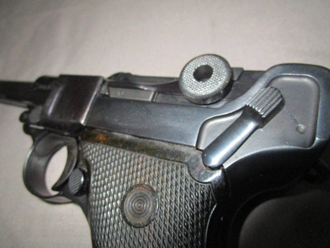

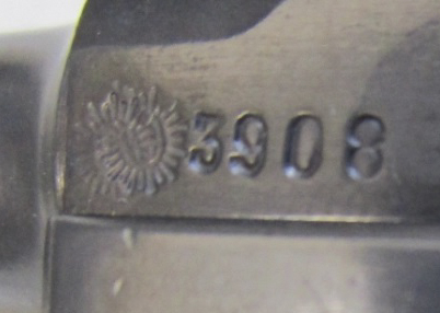

Newbie with question about a proof and a possible buy. I hope I'm posting on correct thread. This is a 1939/42 Luger with black grips with target circles. It has what appears to be a 'double' stamped proof on the L side of frame. What is that proof? I don't see any East German or Soviets proofs otherwise. The grips, I believe, are more commonly seen on VoPo East German (Soviet reworked) pistols. Nothing 'scrubbed' and no electro pencil marks. The R side of receiver markings do not match the markings in 'Standard Catalog of Luger,' Index #174 (pg. 210). Any help would be appreciated. ? Value??

That is a WW2 Luger that was subsequently reworked by the East Germans for use by the Volkspolizei (People's Police) or more commonly known as the Vopo. The shield-in-sunburst is a stamp used by the EG inspector or worker who accepted or repaired it. The "Bullseye" plastic grips are also a characteristic of a Vopo Luger. The E/63 inspection and E/S stamps are normal. It appears to have been refinished.

Welcome to the forum. Your Russian captured WW-II era Luger was manufactured by Mauser, and is a very high quality pistol.
These were hand fit, and make excellent shooter Lugers. Don't hesitate to take it to the range and enjoy it. Use standard velocity 9mm ammunition. Some are ammo sensitive, so try 124gn ammunition if 115gn doesn't cycle reliably. Don't use "NATO" power ammunition.
