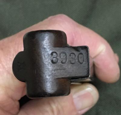

Here's mine.
One of the 9 orphan mags on Norme's list
Mike C.

Excellent rust blued Imperial Navy mag Mike, thanks for showing.
Norm

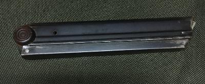

Found last week this orphan Navy mag.
Regarts
Thorsten

Hi Thorsten,
Yours and my mag were probably on the same rack 105 years ago... only 29 #'s apart!
Mike C.
