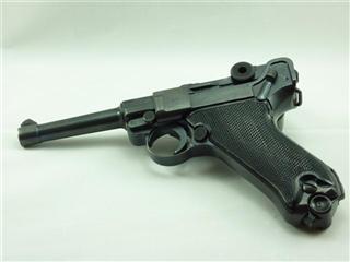

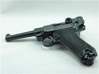

What's wrong with this picture? Well the first problem is that the use of the flash gives it a very "harsh" look. In addition, all of the detail gets blown out, we cannot see any of the serial #s or judge the condition of the finish accurately.
Now some people realize they can't get good shots using the flash so they turn it off, resulting in a picture that looks like this:
With the flash off, we can at least see some of the details such as the serial number. However, the picture itself is blurry and has a yellow cast to it from the overhead incandescent light.
So combining the problems of these two pictures, we need to solve for three elements 1) have enough lighting to properly expose the picture, but not so much that it blows out the detail (like using a flash), 2) keep the camera steady enough to get a sharp picture, 3) make sure that the color is accuartely represented. These three issues can be solved by the elements I discussed above, namely indirect lightning, use of a tripod, and setting the white balance.

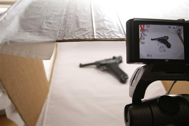

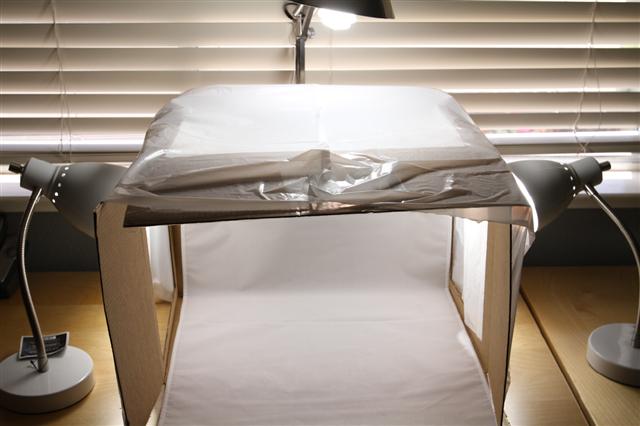

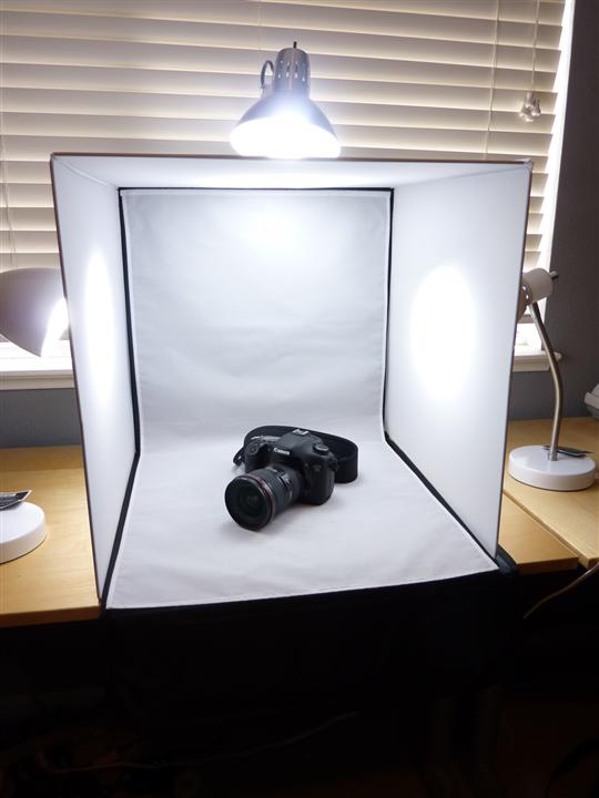

Here's my setup:
To get good pictures, you need the right equipment......NOT!!! Here's how you can accomplish the same thing using stuff around the house and a regular digital camera. All of the pictures from here on will be taken using my wife's consumer "point and shoot" camera, not my digital SLR.

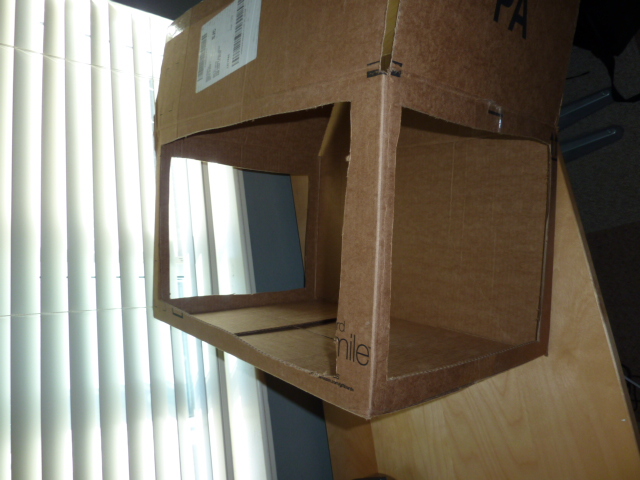

Step 1 -- Make a Light Box
The goal of this step is to provide enough light on the item you are photographing, but indirectly. Photographers call this a light box or light tent. The idea is simple, diffuse the light going to the object, accomplishing the task of lighting it up while avoiding harsh shadows.

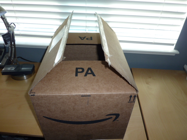

Start with a cardboard box, a moving box is a good size.
Cut the box on the left and right sides, and on the top.
Now cover the holes using that is white and will diffuse light. A t-shirt, bedsheet, or white kitchen trash bag all work. I used trash bags. At first I did a bag per side, but it was not letting enough light in. I ended up cutting up the trash bag so that only it was only a single layer of plastic for each side. Also put something to use as a background inside of the box. A white pillow cover would work well. Just about any type of fabric inside will work (as long as it does not reflect).
Now you have your "light box". Simply light it up using any kind of lamps you might have around the house. I used cheapie "desk lamps" that I bought from Walmart for $9 each.

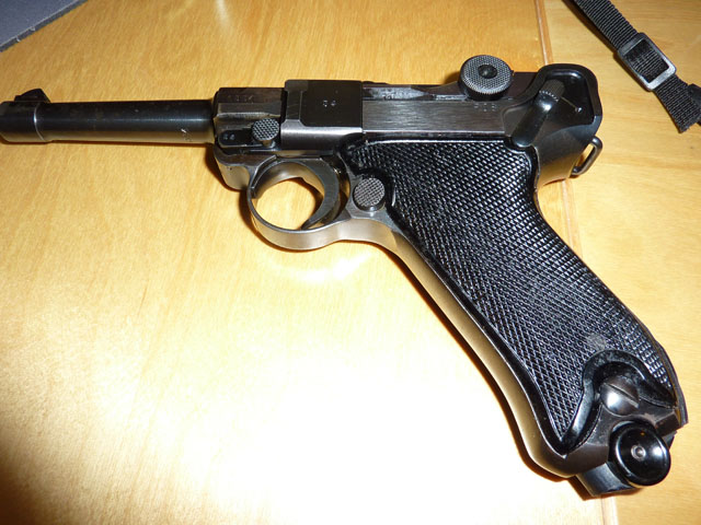

Now place the item you are photographing inside the light box. I have found that a roll of tape to be an excellent item to prop things up. Because it's somewhat sticky on the edges and doesn't damage anything.
Luger propped up using a roll of electrical tape:

To get really sharp pictures, you will need to make use of a tripod. Since we are not using flash and only indirect lighting, the camera needs to keep the shutter open longer to expose the picture. However, if the camera moves (even just a tiny bit), the result will be a blurry picture. We are not capable as human beings to hold the camera steady enough to get a super sharp picture using this type of setup and with the available light.
Camera tripods are really cheap. On ebay I see a new 50" tripod for $12.95 and free shipping. This will work perfectly for our purposes.
Place the camera on the tripod and adjust the tripod to get a good angle of the item you are taking a picture of. I like to adjust the angle so that the item I used to prop the gun up is hidden.
Step 4 -- Take the picture!
I like to use the timer function to actually take the picture. As I mentioned above, any little shake will blur the picture. This way I can press down on the button, start the timer, and then back away from the camera. The camera will count down a few seconds, and then take the pic without me physically touching (shaking) the camera.

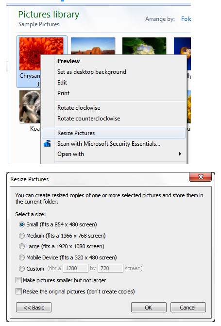

Now most of your cameras will take pictures waaaay too big for forum use. You'll need to resize the picture into a smaller size for it to fit nicely in a forum post. I mostly resize my pictures to have a horizontal width of about 800 pixels. To resize the picture you have a variety of options. One option is to resize the picture in a photo editing program (like Photoshop, or Photodeluxe, or whatever software your camera came with). Or, for a quick and dirty resize I really like the program "Image Resizer", which allows you to right click on a photo and resize it right from inside of windows (no separate app needed). You can get Image Resizer (a free program) from here: http://imageresizer.codeplex.com/

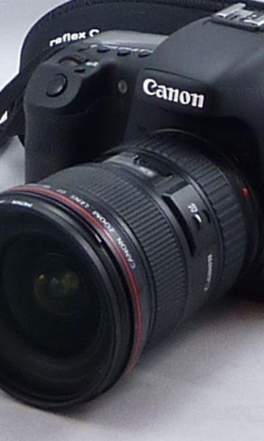

For example, let's use the picture I posted earlier of my setup:
Let's say that I only wanted to show you a part of the camera. Well I would use a photo program to crop out all the stuff I don't want.
which leaves us with the following result (after being resized to fit into this posting)

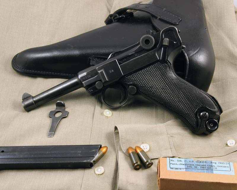

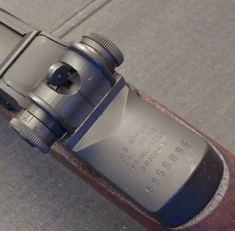

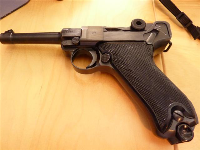

So after all of this hard work, let's see the end result!!!! You can see the color looks nice because we set the white balance. I think it looks pretty nice considering I used my wife's cheapy point and shoot and a cardboard box with garbage bags!!!!!

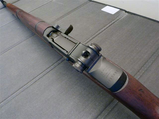

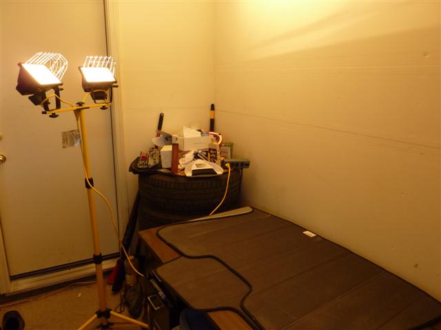

Here's my rifle photo setup, a cheap shop light pointed towards the ceiling.

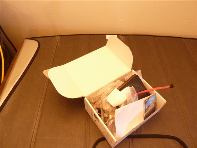

As you can see these halogen lights throw off a very yellow cast. So we'll need to do the custom white balance again.
1) Grab something white (white box of junk I had handy in the garage)
2) Choose "set custom white balance" on the camera, voila! box turns white!

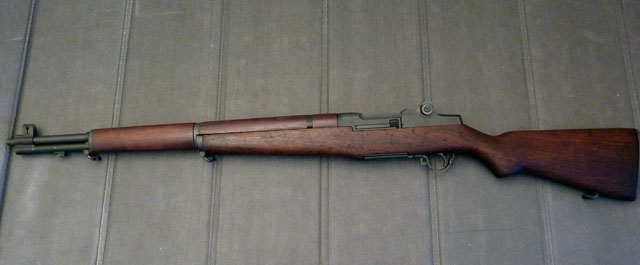

and here's a pic after WB has been set:

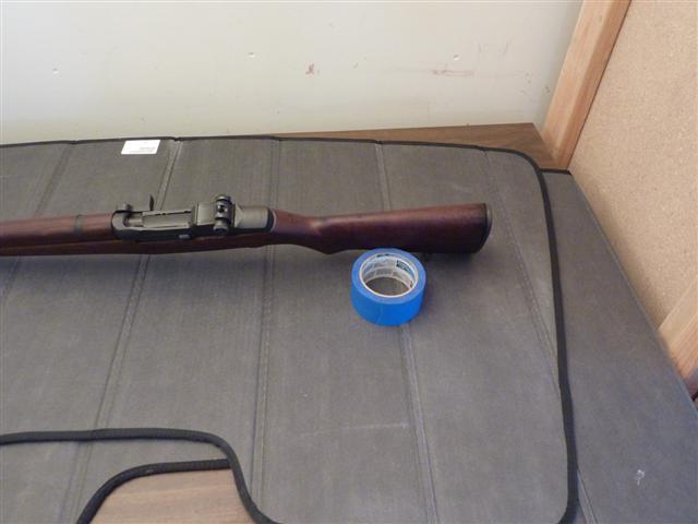

using my "tape trick" to prop it up
the pic:
and finally after playing with cropping:

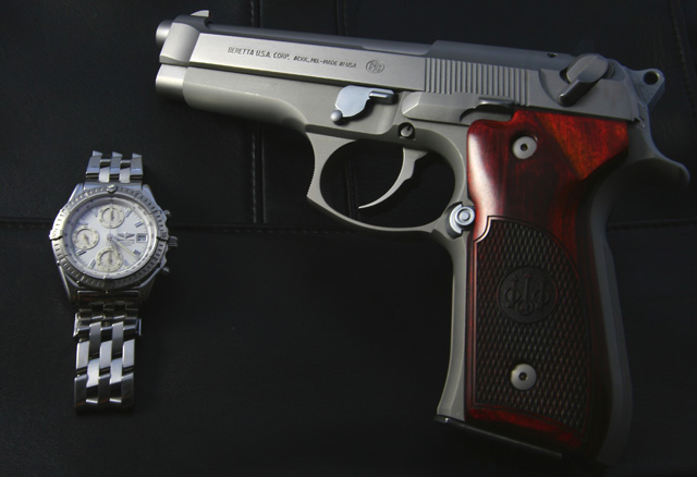

I just realized one fact -- In this era, 50% of selling an ordinary gun online is selling the pictures (another 50% is price/condition ratio). Picture like the following one is hard to sell, even if the item is perfectly fine and asking price is very modest. Especially when it came with "AS IS, NO RETURN" clause.

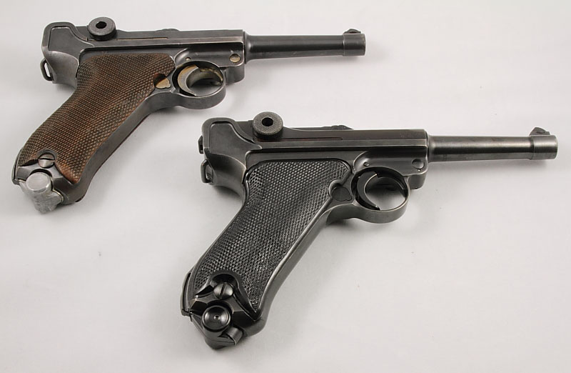

I'd like to echo Marc's advice about using an SLR. I set my Nikon D80 on full manual. Manual focus allows me to get the area of interest in sharp focus, and manual exposure control ensures that blued steel is correctly rendered. I take a few test shots, fiddling with aperture and shutter speeds, until I get it right. Finally, I use a plain white sheet of paper as background, it's amazing the difference this makes. Regards, Norm
