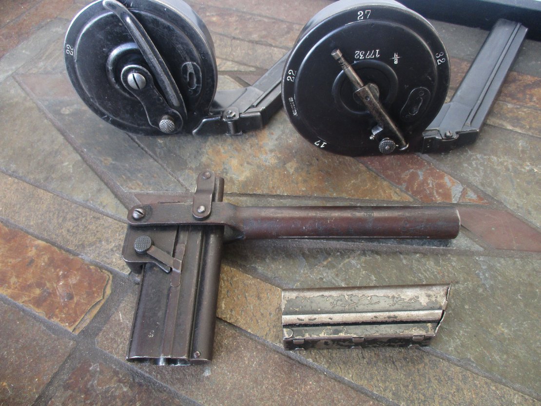

Loading Even with the mag spring is nearly impossible to fully load without a loader. Your thumb will fall off for a full load!
Name:	DRUMM 003 - Copy - Copy.jpg
