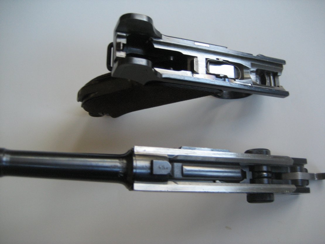

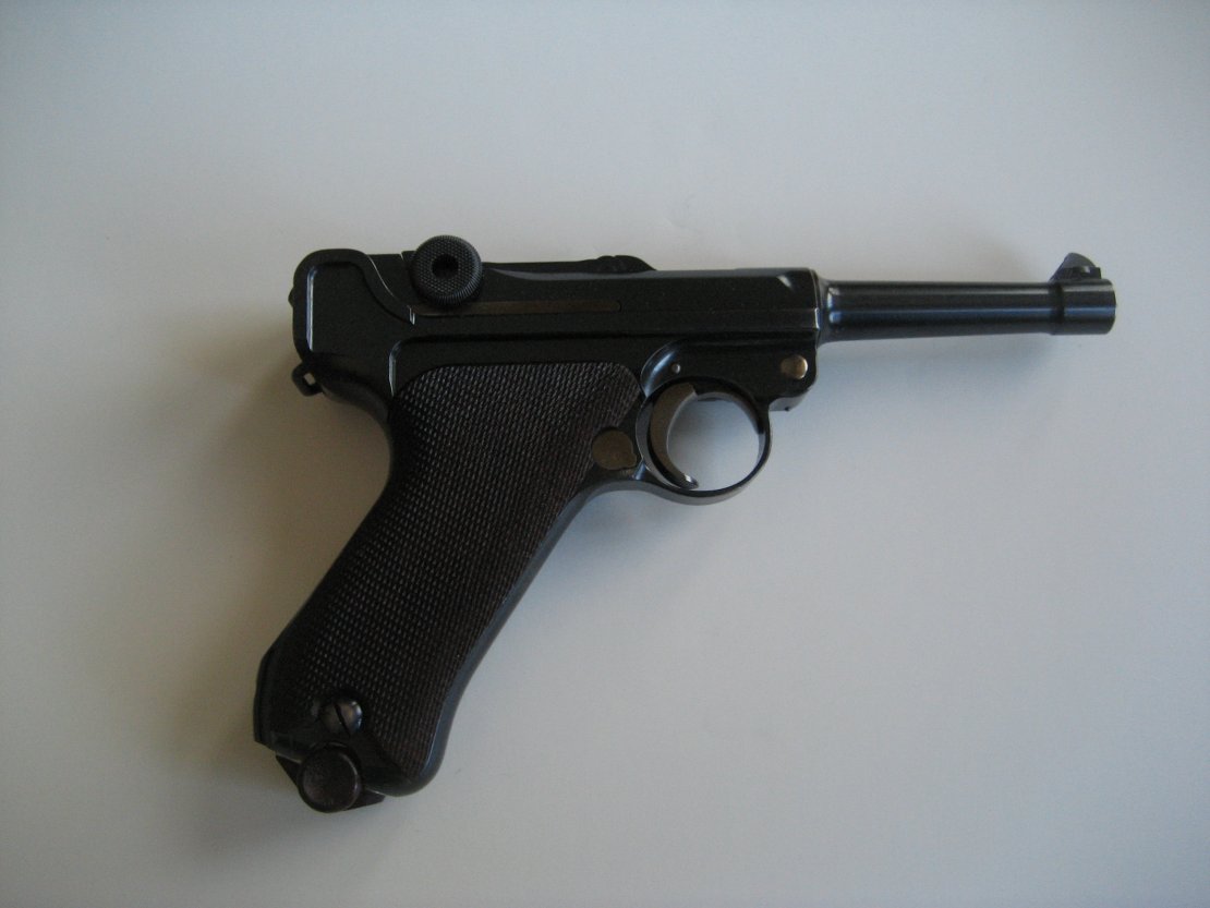

Default 1914 commercial photos
not the best photos but best I could do

Very nice looking piece and from what I can tell from the photos, it looks original. I presume that the Crown/N on the right side of the receiver is horizontal and the numbers all match? Looks like you found a keeper. Commercial holsters are not common, could we have a photo or two of it as well? Thanks.

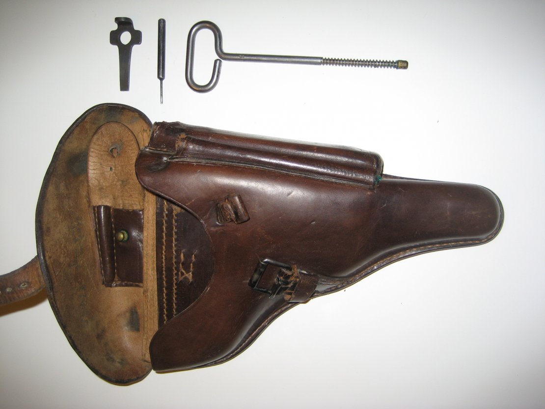

Default 1914 commercial holster
I just got the holster and 2nd mag for the gun. Holster is in very good shape and has cleaning rod, tool and punch included. There is some writing inside, can't quite make it out as well as s/n of gun stamped in ink...There is no Germany on the gun so I assume it was German commercial sale..Here are some pics

Gorgeous rare rig!!! I'm jealous. I hope someone can translate the German writing for you.

While the pistol is commercial the ink writing in the holster seems to be a last name, (REHM) then a military ID.
I make out 2nd. GNB? Regiment. Can you elaborate on the middle set of letters?
Unread 02-19-2009, 10:10 AM   #13
This is a classic example of an officer's pistol. I would like to see a clear close-up of the inked markings in the holster lid. There were eight officers in the Prussian army named Rehm in 1914. I haven't looked at Bavaria or Wurtemberg yet.

Can't quite make them out ,definitely put there by the owner it looks like....
either GNE, GNB, GNO, first letter could also be a Y I suppose
number again is S/N

I think it's 2 Grend. Regt.

Any match-ups with "Rehn" and this regiment, George?
Unread 02-19-2009, 04:27 PM   #18
Not that clean as some were reservists and attached to Bezirkskomando prior to August 1914. I will go at it from 1919 information and see if he shows up that way.

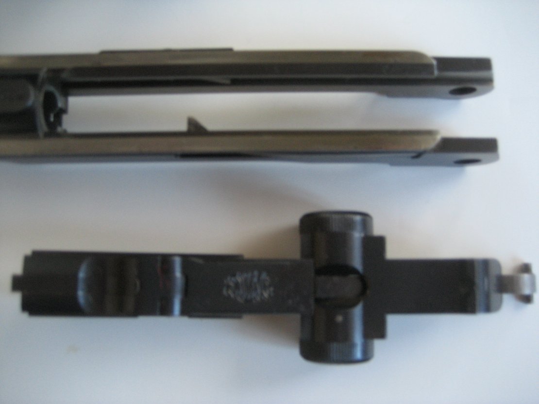

Looking at the letters under a glass it looks mor like The first letter after the 2 being a y, G, or J (not sure of the writing style) and the next look more like (n 1 0 )or (n i o) and then the RGT most definitely looks like 2 letters there instead of a (d) as previously thought
Also looks like some type of mark on the gun's front sight front above the muzzle opening..Need a better glass but looks like 2 x's or 2 crosses with something in between.... all together looks like a vehicle ?????

Officers in the old German Army had to buy their pistol and the holster with their own money. Here is a nice example of this practise. Many of the commercial P08/ Lugers were sold to the officers. They could buy their Luger for a lower price. It seems that only DWM Lugers were sold to the officers.
Is it possible to see a closer photo of the acceptance mark on the cleaning rod?
