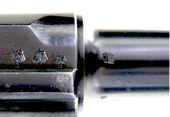

Hi Chris,
It looks like the real deal to me as does the tool, pictures of the holster aren't good enough to make a determination. If I was a Kreighoff collector I'd go 5K for it, but then I'm a gamblin man. Norm |

I am no expert, but does the 1936 look pantographed? Maybe it is just the lighting?
#7 |
Join Date: Nov 2011
Posts: 224
Thanked 81 Times in 41 Posts
The 1936 is not pantographed. The 3 has sharp 90 degree corners which a pantograph cannot do.

Well, looks like the 1936 has been discussed on the other forum and it has allegedly been refinished.
https://luger.gunboards.com/showthre...955#post890955 Last edited by Pistol; 07-16-2019 at 02:39 PM. |

I disagree with those guys. The "thumbprint" on the rear frame is clearly visible and the E/2 on the right frame rail looks like it has been stamped through the blue, as is proper. Given the poor quality of the photos buying this gun would always be a bit of a gamble as I said in post #2. I have no connection with the seller or the buyer and I don't collect Krieghoff's, if I did I would have most likely taken a chance on it.

The right side barrel proof is the one that is supposed to be through the bluing on this gun - NOT the frame proof .
This is well covered in pics on the other forum . I am not aware of ANY EL/2 acceptance stamps that are through the blue . The right side barrel proof is an eagle - Not an EL/2 . |

This is the only luger I have ever seen with a stamp on the frame under the usual acceptance stamps. Is that unique to HK's ?
#17 |
Location: WI
Posts: 88
Thanked 69 Times in 36 Posts
Normal on HK's .
It is the acceptance into inventory proof for parts . BTW the receiver , barrel and frame being the same color is a HUGE red flag . |
