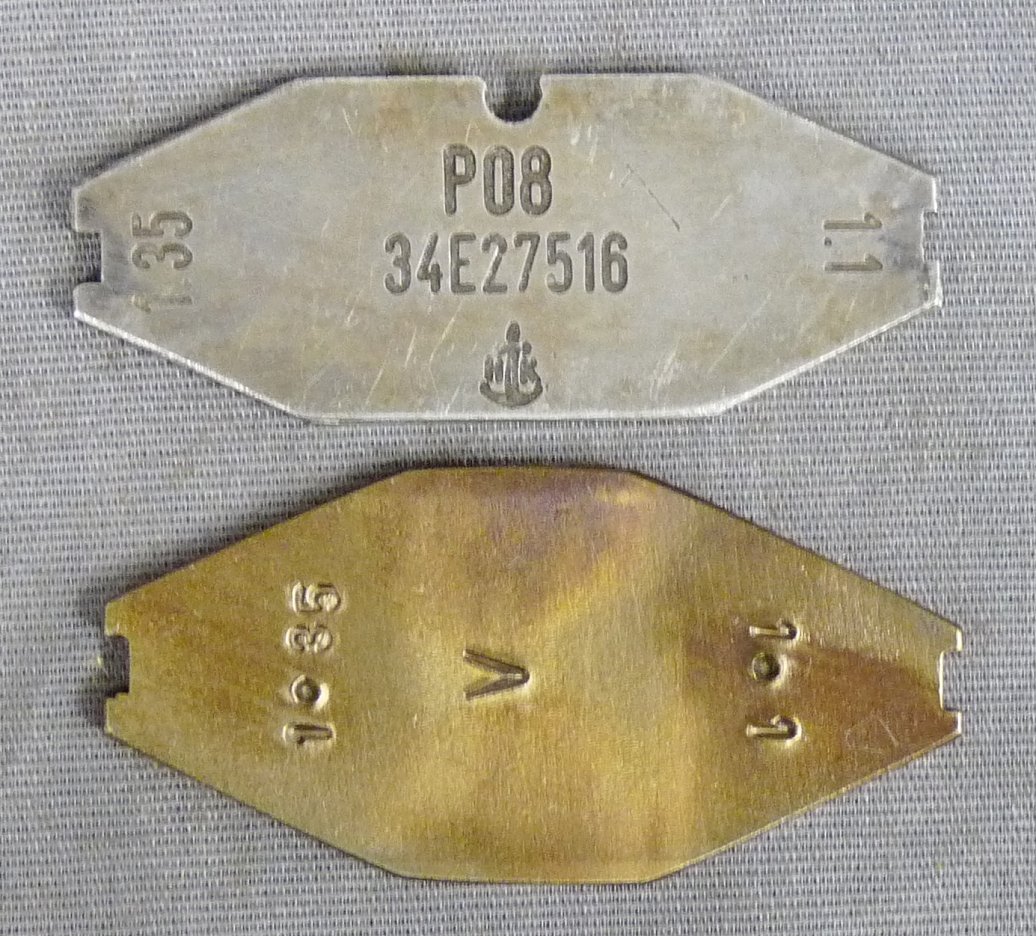

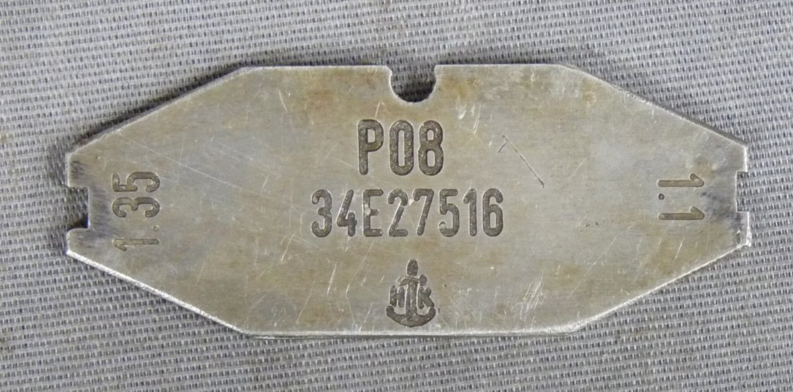

My friend Tim loaned me his Kreighoff gage so I could make a gage for myself.
Thought all would like to see the gage.
Firing pin protrusion from the bolt face specs are between 1.1mm(min) and 1.35mm(max).
The 1.1mm side of the gage is placed against the breech block to the side of the firing pin, the pin must not pass under the cut out; if it does it is too short.
Flip the gage around, and the 1.35mm side should pass over the firing pin, if it does not - it is too long.
A long pin tip can be stoned to shorten it, the tip should also be nicely rounded, not "pointy".

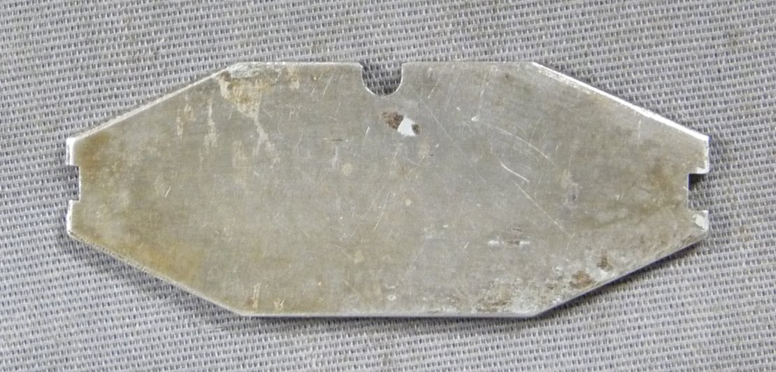

Also shown is one of the gages I made in similar pattern; I chose to "straw" mine.

Don, I don't mean to pick a nit here but they don't look the same?
Is the overall original pattern profile important to inserting the tool into the pistol for measurement? Or is this measured with the bolt out?
What is the round notch at the top for?
Unread 06-26-2017, 09:24 AM   #3
Thanked 4,354 Times in 2,041 Posts
Jerry,
the overall profile is a little different and does not matter, the tool is grasped in the center area- it is only either end that is used. I could have reduced the width with two more milling cuts, but it would have been a waste of time for me; I left "mine" the width of the stock I used. It is meant to be used, not a "reproduction".
It is used with the toggle/bolt out; with the toggle in and back- the striker/firing pin is retracted.
I have no idea why there is a notch at the top, Tim had two HK tools, the notches were in both, but they were different sizes. We surmised that they were a fixturing notch for use in mfg.???
Good eye and good questions; I glad someone read the post!

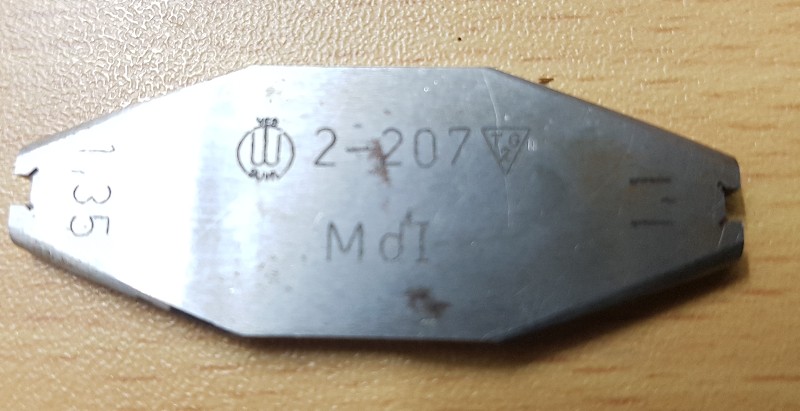

Unread 05-05-2018, 05:46 AM   #7
I have 2 East German ones here. No notch on the top.

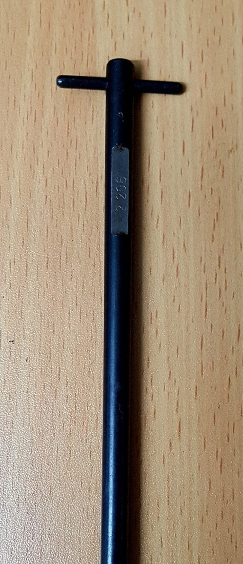

Unread 05-05-2018, 05:51 AM   #8
Note that the firing pin gauge is numbered 2 207.
This chamber gauge, 8.88mm, is numberef 2 206.
