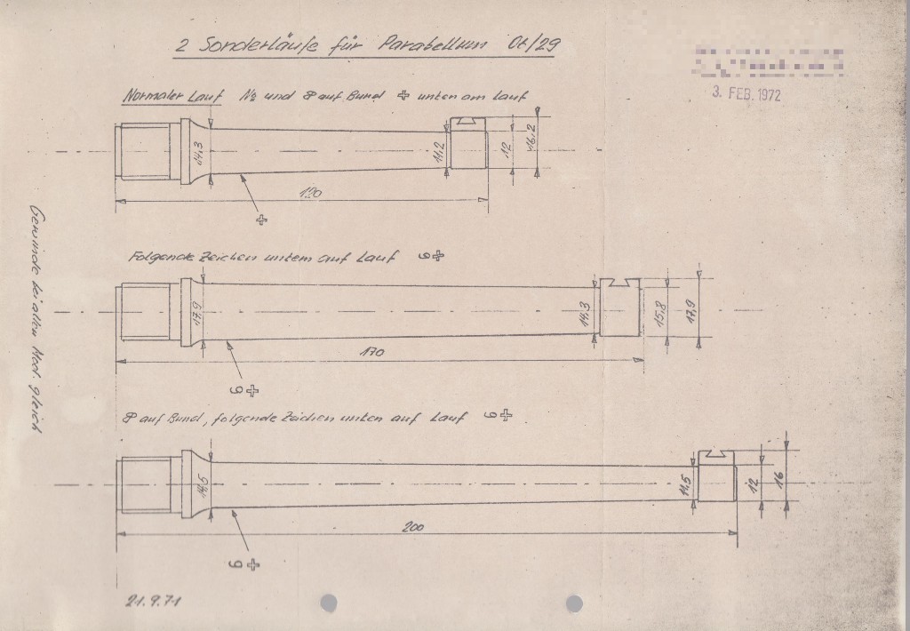

Unread 05-14-2020, 11:53 AM   #10
The last sale of long and 9mm barrels took place in 1972, when Mauser bought the last leftovers.
The following 4 members says Thank You to Vlim for your post:

Unread 05-14-2020, 01:16 PM   #12
Drawing.
