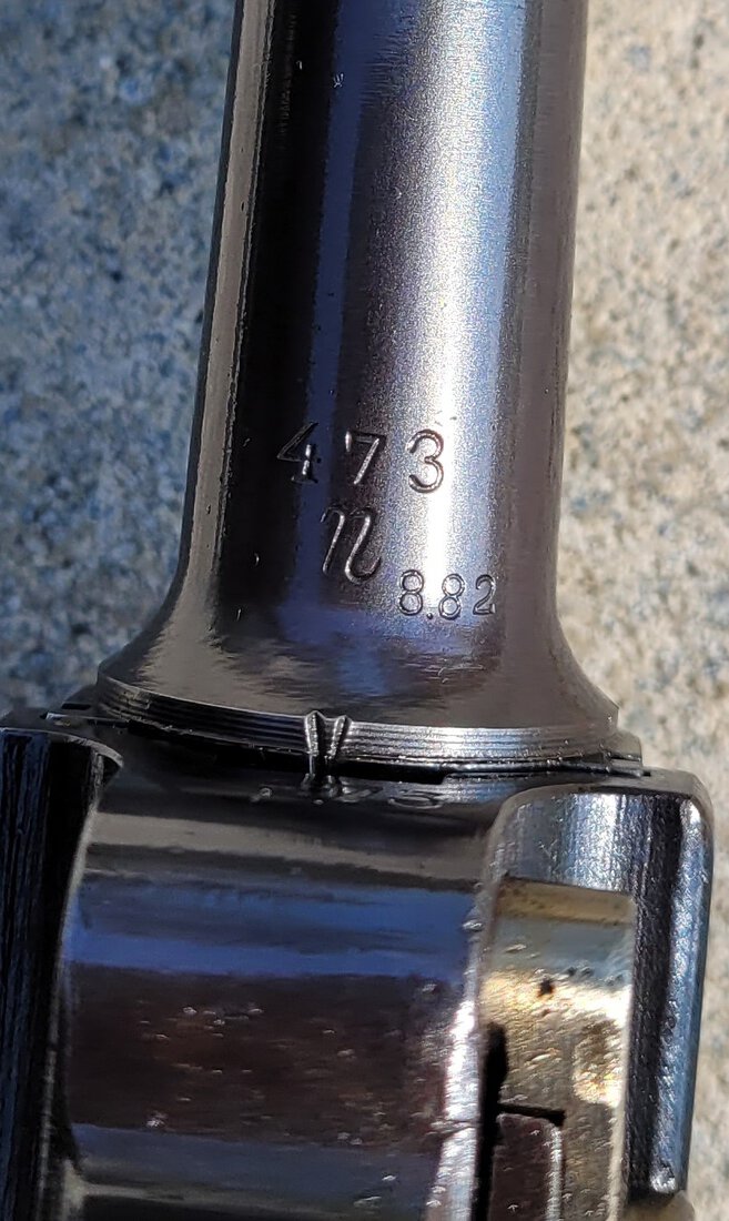

Under the barrel is marked 473n and 8.82

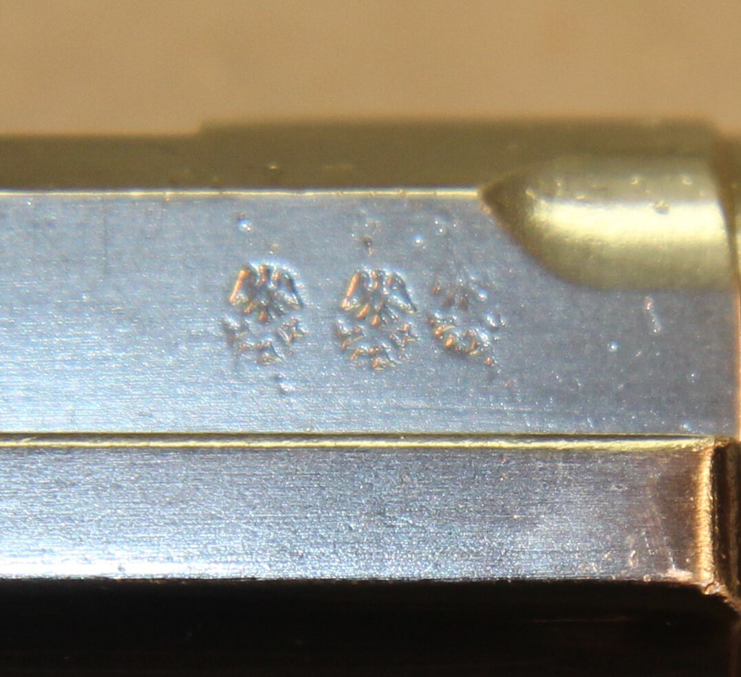

There are three marks on the right side and the same mark on the top of the barrel they are an eagle with droopy wings over what appears to be AA4.

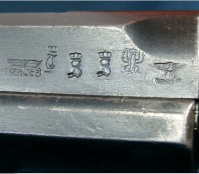

The image below has one on the far left and the right. There are many variations.
The Gothic stamps with crowns (c/T c/S c/S) are the usual military acceptance and firing proof stamps.
The 4th eagle with wings up marks it as an Imperial era luger.

Here is a picture of the marks and underside of the barrel.

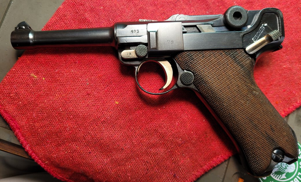

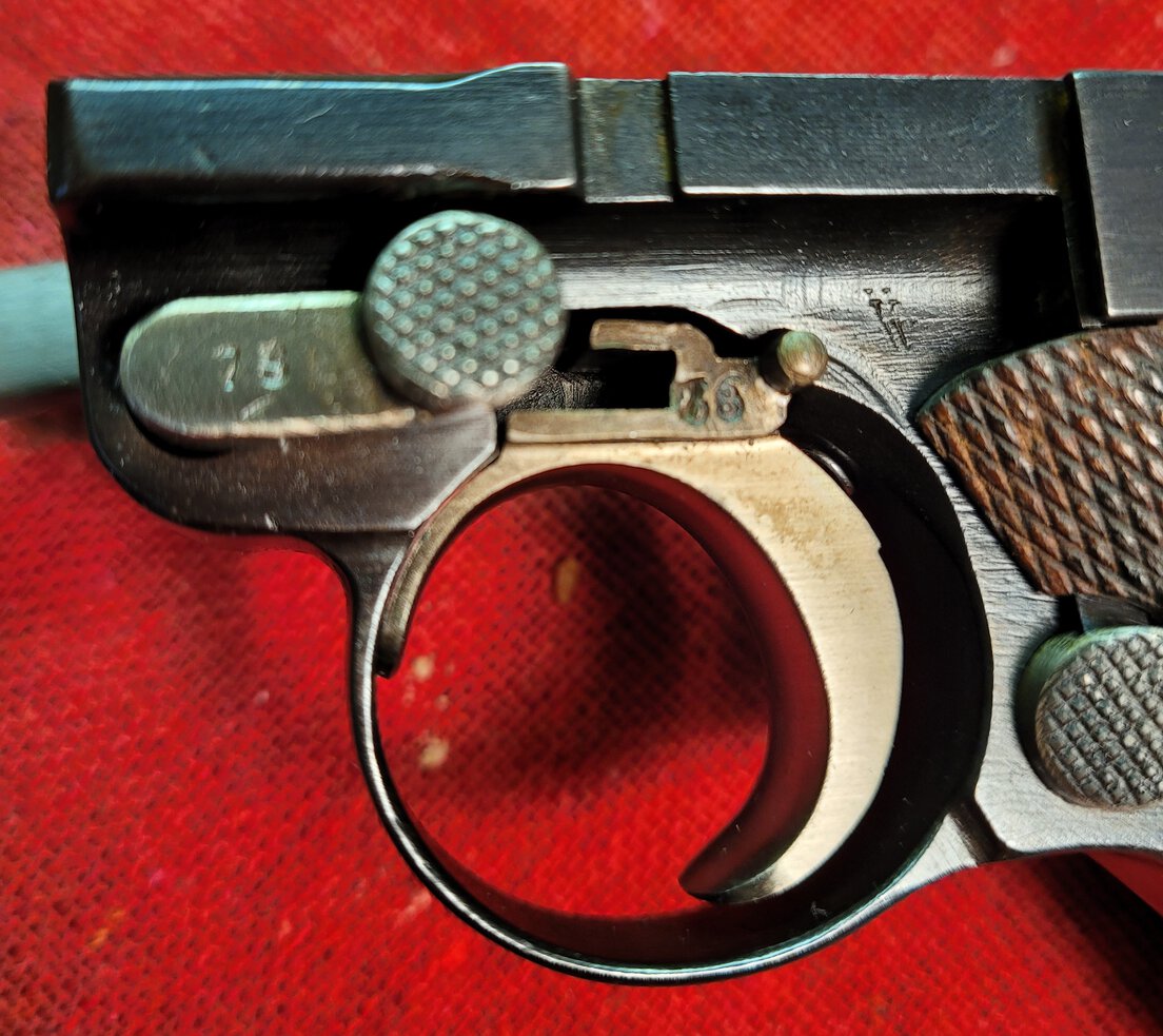

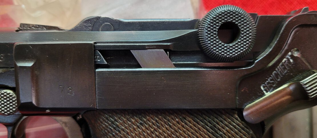

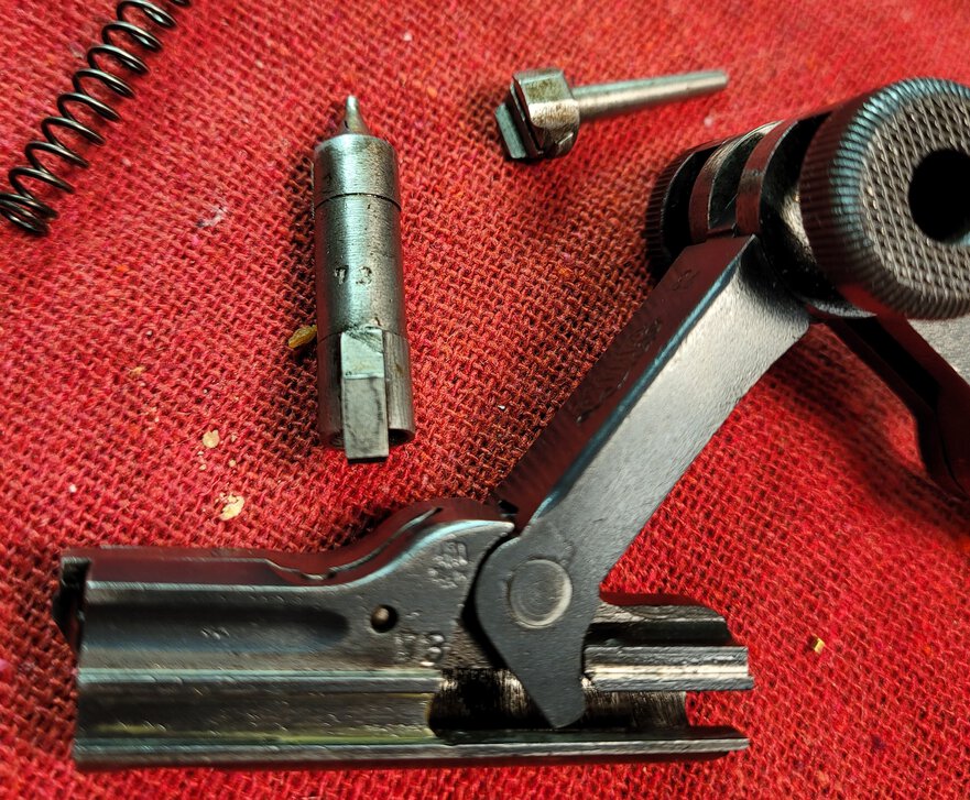

A few more pictures.

These are what I call 'Dove' acceptance and proofs - Dwight dislikes that term. I use it because they look dovie and not eagle like.
They were used 1920 / 1921 timeframe, for both military and police, as the military purchased for the police till the mid 30's or so.
It would have been made in 1920 and not a property marking - see the FAQ on the forum in the new collector area for further information.
And yes, used through the war years of 1939-1945

I don't see any sight of a magazine or sear safety modification, but that isn't unusual for a Police luger.
The small parts that should have straw color look like they retained their finish - they all look really good (locking bolt, trigger, and thumb safety).
The left grip has a very common chip under the thumb safety. It's very easy to do if you aren't very careful about removing the left grip. Some people remove the right grip first and then reach through to carefully lift out the left grip through the magazine well, just to avoid chipping the grip.
I just can't make out the number on the trigger. It appears to have a different number, but I can't make it out.
Congratulations on your photography!

Highlander, that is an interesting and very nice looking Luger. The offset "8,82" is unusual in that the bore diameter mark ia usually stamped directly under the suffix letter.
Barrel length is measured from muzzle to breech face, to include the chamber, with the action closed. Drop a pencil or rod down the barrel until it rests on the closed breech face. Mark the shaft, withdraw and measure. The barrel is likely between 95 ~ 98mm in length.
