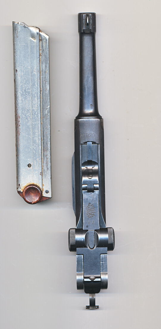

How would one differentiate between a 1920 Military and a 1920 Police? Mine is a 6407n but has no sear safety or any unit markings of any kind, which might suchased that would indicate it to be Police.

The proof marks identify it as military from the 1920 era. While it's possible that it served as a police pistol, without unit markings or one of the two police safeties, there's no way to tell.

IIRC about 50k P08's were made during this time period by DWM (1920-1921). Approximately 40k were sent to the police, making strictly Army pistols rather scarce. Hence the use of a lot of wartime manufactured pistols subsequently stamped '1920' and reissued to the armed forces as well as the police. Good looking pistol.

My P.08 is just like yours, DWM 1920, Dove proof marks, no sear safety or unit markings. I was told it is a Weimar Army pistol.

In 1920 the German Reichswehr entered into a contract with DWM for production of P08s. These are the pistols found with e/ArA4 or e/WaA4 inspection and acceptance, dated 1920 and 1921. They are serialized with no-suffix, a and b suffixes, and anomalous n suffixes. In 1921 the IMKK voided the contract as being in violation of the Versailles Treaty provisions, and production was halted. (Leftover 1921-dated receivers made their way into the commercial production stream.)
This was explicitly an army contract. Unless one of these pistols positively has police characteristics--sear or mag safety, or unit marks--it should be presumed that it entered army service. None went to the navy.
The "1920" property mark has nothing to do with this topic, except to say that it only represents a pistol's existence in army or police inventory at the time.
