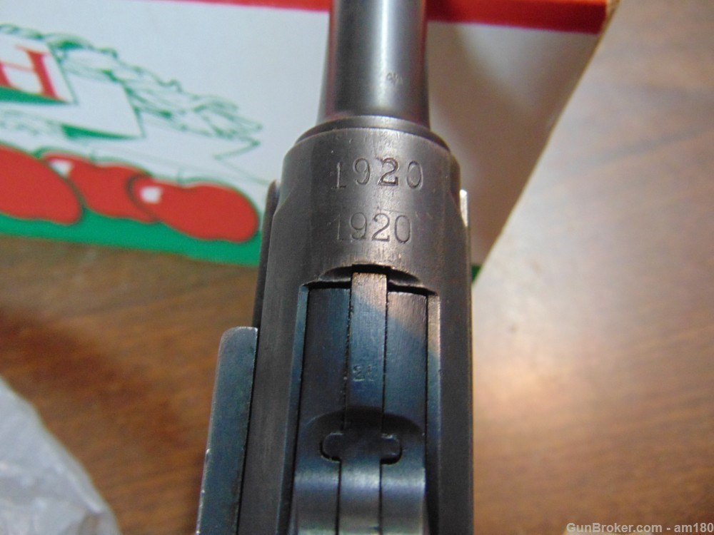

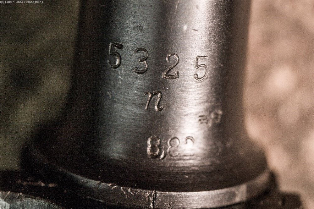

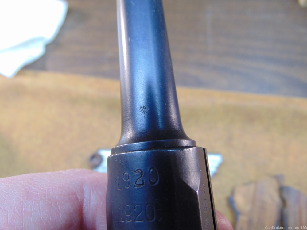

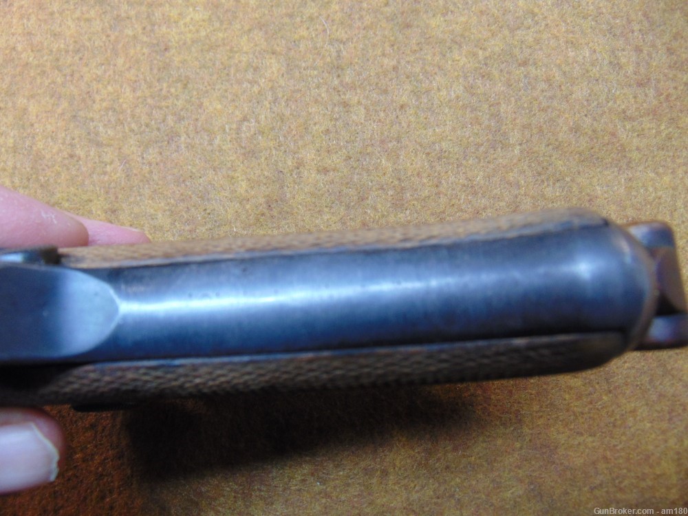

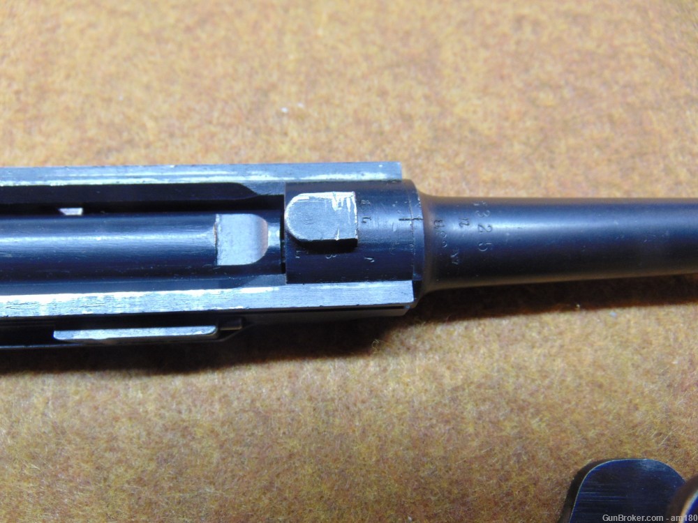

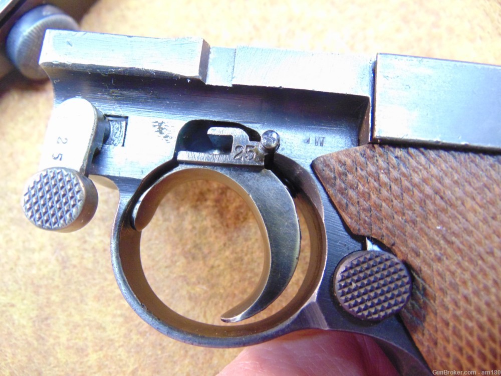

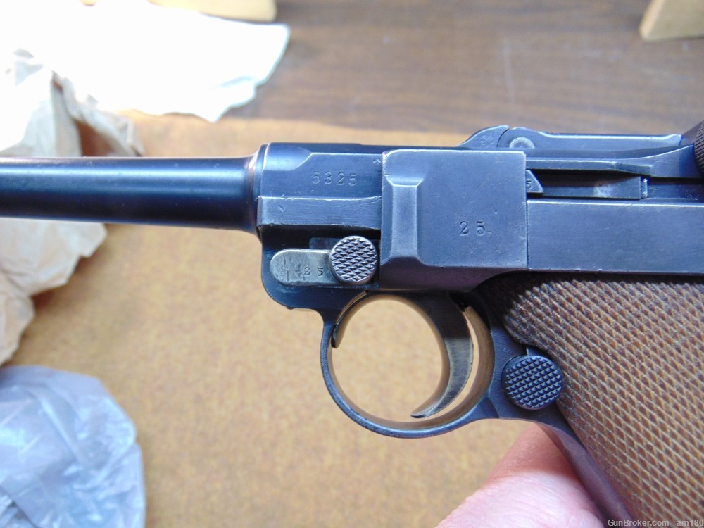

My newly acquired DWM 1920 double date.
1) Serial number 5325
2) Property date (1920/1920) YES
3) Sear safety NO
4) Mag, safety NO
5) yes
6) Police unit marks appear to have possibly been removed
7) Other unusual marks ?

Unread 02-28-2024, 10:50 AM   #47
Daniel76
Join Date: May 2021
Posts: 45
Thanks: 84
Thanked 125 Times in 34 Posts
It is an HzA reworked gun. Very nice. Matching magazine?

Unread 02-28-2024, 11:41 AM   #48
RoyalTermite
RoyalTermite's Avatar
Join Date: Jan 2014
Location: Kennett Square. PA
Posts: 66
Thanks: 42
Thanked 60 Times in 22 Posts

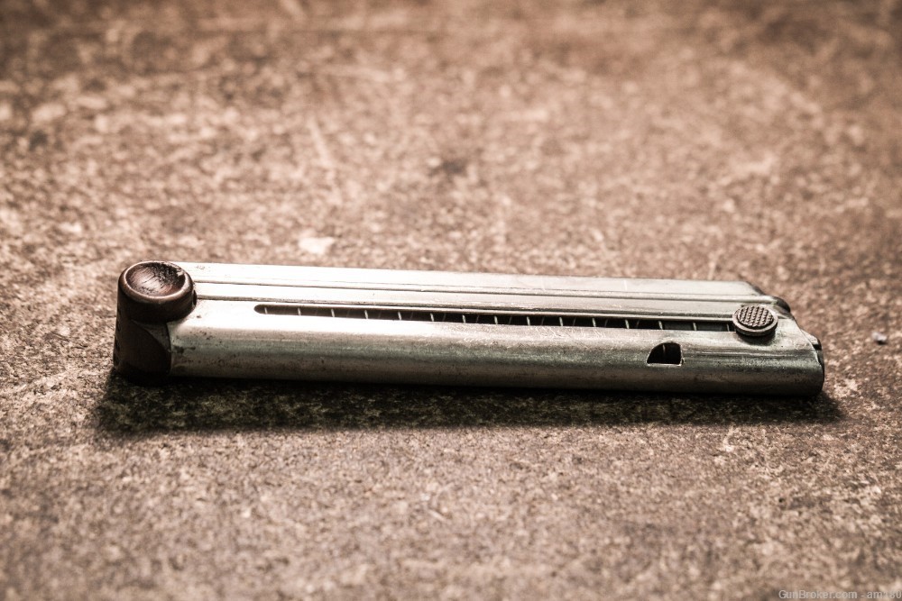

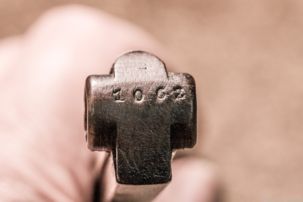

Serial # is different but correct for the gun.
