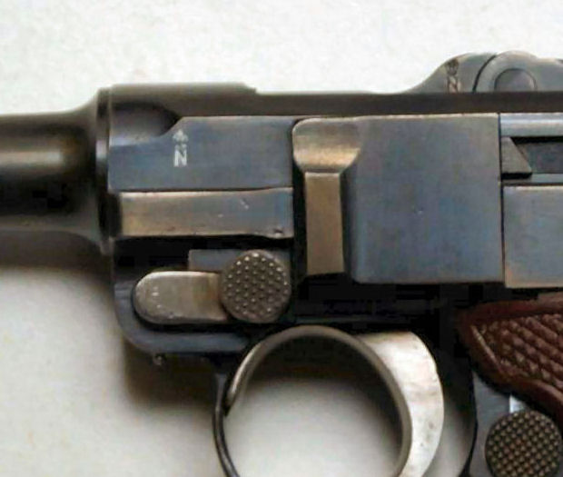

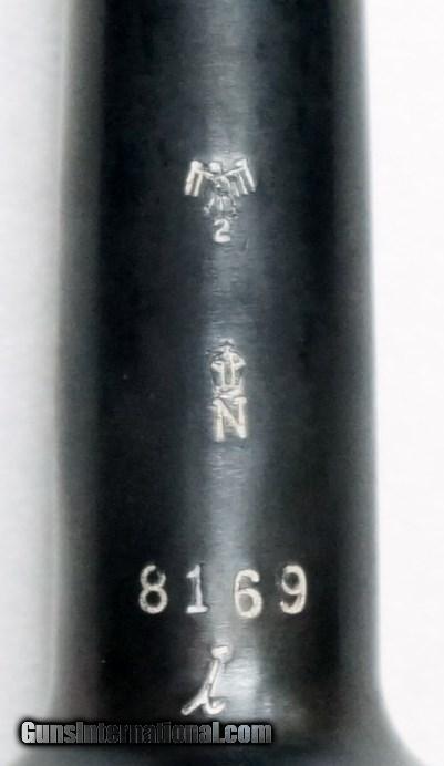

The C/N appears in vertical form on receiver. The C/N also appears on the barrel followed by an Eagle 2, followed by the S/N as 8169 i

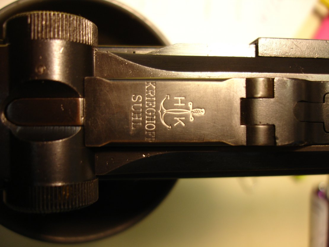

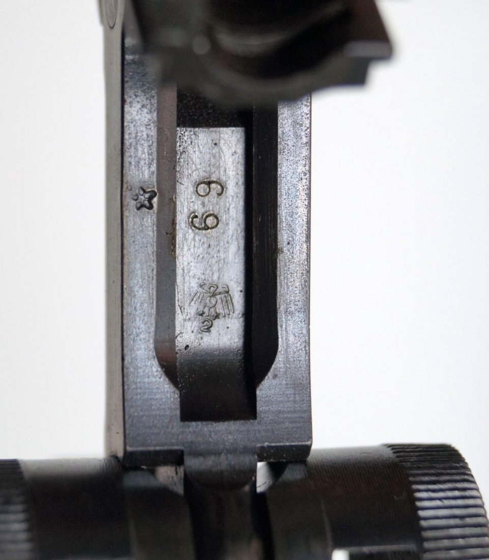

Toggle has H/Anchor/K and Krieghoff over Suhl, on top, with Eagle2, "69" and 5 pointed star on underside;

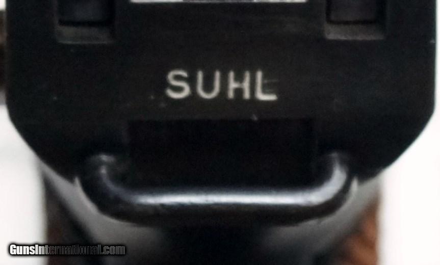

Rear of frame at lanyard loop has "SUHL" (not Krieghoff Suhl)

Gentlemen,
Attached are some photos of the mystery gun - some may be repeats - apparently some phots were too "large" so I had to do one at a time
The "description" uploaded is a summary of my observations of the gun, and where possible, the gun was compared to photos in Gibson's book with page references, etc
Thank you for your input and you interest
Cordially Mike

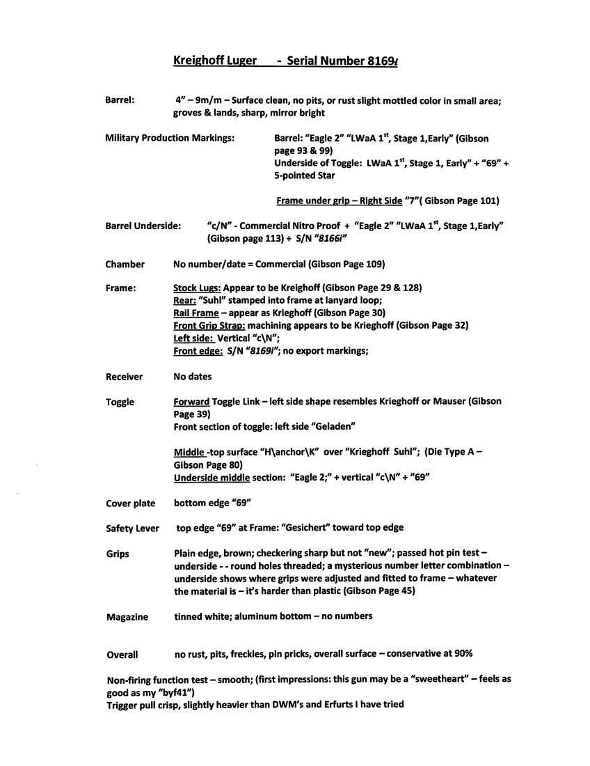

Attached are my observations of the mystery gun
Where possible the gun was compared to photos in Gibson's book Page references are given
Thanks for your interest

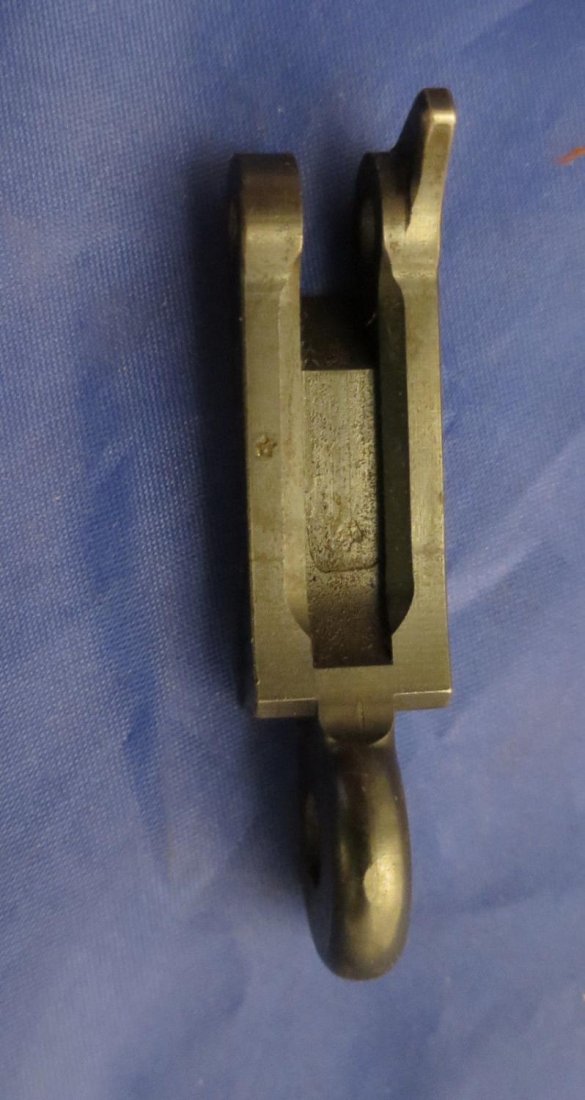

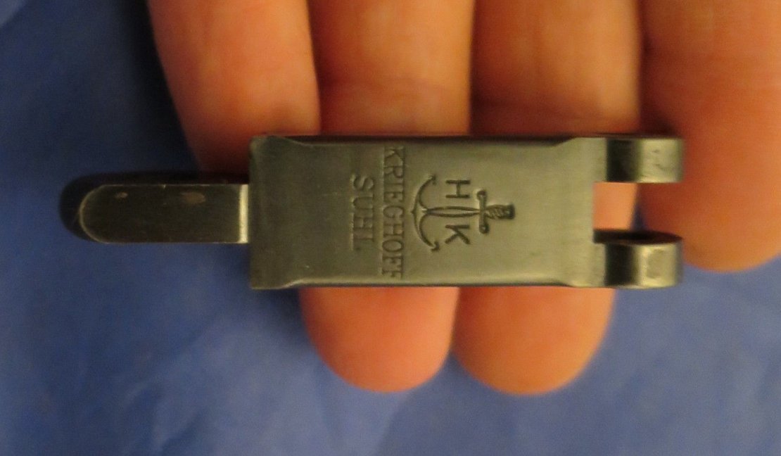

Frame is definitely not HK and the gun looks to be a DWM . See following pics of stuff out of MN and you may see some scary similarities . The barrel proof is an old fake many call " stork legs " or " pterodactyl " . Sorry and I hope you didn't pay a huge price . Dave
Name:	revshop HK toggle 2.jpg
Name:	revshop HK toggle 1.jpg

Don't know much about Krieghoffs, but I can say that the frame is DWM.
