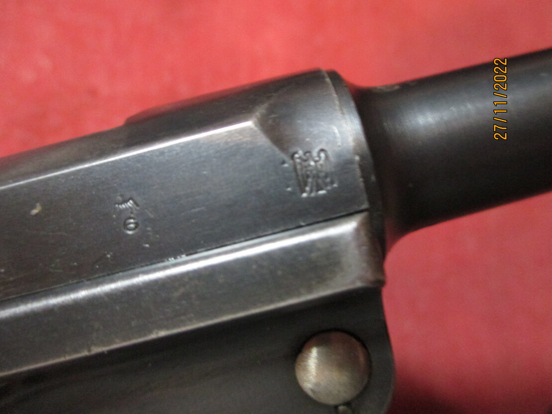

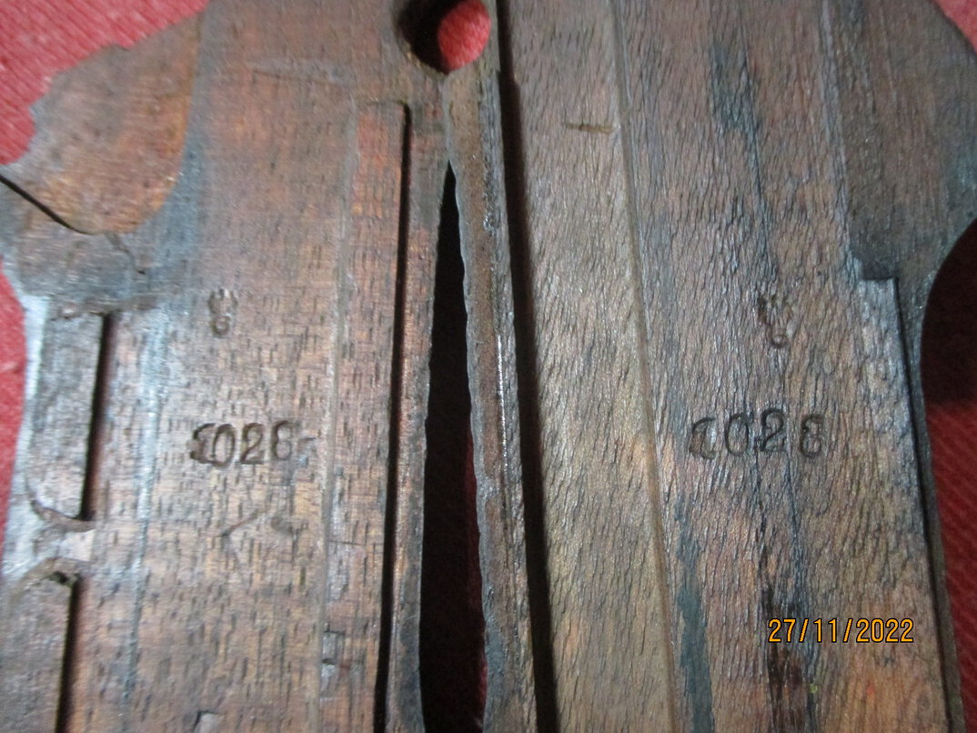

Acquired a Simson undated P-08. Mag safety,(clipped) and sear safety. Sn 1028a. All the parts are acceptance stamped E/6, except the trigger and one grip screw which are E/33. The trigger is sn matching. Only a single E/6 acceptance on the right of the receiver, and a single E/6 on the stock lug. Matching mag E/6 heel, toe and spine. Photos attached.

1028a is an anomaly ref the single E6, although 1014a is marked the same and a couple of others.
0836a E6 E
0846a E6 E
0863a E6 E
0874a e6 E6 E
1014a E6 E
1028a E6 E

I thought it was odd that it only had a single e/6 at the bottom of the stock lug.

I actually meant on the right side of the receiver, but you are also correct, finding no marking makes me think its a replacement frame. 2 is the most common, but I have seen / heard of a few only having one.

It sure looks like it was all "born together" on close examination. The fonts on the SN top and bottom match up nicely. But, I wasn't there when it was built, so who really knows?
