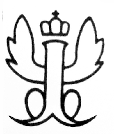

The Imperial era is 1900-1918 (Germany is ruled by a Kaiser)
The Weimar Period is 1919-1933 (Between the World Wars)
The NAZI period is 1934-1945 (Hitler)
The Spread winged eagle was used from 1939-1945.
Below is an Imperial Eagle
