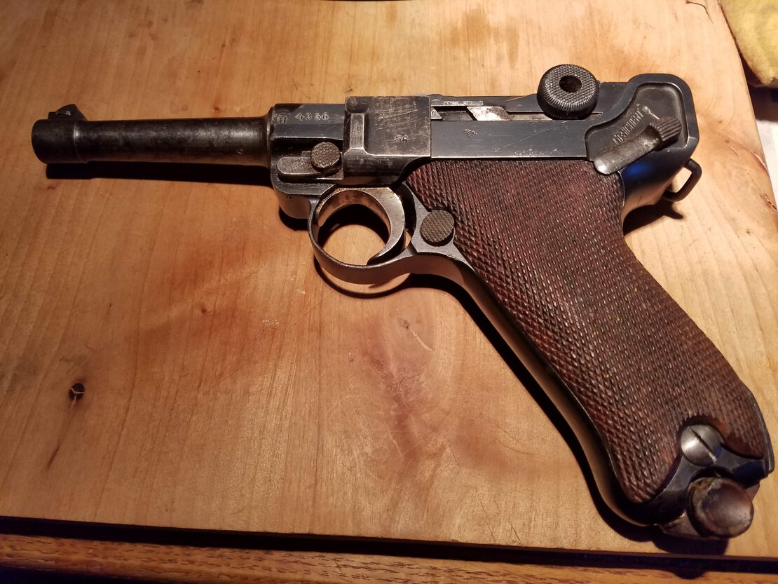

Hi, Luger Forum people! I have an old Luger that shoots well after I replaced a spring on its extractor mechanism. I think about having it refinished now and then, by an experienced quality gunsmith for these. Can you enlighten me on how the value will be viewed for this gun by collectors after a quality reblue?

Dear Gerald,
Welcome to the forum. Your photo is a bit dark but from what I can see the Luger appears to be in fine condition. I do not see an advantage in refinishing the gun, and it would significantly reduce the value. Moreover, from the strawed (yellow) parts (trigger, mag release), the gun must have a "cold" rust blued finish rather than the "hot" salt blued finish typically used on modern guns. In short, I advise you to leave it as is.
I encourage you to post more photos.
KFS

Welcome to the Forum, Gerry.
You have a nice luger - it looks interesting.

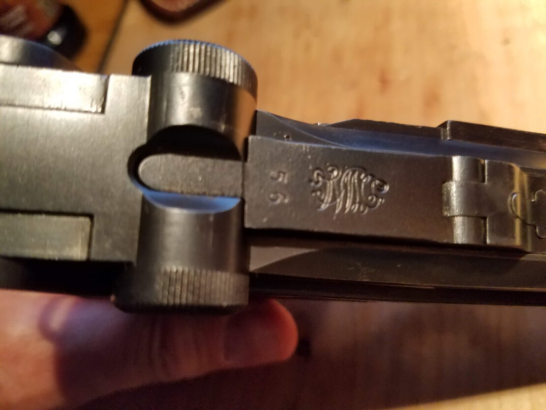

I'd love to see the rest of it - particularly the mark on the rear.

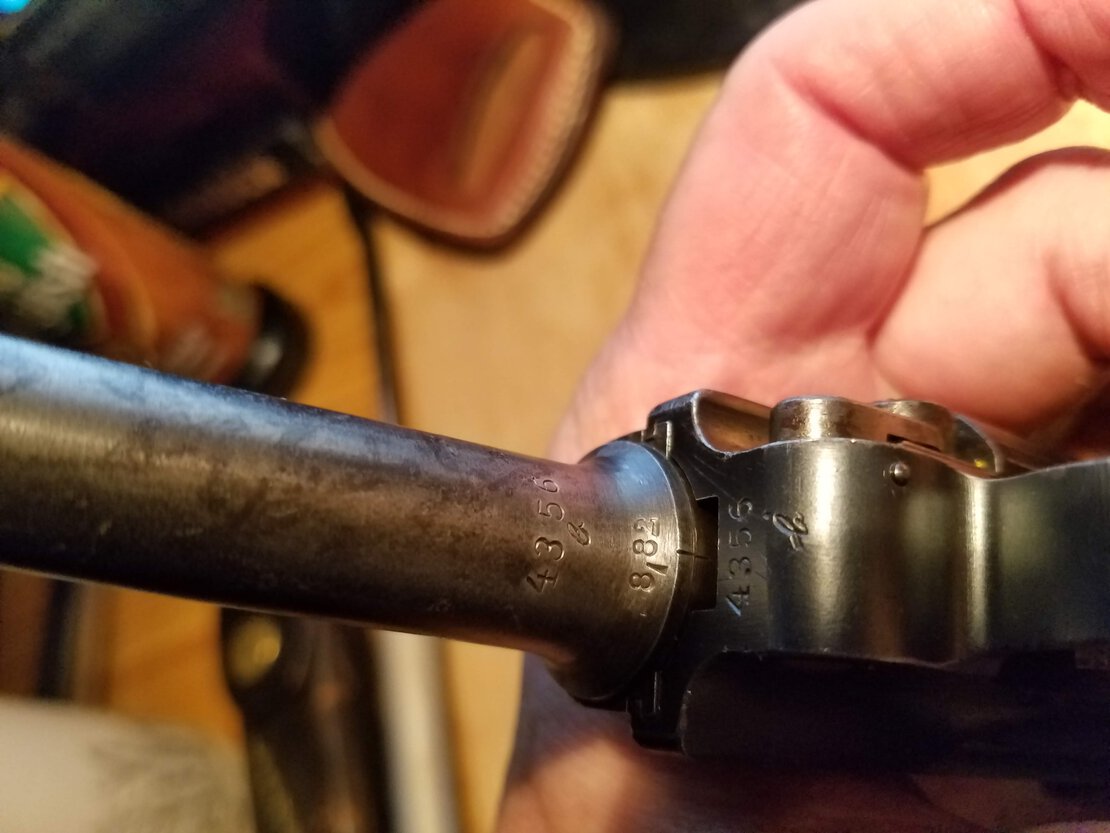

Thanked 1,767 Times in 584 Posts
More pictures, especially of all markings, would help us give you more information. You don't mention caliber but the barrel mark 8,82 says it's 9mm. From what I can presently see, it's an Imperial German military pistol that has had the date removed but is otherwise pretty much as-issued.... except for the stamp on the rear of the frame. That is most assuredly not original to the gun when it left the factory.

I think it would be a sin to re-finish this Luger.
Plus done properly by someone who knows what he is doing would be costly.
Done improperly by someone who doesn't know what he is doing could be even more costly.
Bottom line you would be placing your #'s matching, possibly 'collector' class gun permanently into the 'shooter' grade class at best.
The stamp on the end of the receiver adds 'uniqueness' and would be interesting to research ... fun gun.
Your pictures present a Luger that I would be proud to own and enjoy.

This is an interesting Luger. Closeup pictures of the left, right, and top of the receiver would be useful in order to completely tell you what you have.
