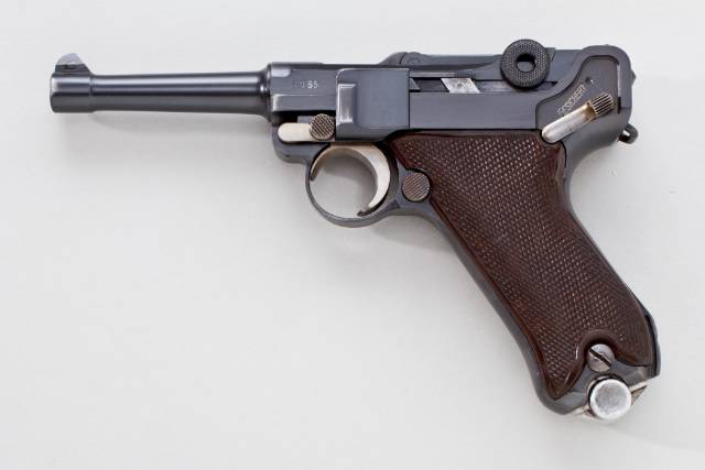

I attended the auction. It's seems every luger had a matching magazine, which always bothers me. Here's a 36 Krieghoff. Look at the machining marks on the chamber. They don't show up as well in the picture. Krieghoff Lugers were of the highest quality. Has anyone seen marks like this on a Krieghoff?
Look at the top of the side plate, it's rounded. Krieghoffs are square.

I agree that the side plate is questionable but the receiver and machining marks are fine.

Given the fact that HK's are very expensive now, the invitation and temptation are there to boost and even convert them. This just challenges the mettle of the potential buyer. Again, one has to hold the piece in the hands to best tell. And of course, the more one has seen, the more variation will be found accecptable. Matching magazines are showing up more now, in my opinion, as prime items are emerging from old collections. That said, if one considers all the many thousands of lugers out there, most of them have non matching magazines.
Unread 07-03-2010, 11:49 AM   #9
I have seen these chamber machining marks on other Krieghoffs, and only on Krieghoffs. In my opinion they support the authenticity of this piece. Regards, Norm

Default is the artwork on the receiver of hk's always this misaligned??
with such precision in manufacturing the piece, the easiest task on the weapon is the engraving.......

Tom's question is understandable. One rarely sees HK's stamped like this. But overall this appears to be a genuine article Krieghoff. Despite the image of correctness (obsessiveness), things like this do get through.

I'm not quite sure why you are focused upon the OUTSIDE of the side plate? It's the machining marks INSIDE the plate that will tell if it's the "real deal"..
Best to all..!
