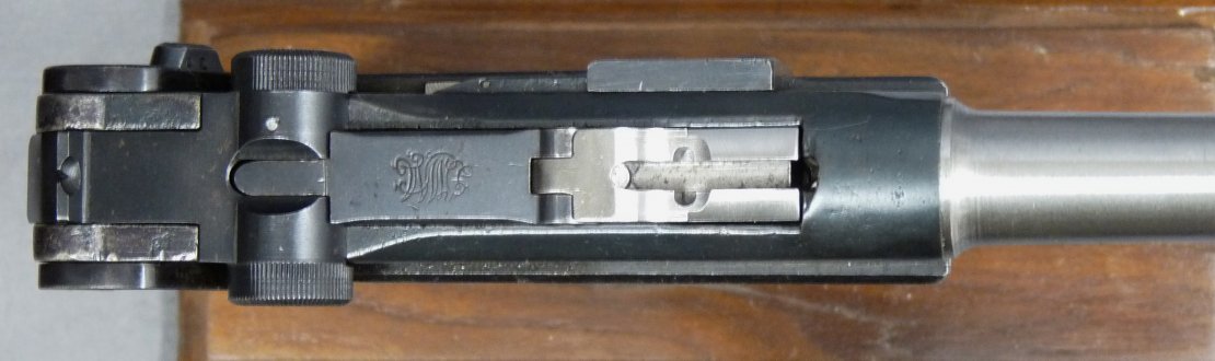

Lightbulb New project: Luger re-barreled to .45 GAP
I got a 5" .45 GAP barrel with .45 size breech block a while back from Ed Tinker, made by "Lugerman".
It was un-chambered but threaded and in hopes of ultimately being able to design a magazine/feed device , I chose to chamber to the shorter .45 GAP cartridge.
Barrel took a little tweaking, GT re-cut the threads to deepen them to fit a well used and ugly receiver I had for the project. Thanks GT.. He finished it this past week and I spent the weekend getting it to the single shot test stage it is in now.
Fired it today, twice, worked fine. Had no extractor or ejector at the test firing, but as it went well I have added them this pm and will test their function as the next step in "development".
The design and implementation of a feeding device will take some thinking and time, as the .45 is too large in diameter for a typical magazine- will likely use the opening itself as the body - with some sort of feed lips added to the frame. Or not. I'll be re-studying the pictures of the way others have approached the challenge. Ideas welcome!!!!
Some pictures of the pieces and project are below.
When fired today I used a 42 vintage Mauser lower. the "tape" test compared with a 9mm shooter is shown, the .45 is on the right. Also shown with a 9mm G Date Mauser for size comparison.
Recoil was noticably "stronger", not sharp like a 9mm but just "robust"!

That is one option; usually that only works with a double stack mag though. There just is not enough room in the luger mag well.
Some folks got around the problem and there are single stack charger loading pistols, usually the feed lips are hinged or springy so the rounds can be stripped into the body.

Eugene solved the magazine problem by up-sizing the entire frame; i.e. he made it bigger!
So there is room for a "real" magazine in his new made pistol, which is a little larger in all dimensions than the norm.
He may have kept some of the operating parts the same size, like striker, safety- but I don't know for sure.

Lugerman , Eugene Golubtsov, made the breech block and turned the barrel.

Update 8-8-2017
Just back from the range, still single shot ; BUT extracts and ejection is fine! Hold open works, so makes it fairly easy to load one round at a time.
Now if I can just "figure" out a magazine!
