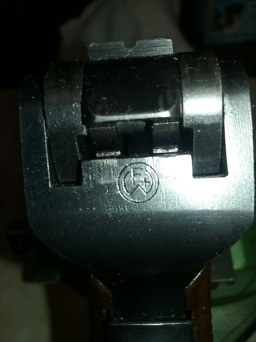

Learned gentlemen, here are my questions. I have a beautiful 1929 Swiss Military Lüger and I have found all the necessary references to identify it in Aaron Davis's book "The Standard Catalog of Lüger", page 157. Number fits.
But there are 4 discrepancies:
What is the mark on the back of the receiver?
Is the mark Left Front that of colonel Muhlemann?
Why a "P" on the front of the receiver?
Why a U notch when all the litterature tells of a V notch?
I am relying on your exoertise to enlighten me.
Those questions aside, it shoots beautifully and has a trigger of almost Benchrest quality.
Thank you in advance.

I can give you a start, Phillipe.
The P is stamped on pistols that were decommissioned from the military and made available for Public sale.
The U notch strikes me as something the Swiss may have done to improve the traditional, crappy sight picture, IIRC.

Phillipe,
I can add a little more information from my own research following my purchase of a deactivated 1906/29 Swiss Luger a few years ago.
The mark on the rear of the receiver is the 'Waffenfabrik' Bern marking.
The ‘M under cross’ is the proof of proof of Maj. Mühlemann, who was the factory inspector between 1913 and 1941.
I read that if a soldier elected to keep his firearm upon his retirement, before the weapon was released by the Swiss Military they were refurbished by the factory and stamped “P”, which on my example is stamped on the right-hand side of the frame.
The frame well of the 1906/29 were also stamped with the date of manufacture, month and year (two digits: MM.YY) on military and private sale pistols up to 1943.

Thanks to both of you; I had an inkling about the P and Muhlemann but I didn't know about the Waffenfabrik mark. I haven't found theMM/YY yet but will look for it.
