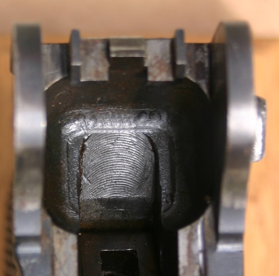

Here's a very quick study on the tooling marks found on P-08 and LP-08 Luger frames.
It's clear that the toolings built by DWM and by the Erfurt arsenal were different, utilizing different milling techniques.
The DWM Equipment that went to Mauser used the same milling technique.
The Erfurt Equipment that went to Simson used the same milling technique. I expect that Krieghoff frames would show the same.
Here are the photos in order of year of manufacture:
I wonder what the Swiss and Vickers tooling looks like here?

Nicely done, good pictures, although I had a heck of a time trying to figure out where it was taken (I can see the ears, but wheres the mainspring?)
The first Krieghoff markings would be the same, until they had used all the parts; krieghoff always stated that they made their own tools (see Gibson)
There is NO vickers tooling, since they were DWM parts?

Ed, Here's a wider view of the Erfurt...
The recoil spring lever is just below this area...

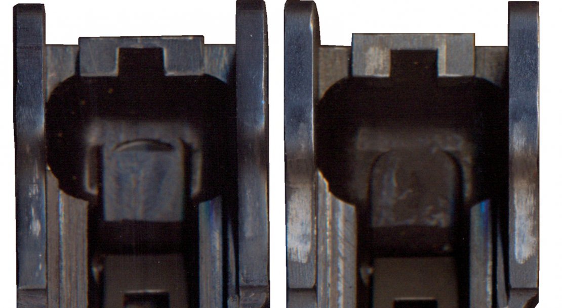

Post-war Mauser Parabellum on the left,
Swiss 06/29 on the right.

Looks like the Swiss tooling used a round tool for the cut like the DWM tooling. Is the area above the rounded cut flat or curved up to the back wall of the frame?
The post war Mauser (1960s-1970s?) has the more regular and uniform look of CNC equipment, possible a mill that can change tools automatically.
Interesting that the rear of the receiver is flat, lacking the two vertical inner "ears", in both the late Mauser and early Swiss.
Was the post war tooling based upon the Swiss design?

The Swiss 06/29 curves upwards. The center of the milled out portion is marked with the SIG logo (as SIG produced these frames).
CNC tooling was not used during the post war Mauser production. The cutouts were made by several horizontal and vertical milling/cutting machines. Although the drawings and jigs were based on the Swiss design, all tools, jigs and production steps had to be redone, because of differences in standards, calculations and production methods. Only a handfull of Swiss jigs and gauges found their way into the Mauser production process.
Mauser used relatively standard cutting, drilling and milling tools for the job.
The deletion of the two vertical 'inner ears' makes sense. They are completely pointless anyway

"It's clear that the toolings built by DWM and by the Erfurt arsenal were different, utilizing different milling techniques."
"The Erfurt Equipment that went to Simson used the same milling technique. I expect that Krieghoff frames would show the same."
Actually it looks like the difference is not in the tooling, but in the order in which the final milling strokes were made. DWM practice appears to have been to finish the sides and back inside the frame first, then to make the final center routing stroke.
Erfurt practice seems to have been to make the center routing first, then finish the sides and back, intersecting the upper arc of the center stroke. Considering the origin of the Simson tooling, the similarity of machining makes sense--one can imagine the instructions for use coming along with the tools.
Actually, the rear frame Krieghoff finishing follows the pattern of DWM.
