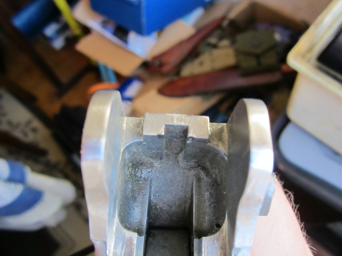

Hello, I just bought this frame to make as shooter. I need help to identify this frame? I will post pics of the rear, front, markings, tooling. and frame.
I also need the top barrel and extension with complete toggle. if anyone has one hopefully a mauser top.

It looks like Mauser's work to me. Frame doesn't have the "hump" so it's likely earlier than 1938, and most likely early 1937 since there are strawed parts.

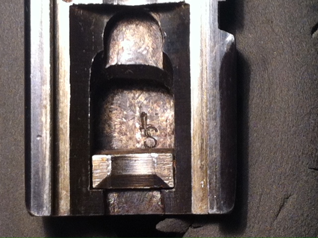

Interesting study .... It would appear DWM center cut was done with an end mill with an upright mill while the Erfert was done with something like a key way cutter, on a horizontal mill
KABAR2 is offline   Reply With Quote
Unread 09-22-2016, 07:52 AM   #11
CJS57
Join Date: Nov 2011
Posts: 224
Thanked 81 Times in 41 Posts
Can anyone explain how Erfurt machined the blind ended square cutout shown in the very first post? The DWM circular end mill process is obvious. But for square corners like Erfurt, a square broach usually needs to go completely through the workpiece?
Unread 09-22-2016, 08:27 AM   #12
Likely used a key-way cutter , horizontally from the top inside;
sure what the marks look like.
The apparent square cutout is an illusion caused by the lighting. The square end of the cut actually stands proud of (above) the milled out area behind it.

The picture is on page 1 and post #1 of this thread. It is the second picture down by the OP and it is labeled 1917 Erfurt P-08. I see no tool marks at all in the square cut out. It does have the letter U stamped in it.
Tool marks are not evident in the Erfurt picture, maybe due to age/rust/or refinishing; look at the Simson picture with the same square edge cut- the tool marks are very clear.
Simson received the tooling from Erfurt for luger production.

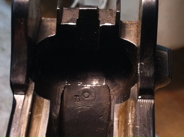

Fascinating history! The 1928 Luger has tool marks that demonstrate that the machining was done with a "single point planer". That is why the tool marks are linear. The 1940s Luger has tool marks that indicate the tool was rotating but I wonder if the tool may not have been a "single point" tool rather than and endmill type tool as the marks are not all concentric. It almost looks like the tool got dull and gouged into the work there.

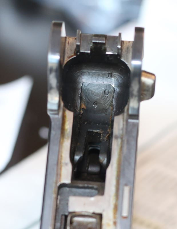

I have the lower only and was wondering if these marks might help identify when and where it came from.
