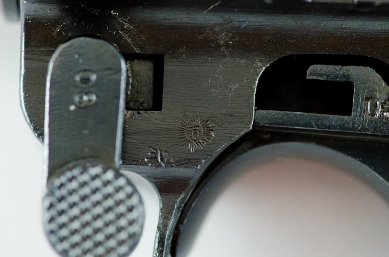

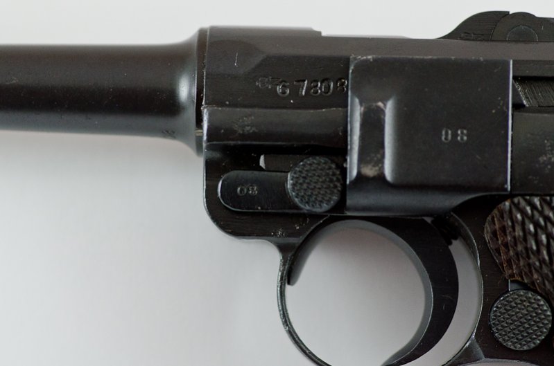

Got some pictures taken of my P08. This first one is a close-up of the "mark" I would like to identify. There is also another "mark" to the lower left of it, but it is almost incomplete.

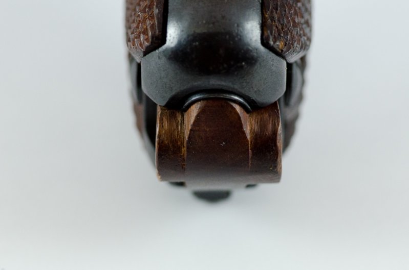

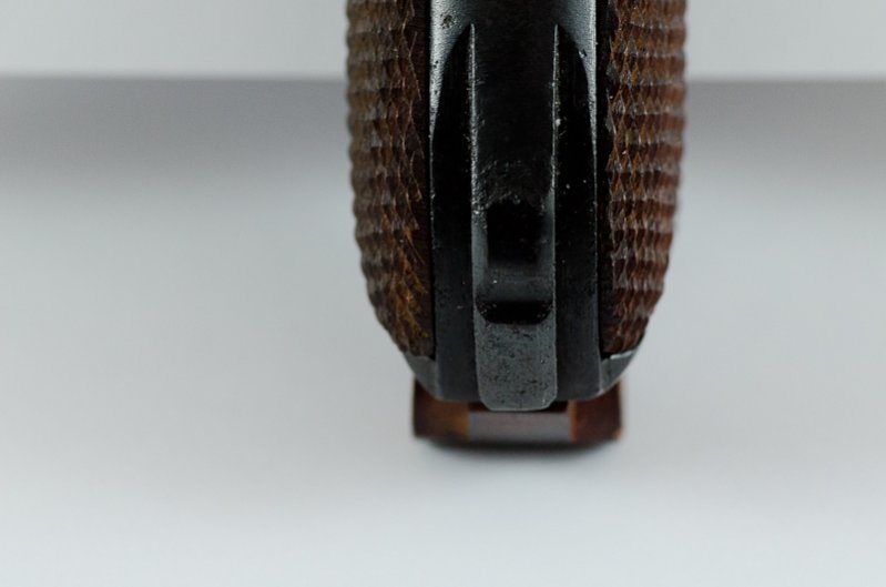

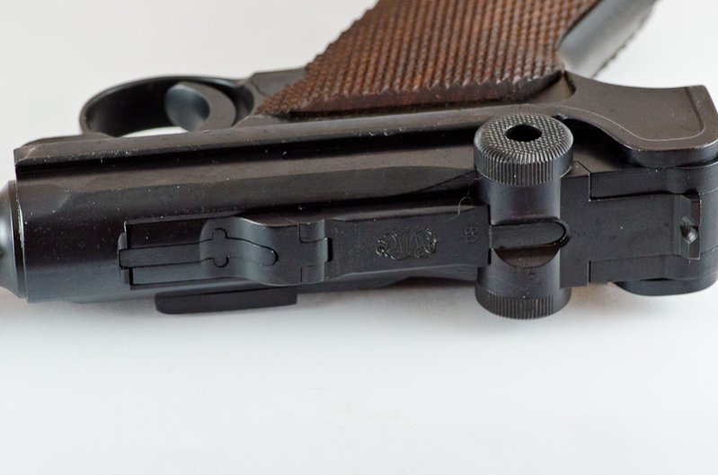

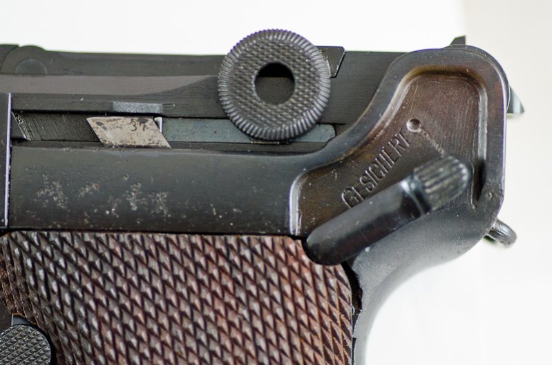

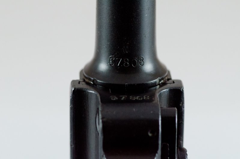

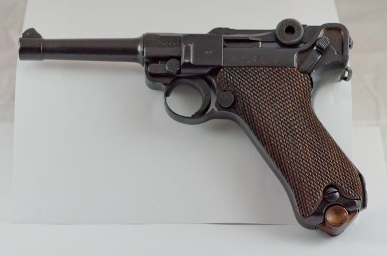

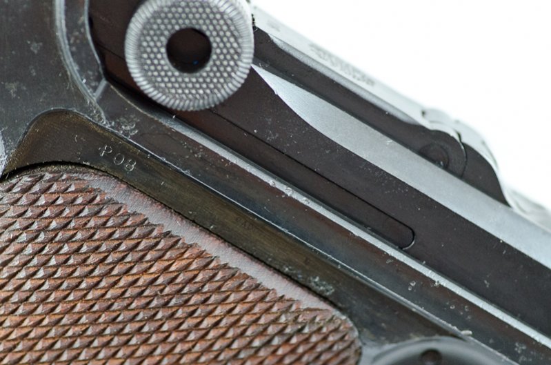

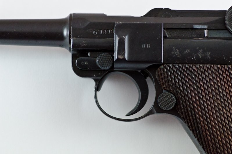

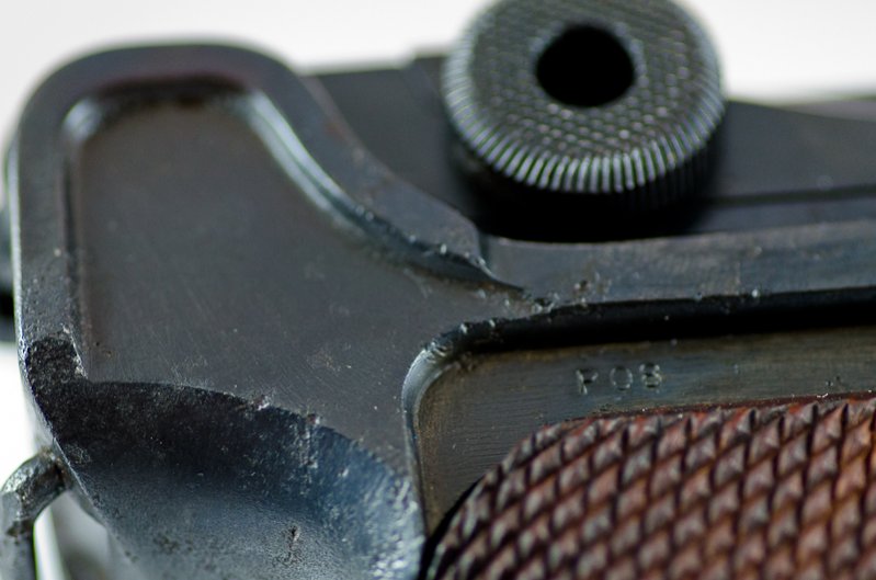

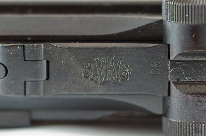

Here are additional photos of this item. I really look forward to hearing from those who might be able to give me some information about this particular piece.

East German rework imported by Sarco back in the very early 90's. Nice! I would bet that someone changed out both the grips and magazine on yours somewhere along the line. It also looks like they tried to obliterate the importer stamp and cold blued over it. IIRC, they sold for $475. I bought one and have loved it since!

the sunburst is a vopo mark and the other is a rampant lion.....Bulgaria and Spain and England use them but I am unclear as to the origins, uses , and explanation of rampant lions.
shooter grade 400-700 if its 30 luger lower end, should have had the bbl changed to 9mm if east German reworked.
