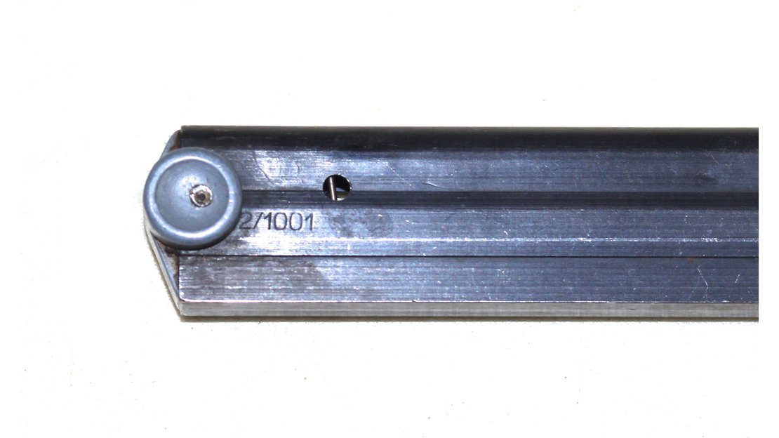

There are so many!! I forgot whats the hole for?

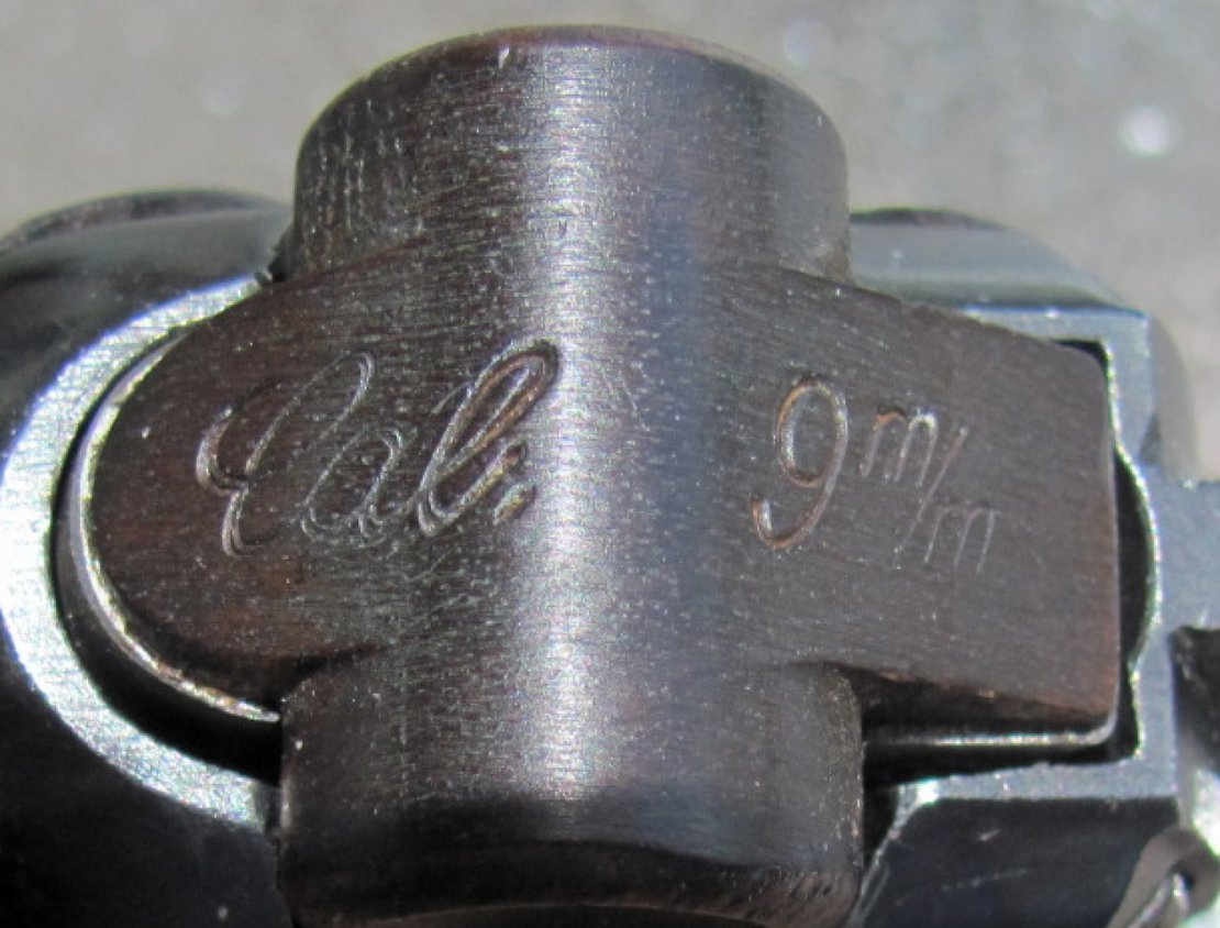

For what year or years did the issue the 9mm /cal marked?

GT, Thanks for your explanation of luger mag tolerances. As you should have rememored by now: the hole shown on the left side of your VOPO mag and on most other types of PO8 mags, is to allow you to drive out the staked in follower button from the follower for removal. If you find an early type folded tube mag body without the hole, it should have the follower for the SCREW-IN type follower button. I've only run across one of those in 50 years, dealing in luger parts. TH
