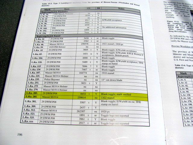

Default Both holste a luger fall with his tables
Im posting 2 pages whose tables fall right in my originals, Holster 'L.M.28. Luger L.Ka.124!
