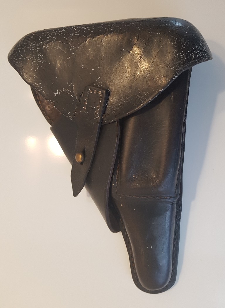

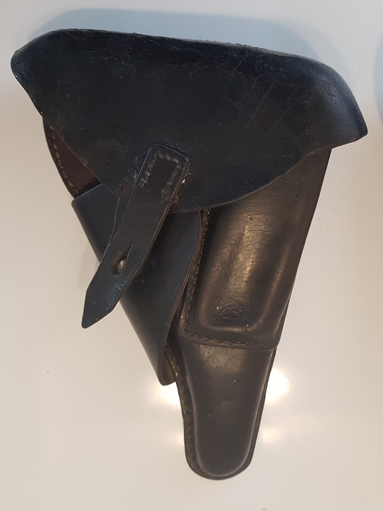

I have used a hair dryer in the past to apply heat to holster to kill mold. Works well.
Since I have my own oven now, I revisited an old advice and tried it out as follows:
Oven preheated to 212f / 100 Celcius.
With the door open, placed holster on the rack.
Observed the holster and watched the mold slowly disappear. Then turned off the oven and let the holster cool down in it for a few minutes, then removed it.
Nice leather smell, not too bad.
I could have given it a bit more, but since this was the first attempt (and a rare holster) I was a bit more careful.
Think I will apply some more heat to the inside with a hair dryer.

Do you give it a stiff (or gentle) brushing afterwards? Apply any leather dressing?
Unread 05-23-2021, 10:14 AM   #3
Nope. Just as they were before.

Thanks Vlim ... roughly how long did you leave your holster in the oven before the mold disappeared then letting it cool off ??
Unread 05-23-2021, 03:11 PM   #5
Less than 10 mimutes. Door open and I kept observing the holser and disappearing mold.
