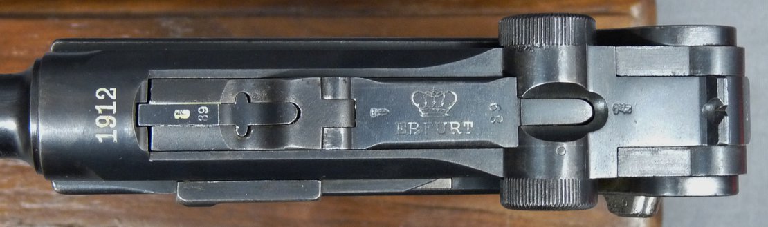

Arrow
I have a 1912 Erfurt with "12.T.S.3.208." canceled, then added "106.S.7.22" also canceled, and finally "96.R.10.6"- which is not canceled.
It also arrived here in a converted Reichsrevolver holster.
A luger that really "got around".
