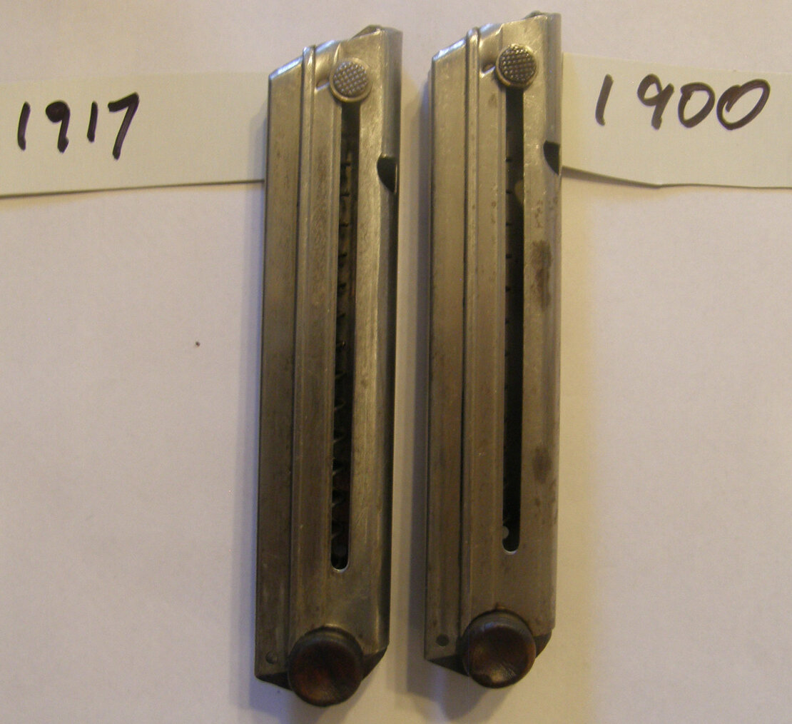

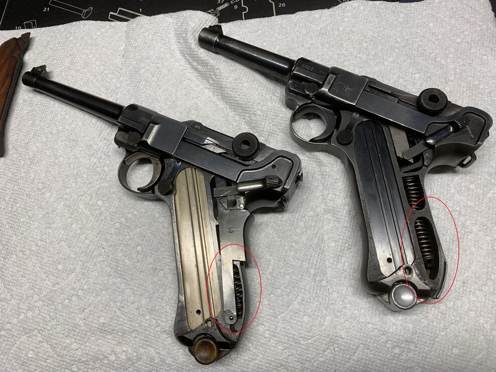

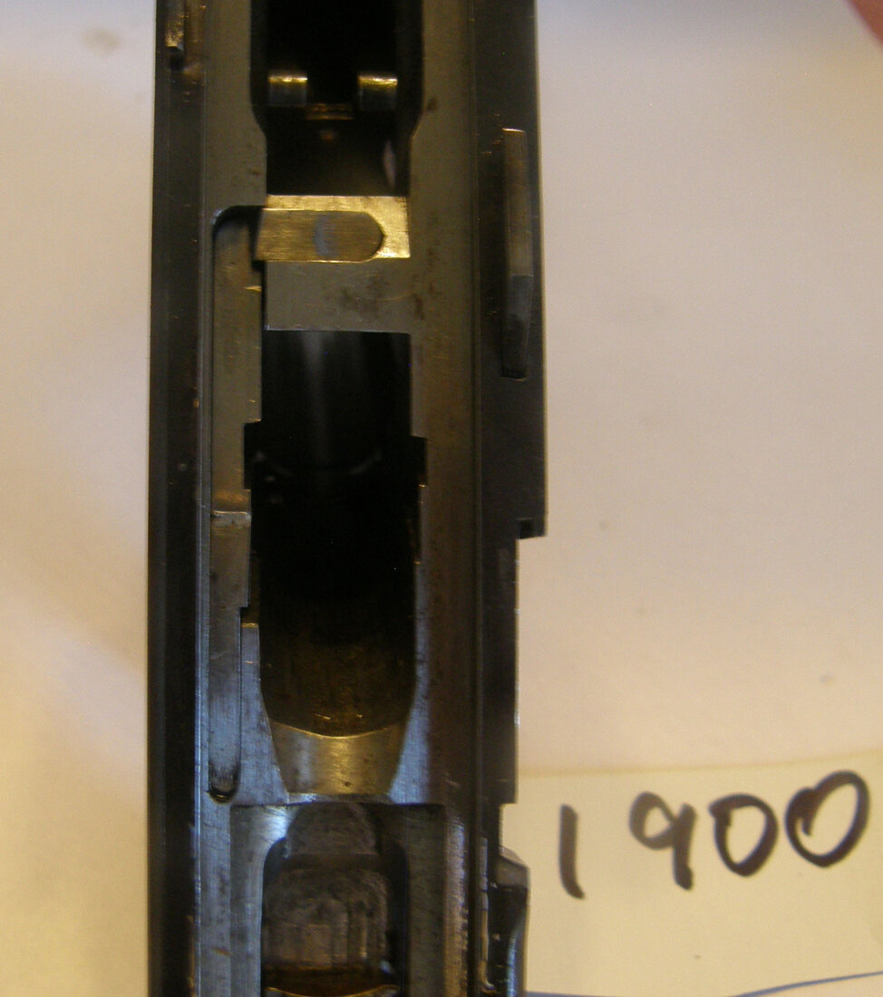

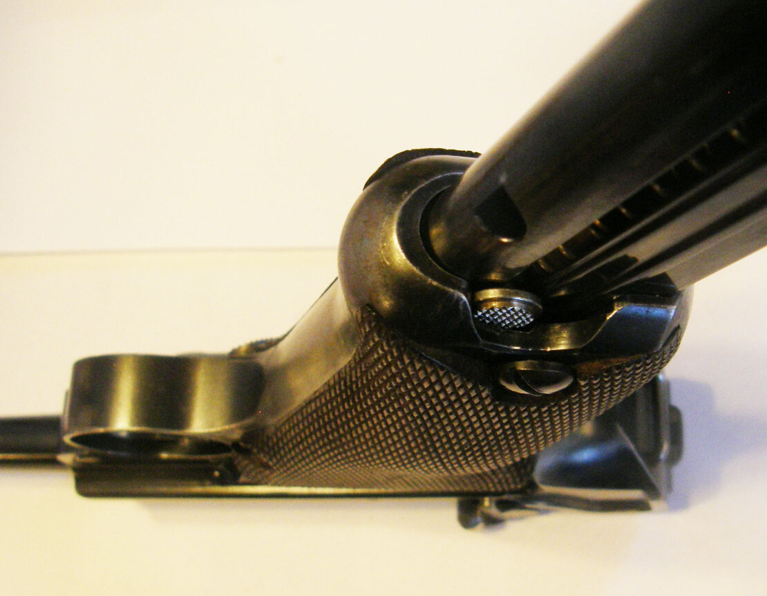

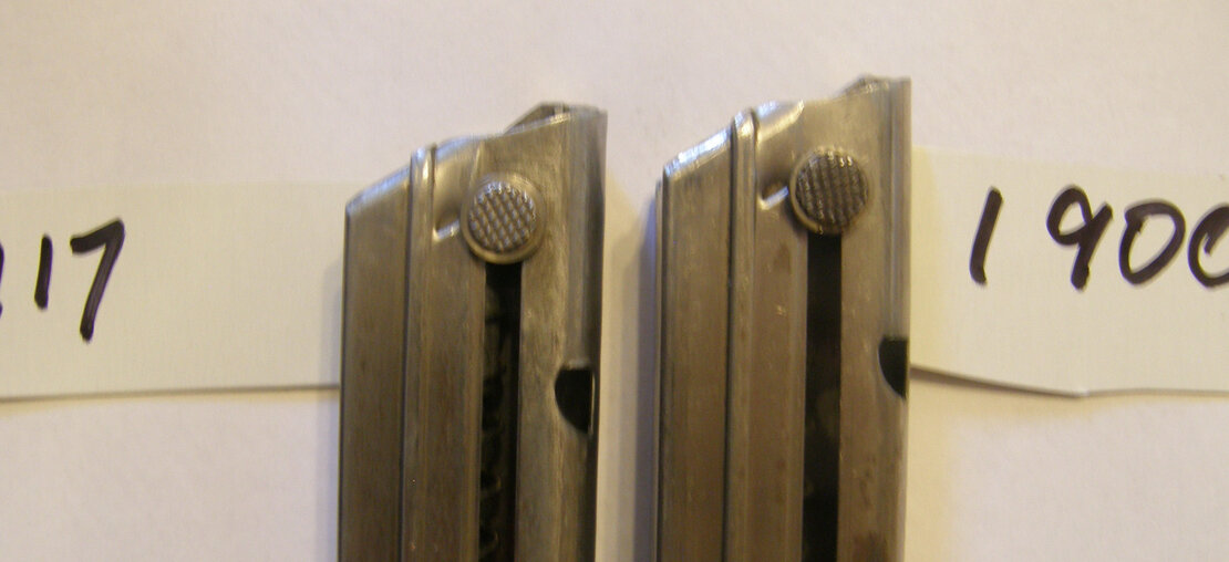

Default 1900 pics (I hope)

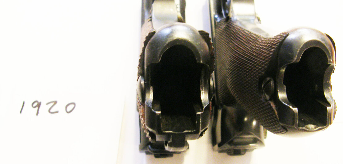

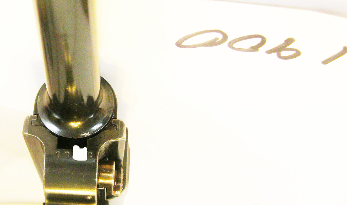

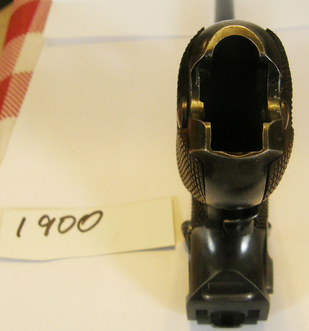

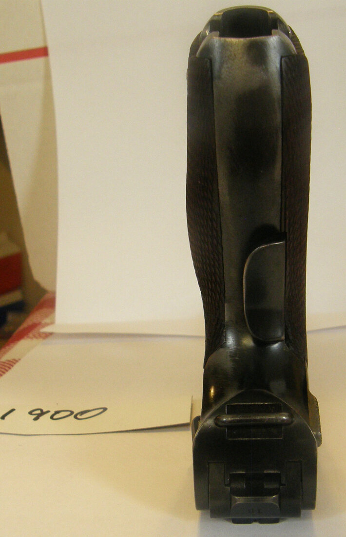

These should be pictures of my 1900. Also a 1920 Finnish 9mm.
Name:	Swiss Mag Button.jpg
Name:	1900 magwell2.jpg
Name:	1900 frame.jpg
Name:	1920 magwell.jpg
Name:	1900 seriall1.jpg
Name:	1900 palmswell.jpg

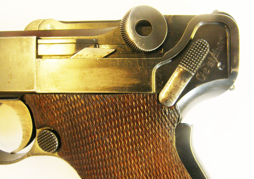

Name:	1900 saftey marking.jpg

This appears to be a very early 1900 model
The barrel is a 7.65mm (120mm ??) - is it unmarked ?
The serial number is 13x2 (no suffix).
What makes you think it's a mismatched luger ?
I think it is a 1900 Commercial.
Does it have commercial stamps (B, U, or G)?
It is called "unrelieved" luger because the magazine channel was not cut deep
in the earliest lugers. The early magazines had a very flat loading button.
Only the very early magazines will fit in it.
It seems right to me:
It's a long frame.
It has the safety in the up position to fire and no hold-open.
There is no lanyard loop and it has the wide trigger.
It has the checkered safety lever.
I think the Swiss model would have a wider grip safety (not sure).
The small parts are strawed, too.
Please provide more photos of the chamber, top, right receiver area, rear toggle and the barrel.
The inscription on the left ear is unusual - someone used an electro pencil to inscribe it with the word "Gesichert" (for secured or safe position).

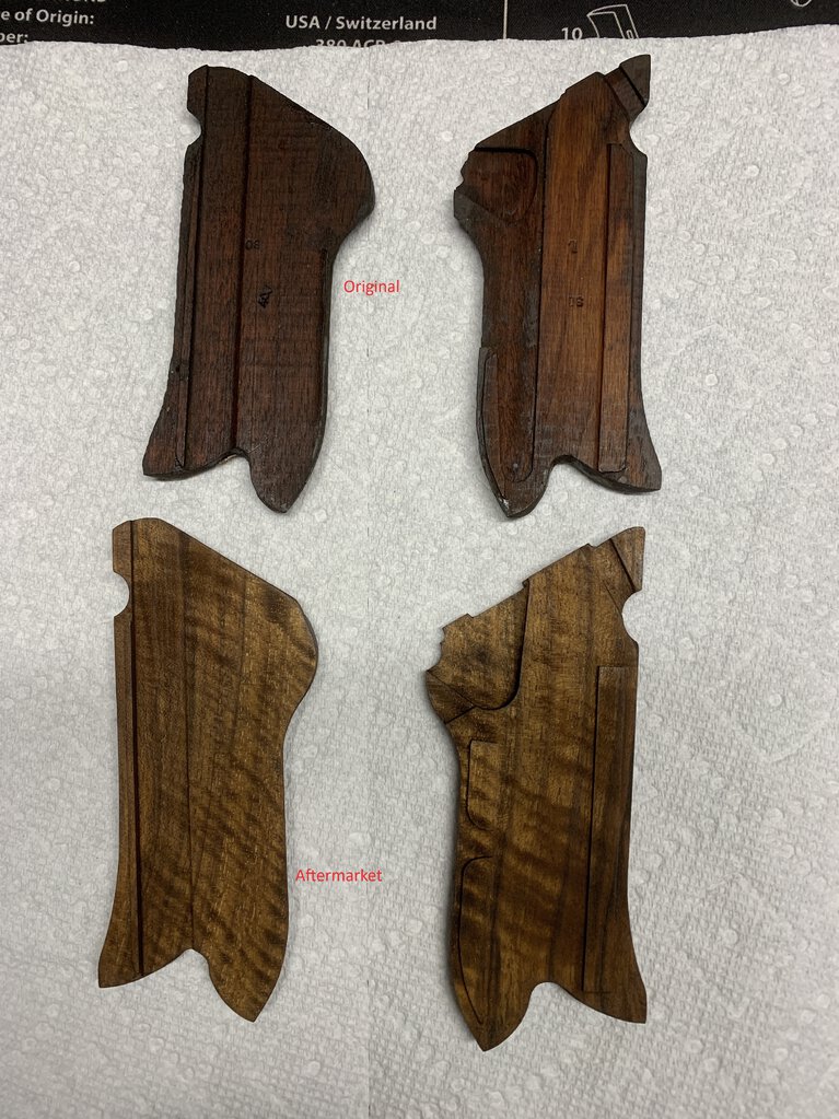

So I have an extra set of P08 aftermarket grips I would be willing to sacrifice to a 1906 grip safety conversion gone wrong.
I think I can easily manage creating a functional and reasonably aesthetic opening for the grip safety, red circle labeled "1."
I'm thinking the area within the yellow rectangle ("2") will be more challenging. In particular considering the grip must be modified to accommodate the full length of the grip safety. As I see it:
1. The entire area roughly within the yellow rectangle needs to be excavated.
2. A tab must remain to match the opening in the 1906 grip frame, roughly the area in the green rectangle ("3"):
a. If the tab is too large, the grip will not fit within the 1906
frame.
b. If the tab is too small, the grip may be loose (?).
I suspect this might not be too hard for someone who works with wood frequently. That's not the case for me, so not certain if I'm going to proceed with the project.
