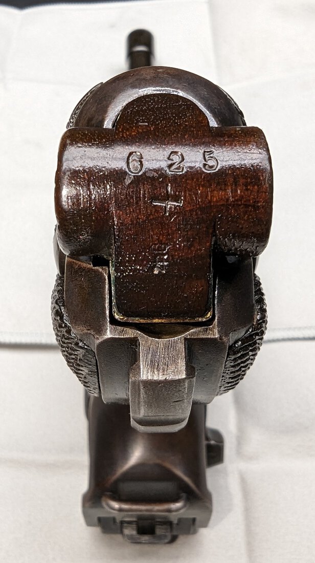

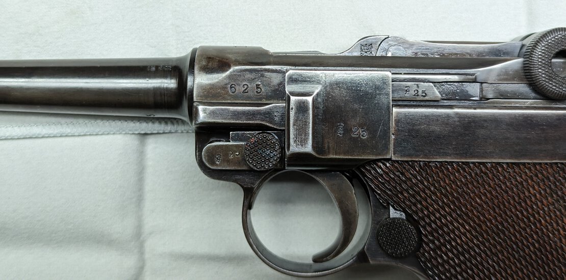

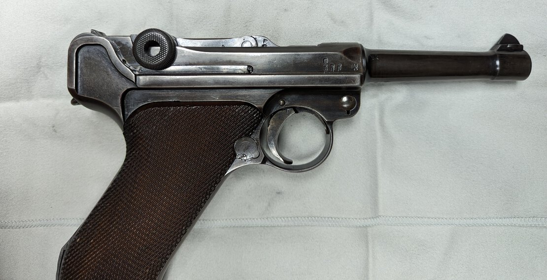

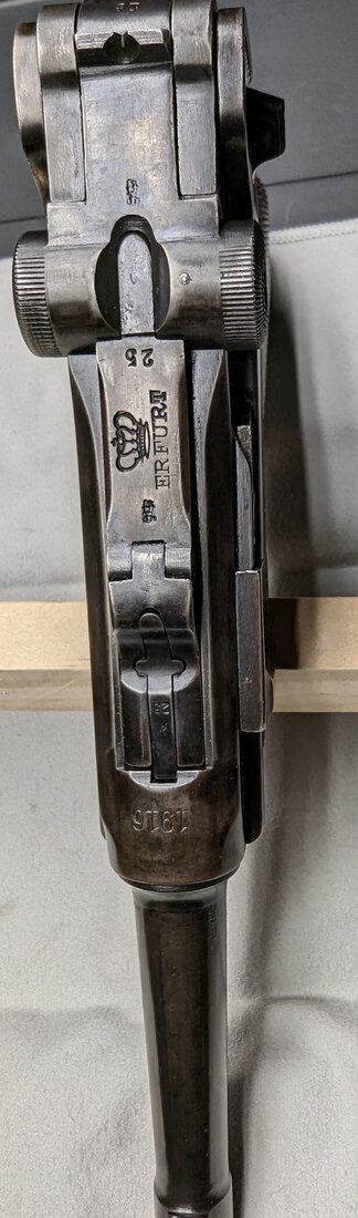

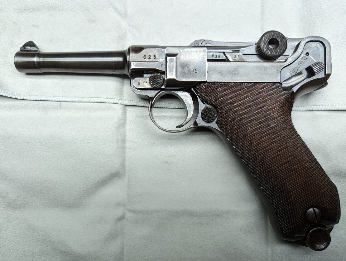

New to the forum, looking for value of my 1916 Erfurt.
All matching s/n including 1 of the mags.
It has a holster with take down tool, but it's a 1940 w/broken strap.
Thanks for your comments.

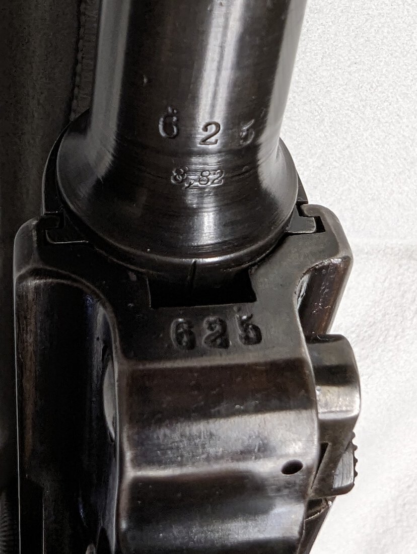

Mercurio,
Welcome to the forum. More and better photographs are needed. The present photos have a lot of glare. It is difficult to judge from the photos, however, it would appear that this Luger has been refinished, with the strawed parts, such as the trigger, safety, etc. blued (not original), and then perhaps someone attempted to remove the refinished blue? In addition, it looks like the barrel is a different color, suggesting that it is a replacement. These elements would seriously detract from the value of the gun. If you can, please provide better photos, including details of the front underside of frame and bottom of barrel, top of the receiver, close up of side plate area.

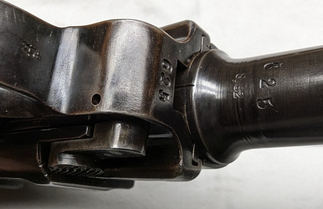

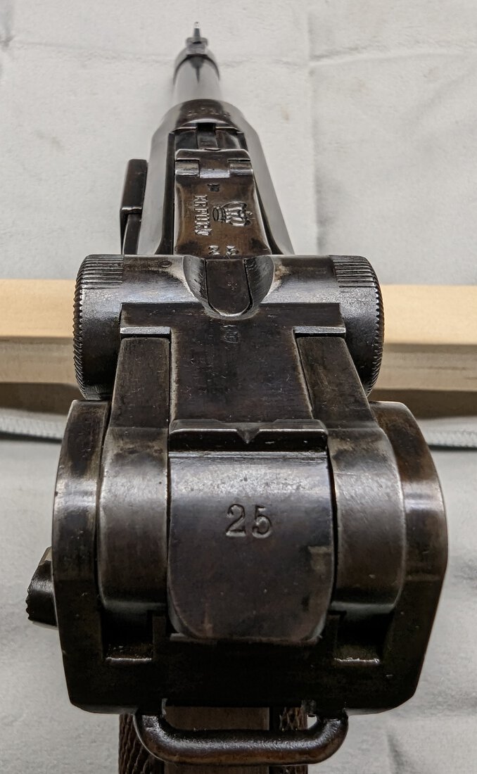

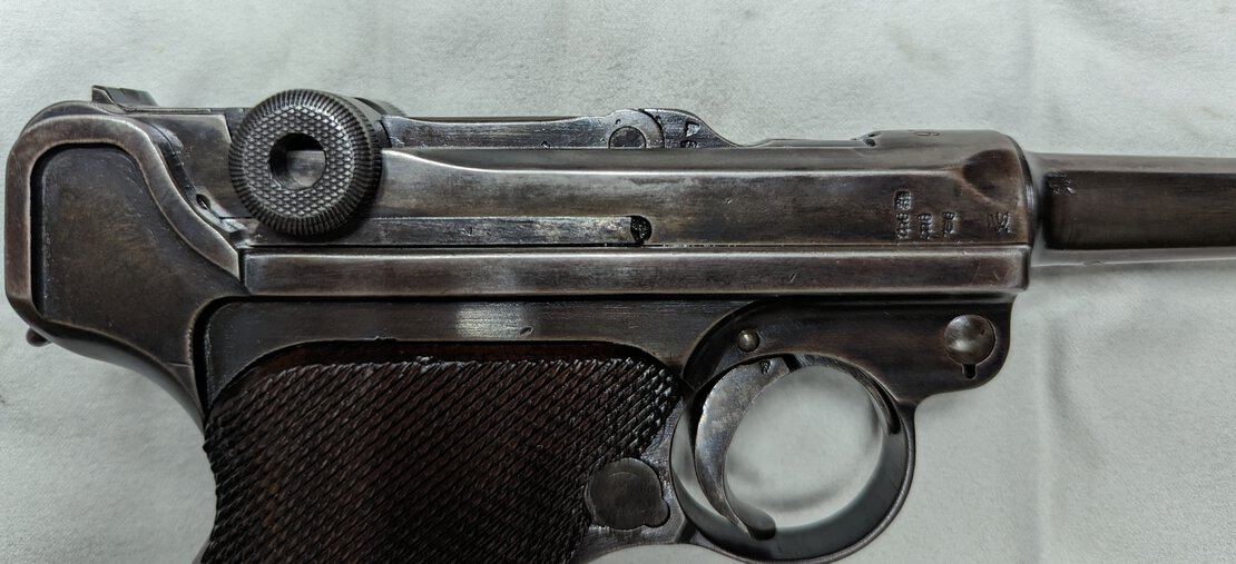

Karl
Thanks for your help. I have taken some more photos for you.

Refinished, in my opinion.
G2

I'm certain that it has been.

You did ask for pricing.
I got my 1913 on Gunbroker for $1000, it is a shooter also refinished
Yours will be worth a bit more because
1. Erfurt is rarer - but that is for collectors, not shooters
2. matching numbers, but having been refinished the provenance of the numbered parts is questionable, and of course although critical to collectors, not so much for shooters.
3. prices have risen generally since I bought
Best advice - watch Gunbroker auctions for a week or so and get a feel for the bidding

Mercurio,
The additional photos help. The barrel seems to be original. However, as others have remarked, the gun has clearly been refinished in some manner. It appears to me that it may have been dip blued over the original finish and then some of the refinish removed. In addition, the glare in the photos suggest that the whole gun, including the magazine base, may have been sprayed with clear lacquer or something similar. I positive point is that the gun does not appear to have been buffed.
I note that the take-down lever spring appears to be missing and the tip of the ejector is broken.
You asked about value: In my opinion this is not a collector-grade Luger and I would place a ballpark value, with the broken ejector and take-down lever spring replaced, at about $1000. Others may have different opinions. I would say it is potentially a nice shooter.
