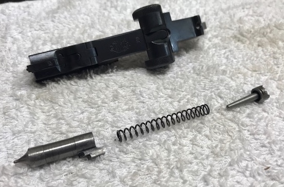

Here are some better pictures of the straw parts.

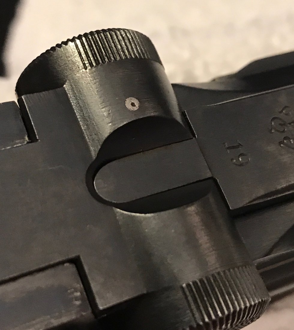

Closeup of the toggle pin.

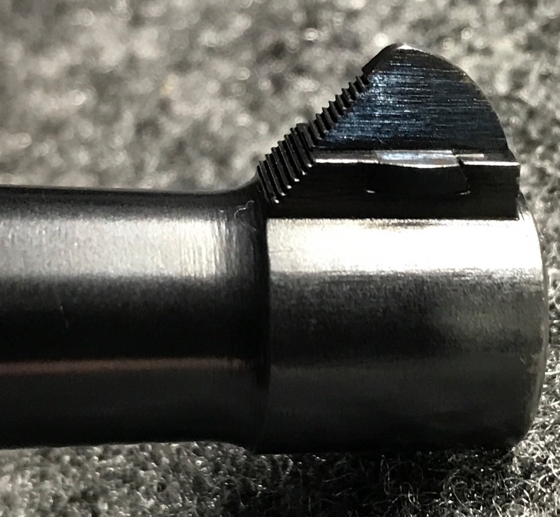

On one hand, I agree with Norme, it just looks too good to be true.
On the other hand, I see nothing wrong with it, except the toggle axle retaining pin deoes not look original - the dimple is inverted, where it should be sticking up just a hair in the center it has a hole, and there is blue or something in the hole. The pin also looks cleaned like it is new, not 100 yrs old. BUT - this pin may have been replaced as part of a repair, so it does not necessarily mean the gun was reblued. My question is why would such a clean unused gun need a repair?
My other concern about this gun would be if it really is as unused as it appears, why aren't the grip screws and front sight still bright blue? I have Imperial Lugers in less condition, that still show some fire blue on the screws and/or front sight.
I'll bet someone at Cabela's thought it was reblued. If it is original, I think a price of $2700-2800 is not out of line for this quality (98%+).

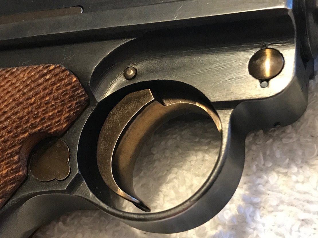

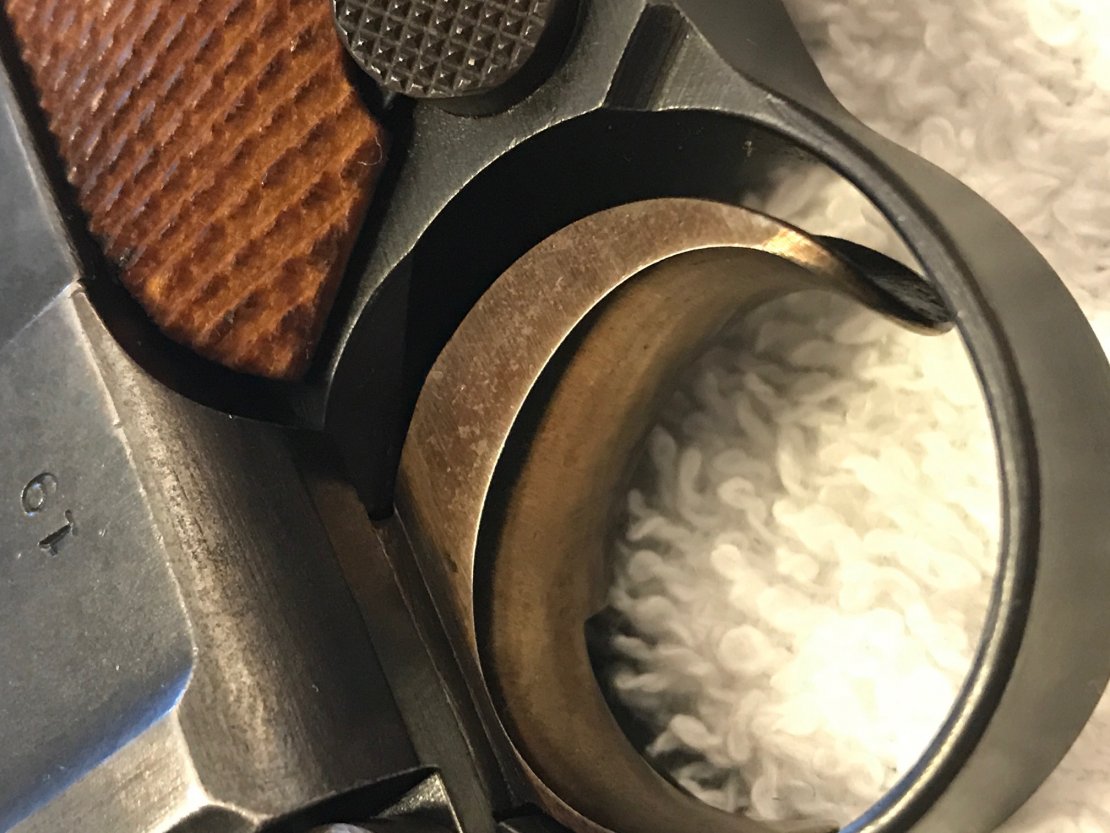

The toggle s-link and trigger transfer lever in the side plate should be in the white, so you might check those.

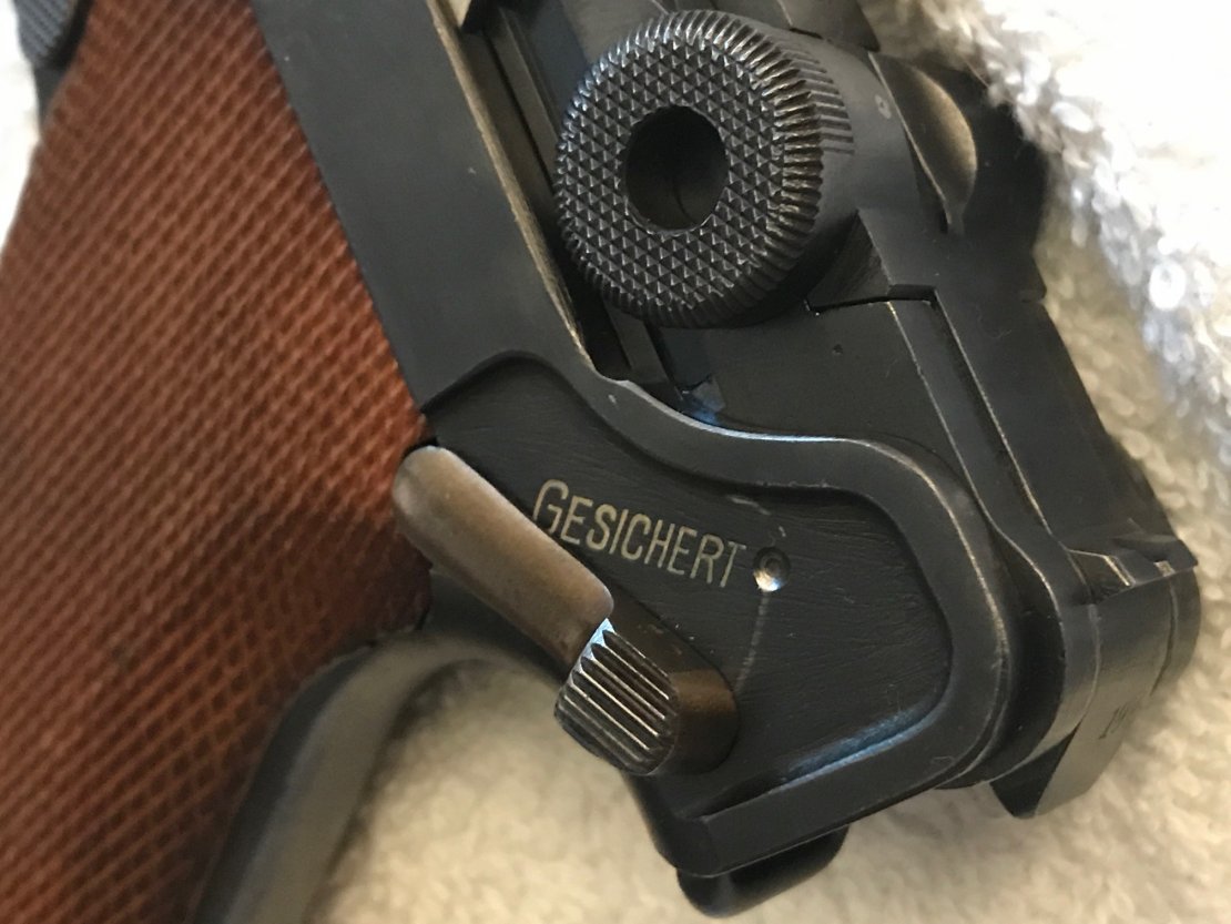

In your first post you show fine detail of the sear bar lever (safety catch). The part that rises above the frame when the safety is engaged looks white, the part down in the frame has some blotchy corrosion, suggesting the top was carefully polished. It also raises the question as to why the environmental factors that caused the blotches on the lower part of the sear bar lever did not affect any other part of the pistol.
In post #28, I see a very small dimple behind the left toggle knob, and a few others that are even smaller on the edges, that are blue. On well-done re-blues, that is what I mainly look for (blue in post-manufacture marks, typically scratches or pits). Sometimes it takes a low power stereo microscope to tell, and that might be the case with your pistol.
I also assess the retaining pin in the toggle as having been removed and replaced at some time.
Without inspecting the pistol in hand I have no firm opinion but am suspicious based on the things noted. Given the stunning appearance of the pistol you might investigate further, local jewelers typically have stereo microscopes.

The toggle-s-link, trigger transfer bar, and inside of the breech block are all in the white.
I noticed the sear bar wear that you mentioned; I attributed the whiter finish on the top to the bar riding up and down in the frame over the years and the corrosion on the bottom due to the bar being in such close proximity to the wood grips for 100 years.

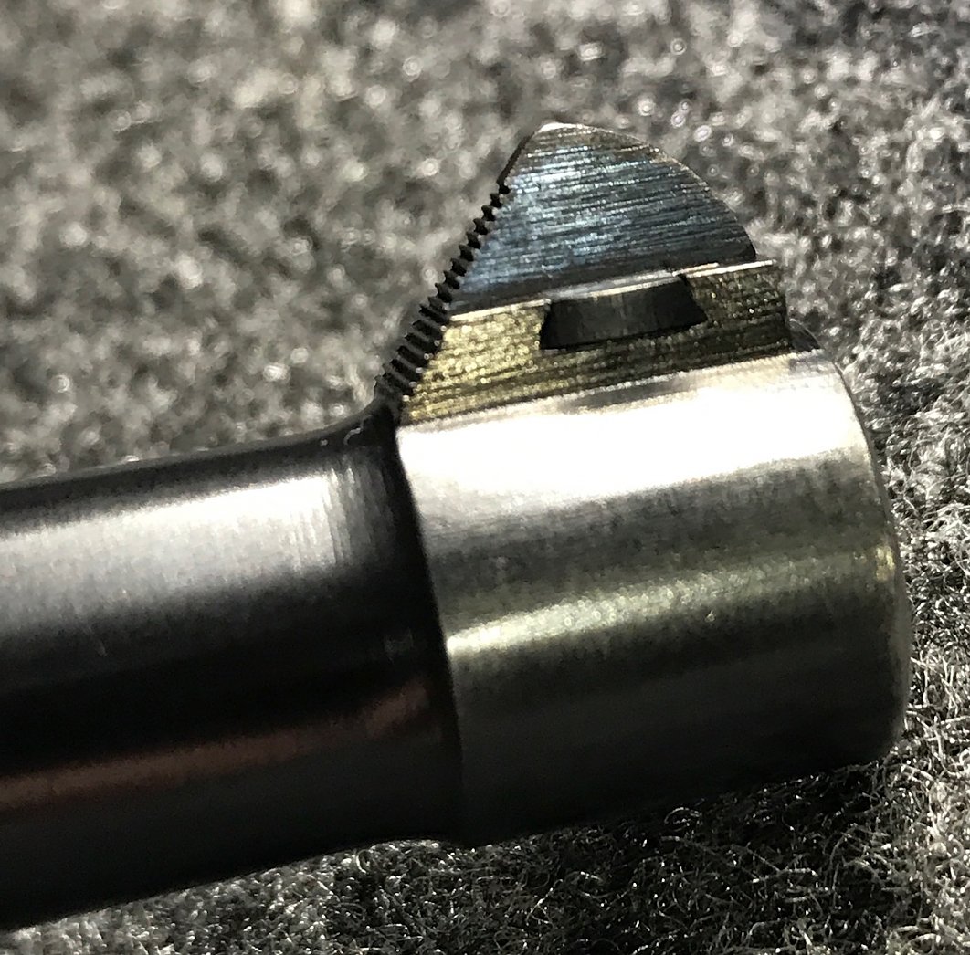

Geo99,
Just got a chance to take a closer look at the front sight and grip screws. They are fire blue. It does appear that they have a slight amount of holster wear but they are definitely fire blued.
Here are some better pictures.

Regarding the sight and screws, I would have to take some pictures of mine, but I see you already proved to yourself what I was talking about. The sight fire blue can be hard to see unless you hold it at just the right angle in bright light, and it is usually only a "ghost of blue, not like the solid blue on the sear spring or mag release spring.
After seeing the last 3 pics, I would have to agree that you got yourself an incredible bargain, from Cabela's of all places - this has to be a first! I never bother to look for guns at Cabela's but I may have to start. We have one down the street a bit from here.
Out of curiosity I removed the left grip on my two high-condition military P08s, both with original wood grips. The sear bars exhibit only light oxidation consistent with the overall finish and there is no polishing effect from the bar going up and down. But, it's only two examples.
