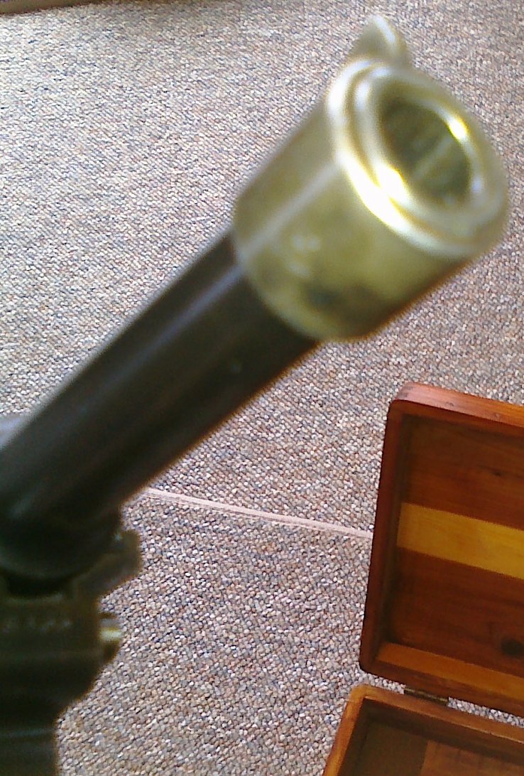

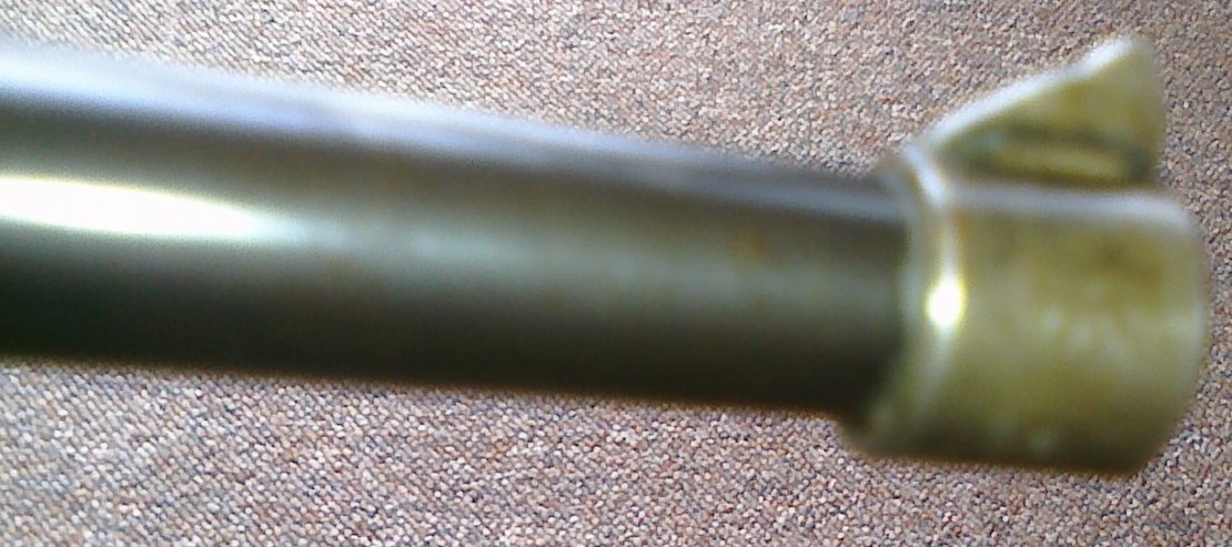

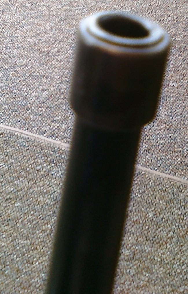

A friend of mine has a 1921 DWM all matching (including barrel) P08. We're trying to figure out why it has this unusual front sight. It appears to be an "Add on" fixed site rather than a sight machined as part of the barrel. Anyone ever seen this type of site? Is it a replacement for a shortened barrel? or ?? Thanks for any help.

Someone either turned the original barrel down, (although it does not look like much from the photo. Perhaps not at all) and replaced the original sight tower with a turning which was either silver soldered or threaded on. This was probably done to replace a damaged front sight. This repair/alteration affects your friend's pistol's value and makes it a shooter, rather than a collector piece.
What is the barrel's overall length? I ask to determine if it was cut down in any way, as the portion of original barrel showing at the muzzle does not look much smaller than the balance of the barrel's diameter. i

From the few and out-of-focus pictures it appears to be a home-brew, cut off another pistol or rifle. Sweated or just pressed on. Doesn't look high enough to be of any use in aiming.
Pics of the entire Luger, both sides & top, taken in natural light and in focus (no phone pics) would tell much more.

In any event, this is no German Arsenal's work, so any "Treaty of Versailles" theory would be just that, a theory.
This was done by a home gunsmith to replace a broken or damaged front sight tower.

I don't have one to compare it with, but it resembles an M1 Thompson front band + sight...(The military model)...

WAY too small. A Thompson front sight band would dwarf the rest of this barrel. Also;
- They were never made out of brass
- They are dovetailed for sight replacement
- The front sight blade, especially on the full autos, is so tall as to have made it useless on a Luger.

It's brass???
Unread 02-24-2013, 12:33 PM   #12
Sure looks like it to me!!

I agree with most of the above, but I would want to know if this front sight assy is sodered on or threaded. If the later, it may have been done during it's active military life, for the addition of a silencer, but likely later. I think that I'd rather own a silence ready luger, than a shooter with a terrible looking front sight assy. TH PS: most machinish or gunsmith can heat and remove this sight to solve the puzzle.

Another thought that occurred to me is battle damage. Anyone who has watched videos of guys digging up relics on European battlefields will see the horrendous effect of an artillery or mortar barrage on field equipment.
I have owned both an MP44 and a K98 with schrapnel damage. Not enough damage to render inoperable, but clear splinter damage none the less. I think many unexplainable repairs may be due to this.
