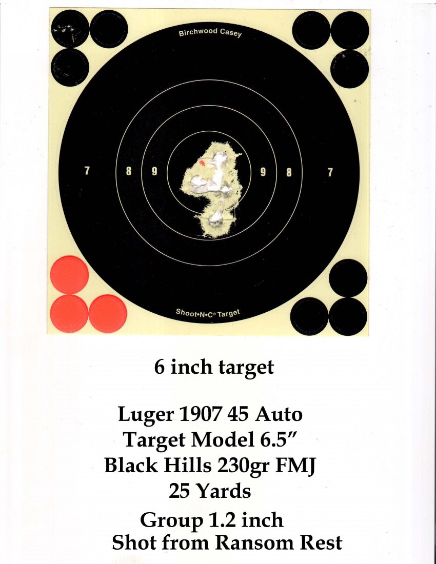

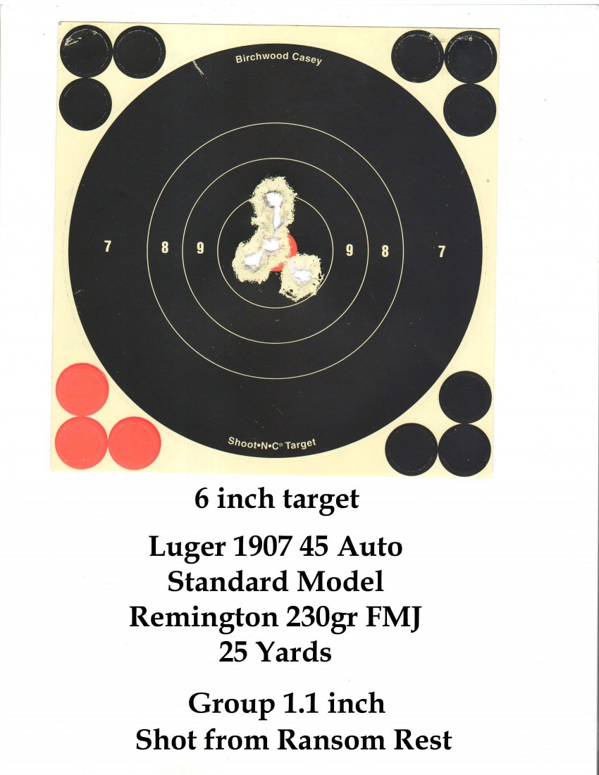

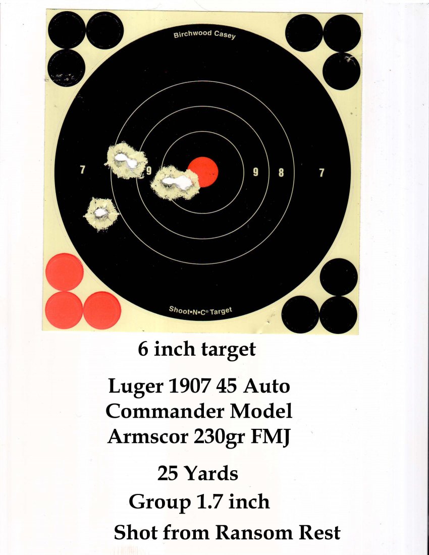

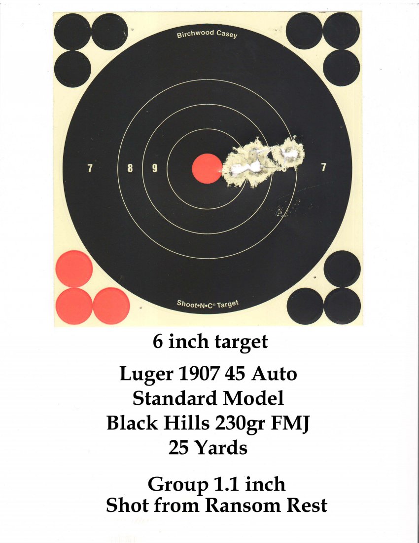

About a month ago, we have acquired a Ransom Rest and several guns were tested for accuracy.
We found that we can consistently reproduce groups of 0.9 to 1.2 inch of 5 shots at 25 yards out of most pistols we tested.

Default Targets
Targets from 5/29/18
