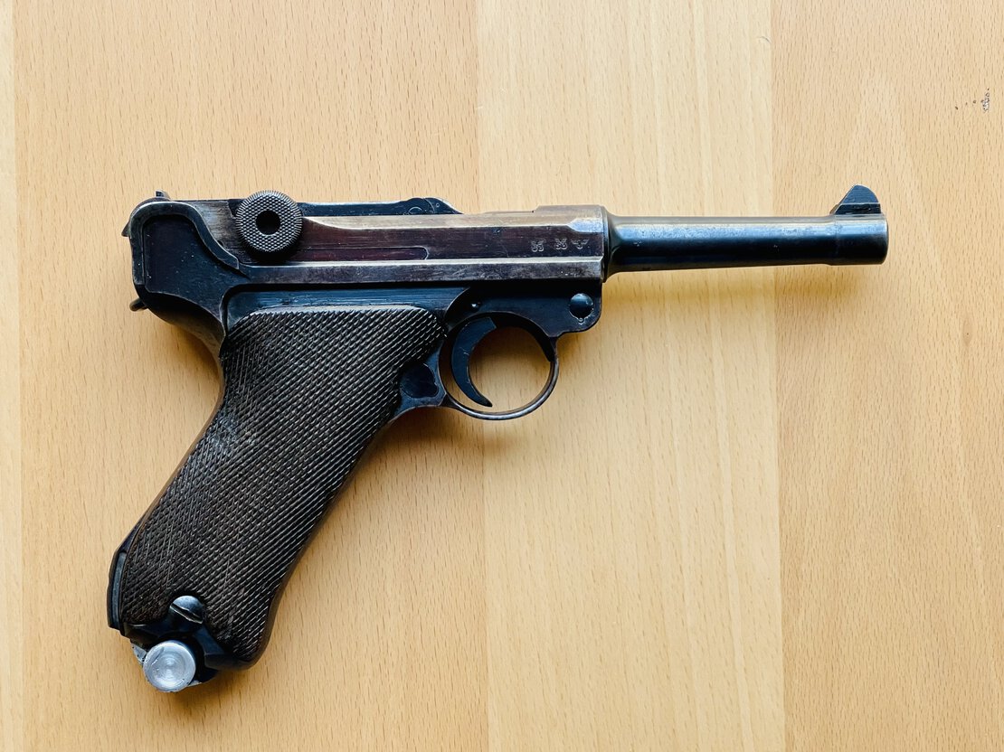

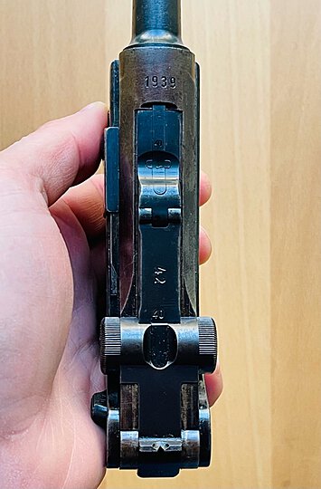

Hello from Italy and thanks to read my first message.
I bought a wonderful (at least for me) P08, 42, 1939, parabellum 9x19, in a specialized shop in Northern Italy.
I needed a bit of history and I got it: this Mauser comes from a private collection of weapons from the WWII battle of Montecassino (https://en.m.wikipedia.org/wiki/Battle_of_Monte_Cassino).
It connects me to all the stories of WWII that my grandfather (born in 1915) told me when I was a kid and to handle it and to owe it.... it’s an ‘explosion’ of emotions.

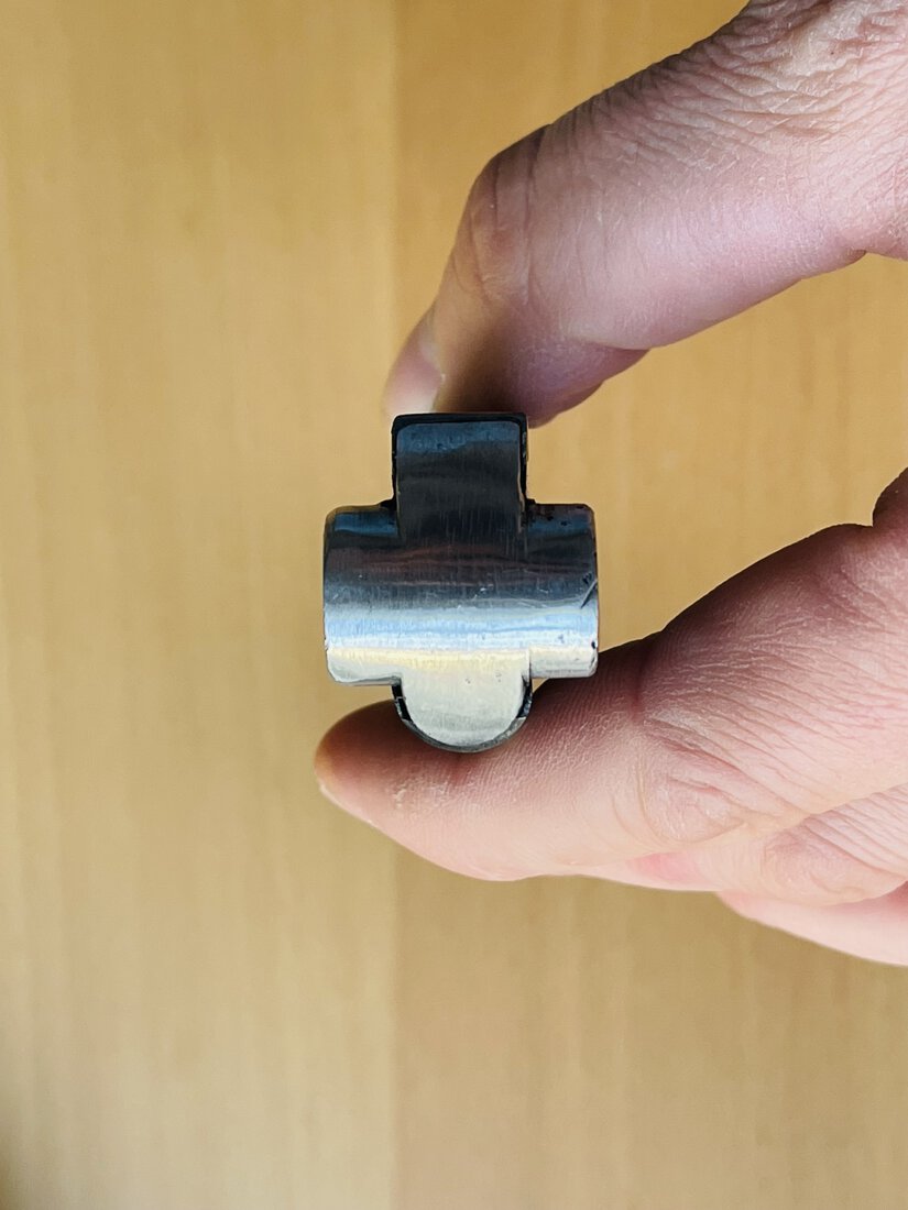

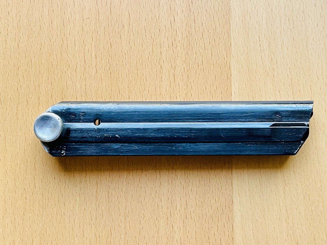

Thanks to this forum I read many post and links concerning the ‘42’ model from 1939, but I have a question on the magazine.
The seller told me that the gun was single serial number in all its part except for the magazine and so it is.
What kind of magazine is the one he gave me? Why it doesn’t have any serial number on its bottom?
sincerely, Andrev

The markings on the magazine bottom have been removed. Filed off probably.

The magazine is an FXO magazine and proper for that Mauser Luger.
It should have two small Eagle/37 stamps, "FXO" and "P.08" all on the left side.
The original magazine would have been numbered to the pistol.

Thank you, it has two small Eagle/37 stamps, "FXO" and "P.08" all on the left side.
Question: when you say that this magazine is proper for my Mauser, it means that is correct from a historical point of view, isn't it?

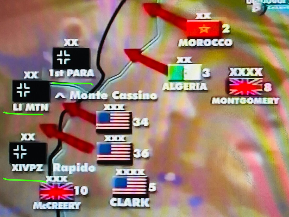

I spoke again with the professional seller who sold it to me. He told me he bought it in a batch of WWII weapons from a man in Cassino who had inherited from his father a very large collection of weapons from the war.
His father was an important commissioner for the Cassino area after WWII. Due to his role, people were bringing him weapons found in the area in the following years and so he accumulated many pistols and guns.
I do not think the seller is going to tell me who this guy was (the heir, I mean, so I could try to ask him something more), but i'm going to try.
If the story is true and if it doesn't belong to the period before the battle in cassino (1944), it could belong to one of the German divisions on the picture I attached.
But I could be wrong in my reasoning, not knowing perfectly what happened during the months of that hard and difficult battle.

You're correct. It's not the original magazine style.
The original 1939 magazine was a wrapped tin metal body and aluminum bottom numbered to the gun (E/63 or E/83 on the base) and no "P.08". Hallock says they were blue colored (The Mauser Parabellum, p.193).
These blue extruded FXO magazines actually came out in 1941 with the byf lugers.
So, I think that an unmarked FXO would have been a reasonable replacement.

Matching an original magazine to a Luger is very difficult. It is not impossible, and this forum has helped accomplish this in the past. It is very rare to actually do this.
You may find a period correct magazine which was numbered to another pistol, or an unnumbered period correct replacement magazine. These were part of armorer's replacement parts kits and were marked with a small "42" concealment code for Mauser.
