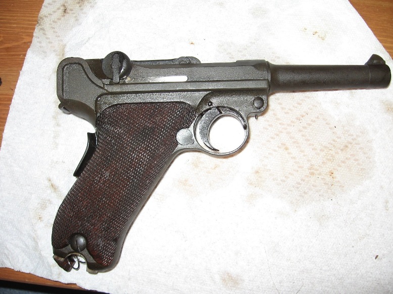

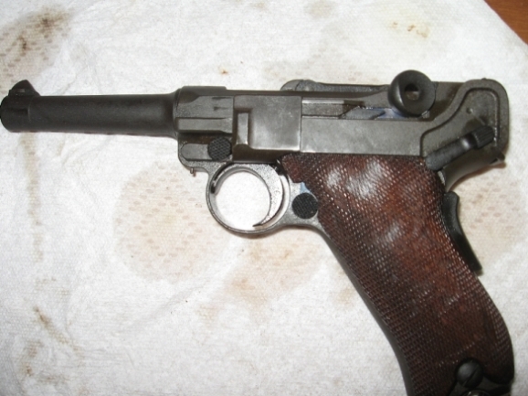

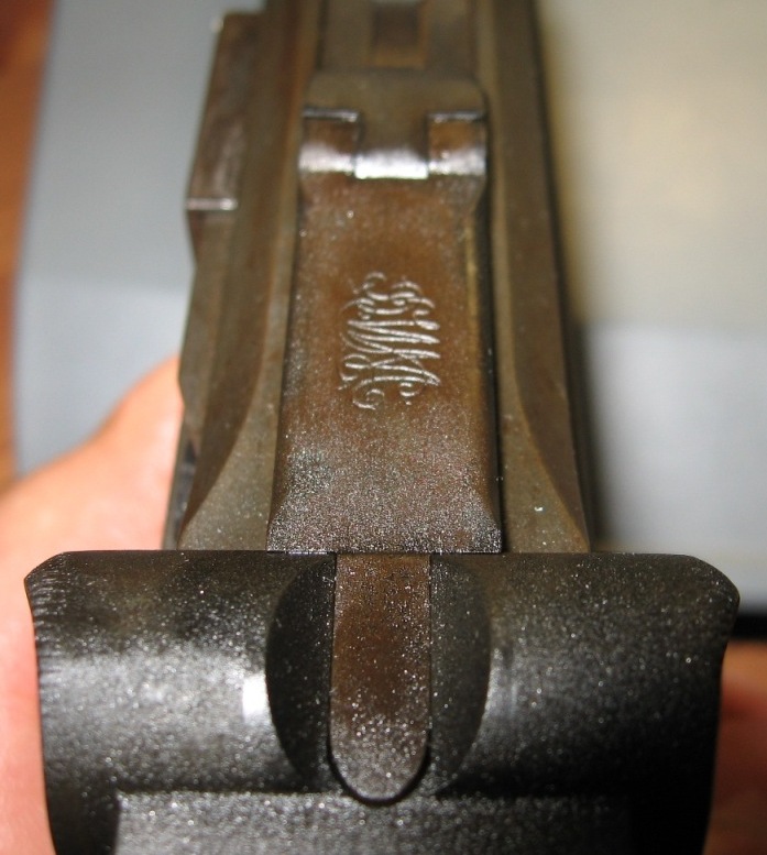

I was lucky enough to find a 1902 american eagle fat barrel luger this past weekend, One problem someone parkerized it long ago. Whoever did it did a nice job as all stamping is still nice and crisp Has anyone else seen this done before?

Here are the photos sized to fit the Lugerforum server:

Looks sand blasted as well! Someone in the past made a possible $10,000 rare 1902 AE into a $2500 "rework". Kind of reminds me of the stock market!

Wayne, I believe that the even pitting on this luger is a result of having been buried for a while rather than sand blasting. I don't know of many restorers who would tackle a restoration of one this pitted. It would require extentive welding to do it right and would be VERY expensive. If you can find a copy of the 4th edition of the "Gun Collector's Digest" you will find a photo essay showing, step by step, Gale Morgan restoring a 20shot conehammer in almost the same condition. Also noted in Kenyon's "Lugers at Radom" that the 23xxx range Fat Barrels are usually commericals not marked with the AE on the receiver. TH

Wayne, this is a difficult question to answer. 1902 AE's are rare and highly desired. It's a shame some unknowing gunsmith adulterated this piece and you're right, it is what it is. The metal would have to be buffed down to get rid of the light pitting and this would be obvious and lighten the markings. You might have to pay more for the restoration than you could get for the finished gun. I would not rush into anything. If this piece is in your possession, you might want to show it at some gun shows and ask opinions of "experts". I would also hope that some of our Forum members who do restorations could chime in with their estimations.

Kenyon's observations may be fairly correct, but AEs and Commercials are intermixed throughout 1902 production. Jan Still's estimate is probably more on target...I own #23233 which according to him would be near the end of the line.
Tom, I have that copy of 4th Edition of "Gun Collectors Digest". It was published in 1985 and is getting a bit difficult, but not impossible, to find. The restoration that Gale Morgan did on that 20-shot is next to miraculous. I don't think that restoration of this fat barrel would be nearly that difficult. The parkerization has left a rather rough looking surface, but I think it is mostly superficial and built up on the surface rather than etched down into the metal. It probably would clean up fairly well with minimal, if any, welding required. The problem is finding someone with the requisite skills to do a proper restoration. As discussed in another thread, most, if not all, of the folks qualified to do authentic restoration are no longer accepting new work. And as "drbuster" pointed out, even if you could find a qualified restorer, the cost of restoration might be difficult to recoup if it was sold. I do shudder to hear the term "buffed down"...proper restoration is mostly hand work, shunning the use of a buffing wheel as much as possible!
