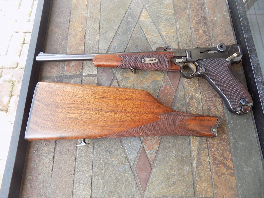

Here is the 1920 7.65mm model. #3231t! Actual carbine on cover of book!Note rear sight from original P08 stock~
